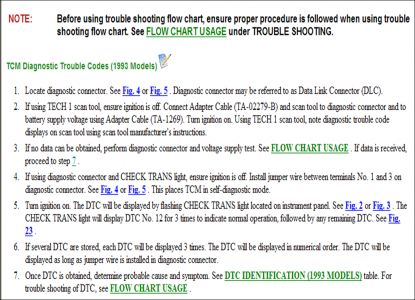

My transmission is not shifting automatically. The check trans light is flashing as well. It will shift If I shift it into low gear then up shift as I accelerate. If I don't do this it seams like it is trying to take off in 3rd gear and accelerates very slow.

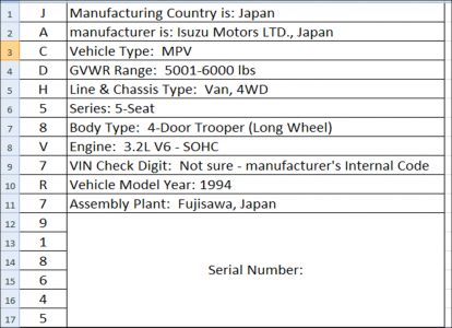

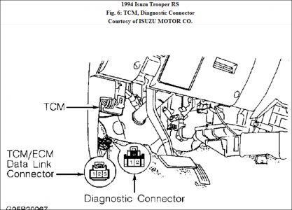

OK it is a 3.2L SOHC enginge. Not sure if it is the S or LS but the VIN is JACDH58V7R7918645. It does not have an OBD II port to check for codes. It only has a three terminal port hanging from under the dash.
When I ground the two outside terminals on the port together as it describes in the not so helpful Haynes manual, I do not get any fault codes. It just keeps flashing the # 12 system acknowledgment code. The check engine light has not lit up yet but I have a check trans warning light that keeps flashing. I'm sure this is trying to tell me what the problem is but I can't find any info on what this warning lite is for.
I did drive it on the highway today and found out that it is not shifting into O/D either.

Also, one of my tech manuals wants to know if it is a LS, RS, S, or SE. I know you were not sure, but is there an emblem on the back or side?
I was able to find some info on the VIN for you. . ..I would keep this. It did answer my door question. . .. . ..
https://www.2carpros.com/forum/automotive_pictures/248015_Picture2_10.jpg
I am going to use the RS model for now.

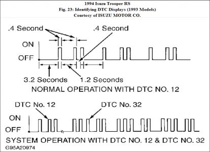

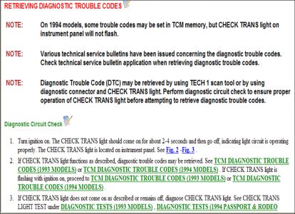

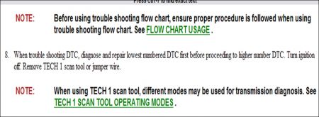

Of course, you need a TECH 1 scan tool. . .. . ..can you break in. . .. . ..sorry. . .just kidding. . ...but, this does show you can jump pins 1 and 3 and get the Check Trans Light to flash also and count the codes. I attached the info for you. Now I know you did that for the check engine light, but this says for the trans light also. As a matter of fact, the pic I am giving you shows the Diagnostic Connector as a 2 pin and the TCM/ECM as a 3 pin. That way you can hook the TECH 1 scanner up to the 2 pin and still jump the TCM. If you can not, then you need to at least have the shop do this for you, give you the codes and tell you what they are also. But get the code numbers.
This would be great if you can get the codes though.
https://www.2carpros.com/forum/automotive_pictures/248015_Picture1_11.jpg
https://www.2carpros.com/forum/automotive_pictures/248015_1_90.jpg
https://www.2carpros.com/forum/automotive_pictures/248015_2_58.jpg
https://www.2carpros.com/forum/automotive_pictures/248015_3_40.jpg
https://www.2carpros.com/forum/automotive_pictures/248015_4_24.jpg

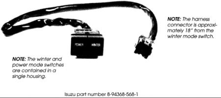

Right now, based off what you said that it is not shifting, the TCM contains a fail-safe system. When failure or problem exists in transmission electronic control system, the TCM may go into a back-up mode using pre-programmed values, allowing vehicle to be driven. The CHECK TRANS light on instrument panel will flash to inform the driver of a problem. The vehicle can be driven BUT shifting must be done manually. So, back to the codes. . .. . .. . .. . ..but at least you know why you have to manually shift.
Based on what you said about starting off in 3rd gear. . .it may be. The transmission has 3 different shift modes, Normal, Power, and Winter as I said. There is a TSB on the winter switch has failed. I have attached that for you.
Well, if you can not get the codes. . ..you cold take a chance and replace the winter switch and see if that fixes everything. Or, have the codes checked to make sure what is wrong.

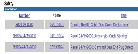

Last, it looks like you may have some recalls on your vehicle. The dealer may fix these for free. Please contact the dealer service department, give them the VIN number of your car and have them check on these to see if they apply to you.

TECHNICAL BULLETIN # 248
DATE 1994
TRANSMISSION: 4L30E
SUBJECT: Third gear starts
APPLICATION: ISUZU 4L30E
Third gear starts
This condition can be caused by a winter switch (if equipped) that has failed, closed. When the winter mode is selected by the driver, the computer commands third gear starts for better driveability on snow or ice (the unit will still shift to fourth gear at the appropriate speed).
https://www.2carpros.com/forum/automotive_pictures/248015_42157742_1.jpg
If the switch fails (closed) it can continually send a winter mode signal to the computer. For a quick test of the switch, turn the key off, disconnect the winter mode switch harness connector and drive the vehicle. If the transmission returns to normal operation replace the switch. The Isuzu part number for the switch is: 8-94368-568-1.
Recalls
https://www.2carpros.com/forum/automotive_pictures/248015_Picture4_8.jpg
https://www.2carpros.com/forum/automotive_pictures/248015_Picture3_8.jpg

No problem. But remember, I don't think you need the scanner. Try shorting 1 and 3 pin together on the 3 pin connector and see if the trans light flashes. Then that way you can just count the flashes and you won't need the scanner.
