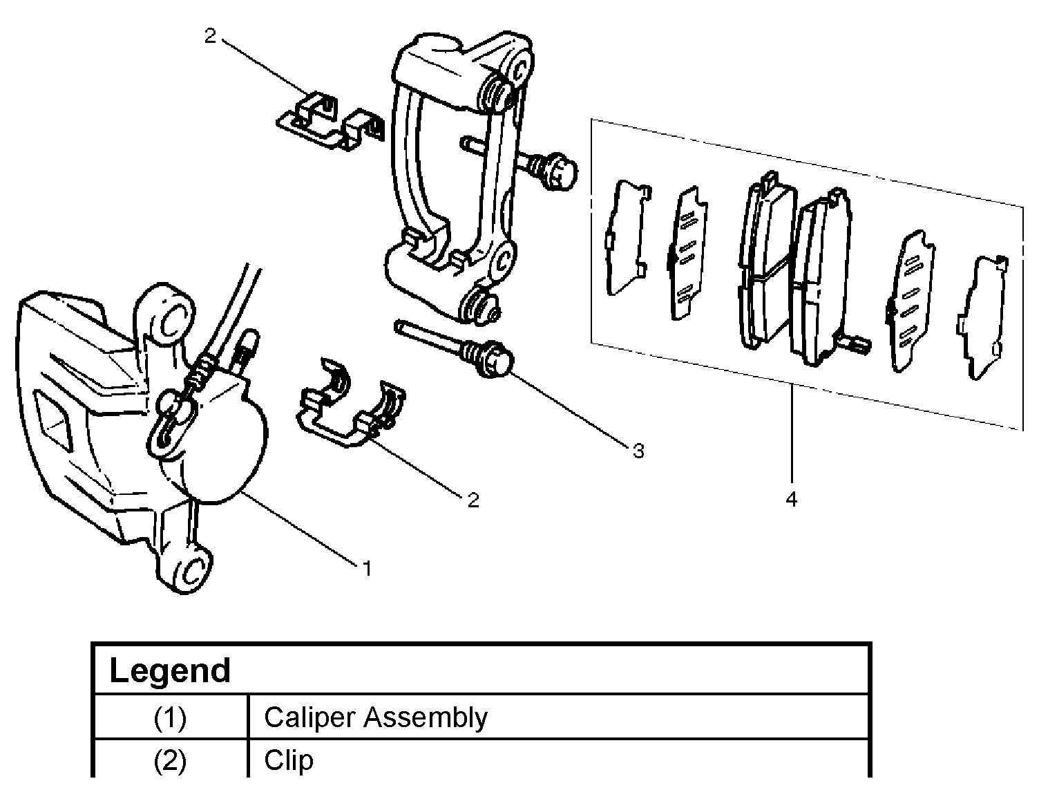

at full stop turn on 4 wheel drive -light flashes 5 to 10 times -goes into 4 wheel drive feels like the brakes need to be replaced need help pete i am 67 retired with not much money.

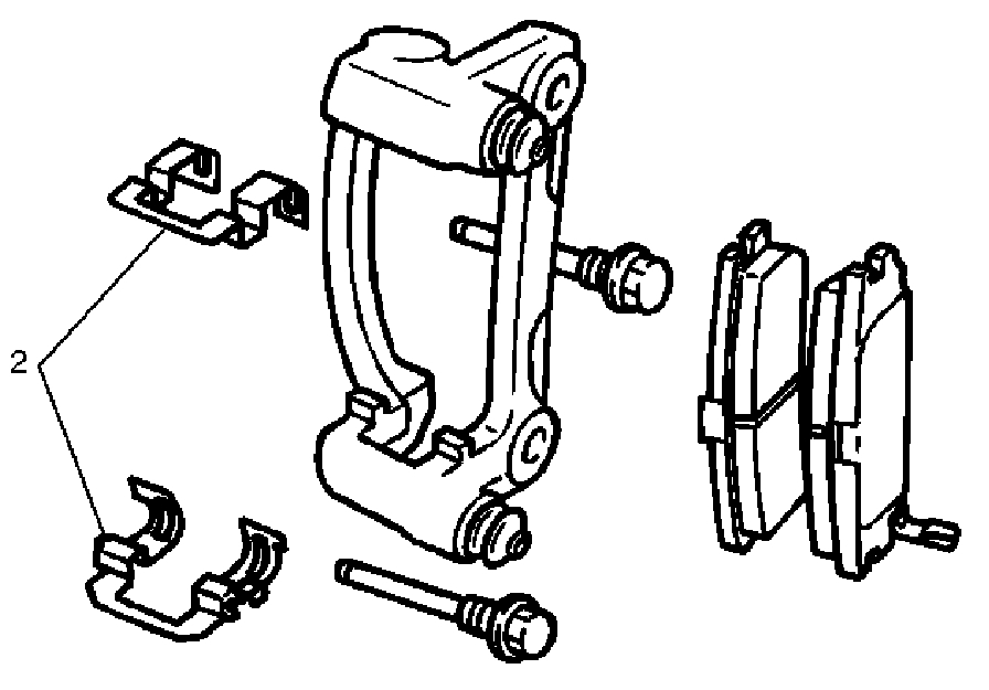

Rear brakes aren't too hard to replace. You can expect rear brakes to last approx 30K miles, but that is based on driver habits and terrain.
First, here is a link that you may find helpful. It explains how, in general, the job is done. You can use it as a guide.
https://www.2carpros.com/articles/how-to-replace-rear-brake-pads-and-rotors

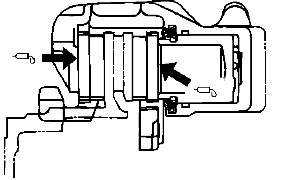

Here are the directions specific to your vehicle. The attached pics correlate with the directions.
____________________________________________________
2004 Isuzu Truck Rodeo 4WD V6-3.2L
Rear
Vehicle Brakes and Traction Control Disc Brake System Brake Pad Service and Repair Procedures Rear
REAR
pic 1
pic 2
Removal
Note: If a squealing noise occurs from the rear brake while driving, check the pad wear indicator plate. If the indicator plate contacts the rotor, the disc pad assembly should be replaced.

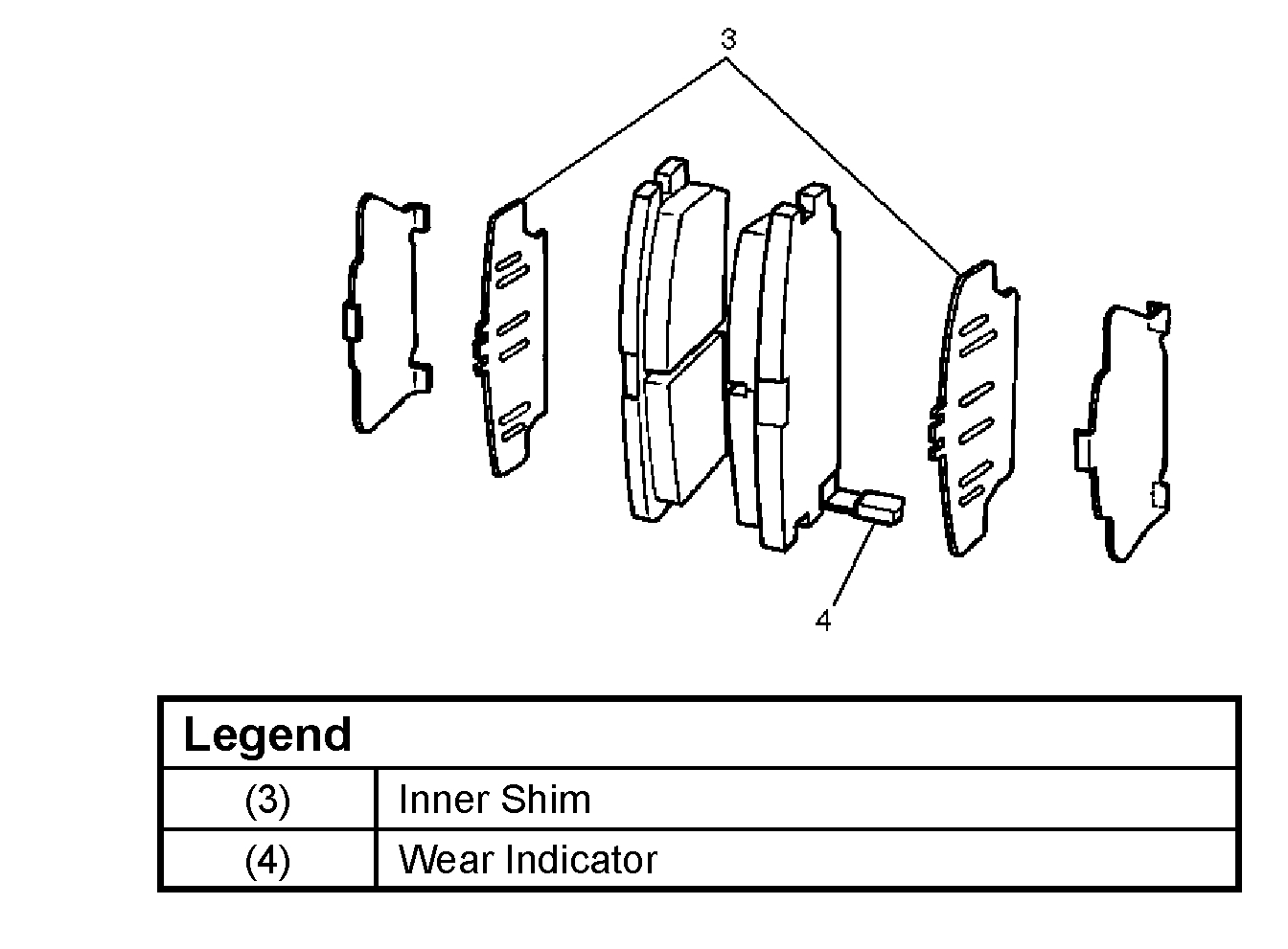

pic 3

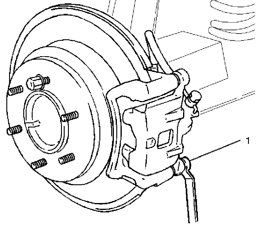

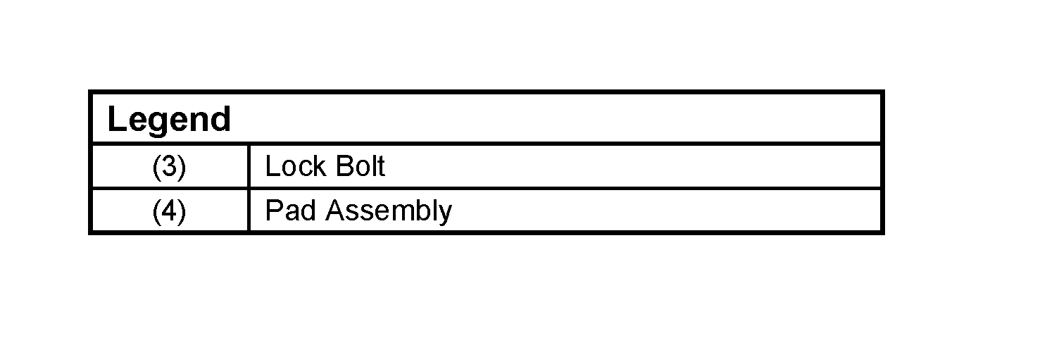

2. Remove lock bolt (1)
3. Rotate caliper assembly and support the caliper assembly so that the brake hose is not stretched or damaged.
4. Remove pad assembly with shim.
5. Remove clip.

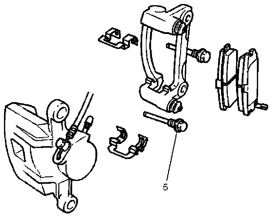

pic 4
1. Install clip (2).

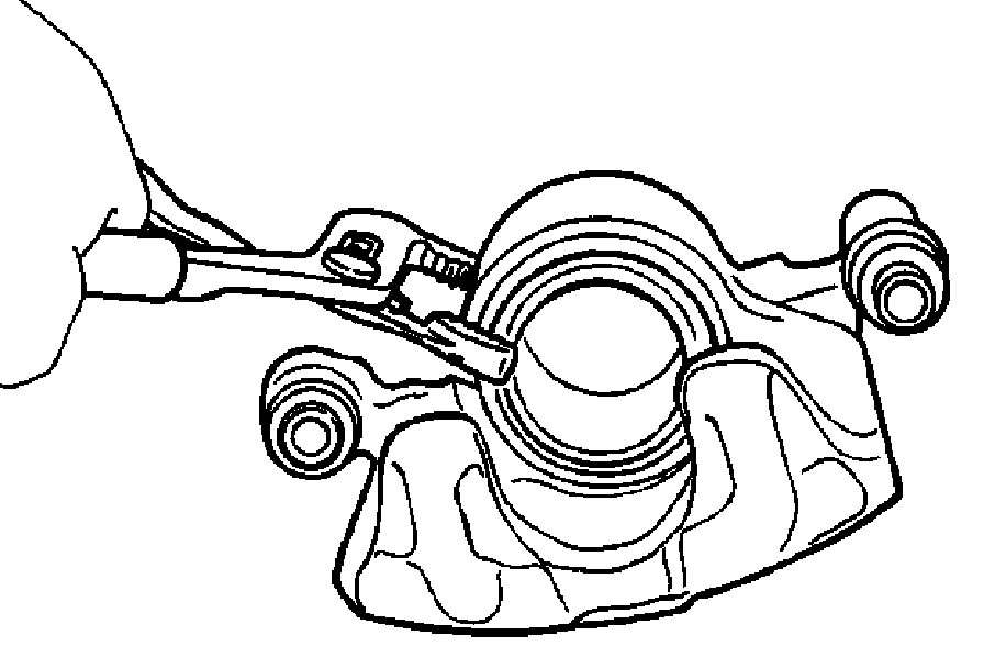

pic 6
2. Apply special grease (approximately 0.2 g) to both contacting surfaces of the inner shims. Wipe off extruded grease after installing. Install pad assembly with shim.
pic 7
3. Carefully use adjustable pliers to bottom the piston into the caliper bore. Do not pull or twist the flex hose or damage will occur.
4. Install lock bolt (5) and tighten the bolt to the specified torque.
Torque: 44 Nm (32 ft. lbs.)

When the brake caliper is removed, you will need to also remove the caliper mount shown in pic 4. Once that is removed, the brake rotor can be replaced.
