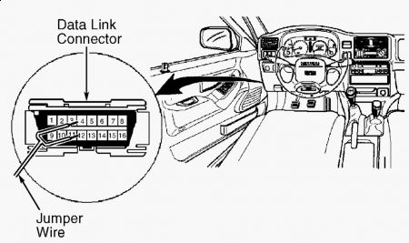

Not likly that the EGR has anything to do with it. Read the codes like this...post em and we go from there. OK" ANTI-LOCK -2001 Isuzu Rodeo LS Page 1 of 1 RETRIEVING DIAGNOSTIC TROUBLE CODES Using Scan Tool Connect scan tool to Data Link Connector (DLC). See Fig. 1 . Following scan tool manufacturer's instructions, select appropriate mode to view DTCs. If DTCs retrieved, see DIAGNOSTIC TROUBLE CODE INDEX table. Identify DTC and perform specified diagnostic procedure. See DIAGNOSTIC TESTS . After repairs, DTCs must be cleared. See CLEARING DIAGNOSTIC TROUBLE CODES . If no DTCs are retrieved, diagnose by symptom. See SYSTEM TESTS . Using ABS Warning Light 1.When ABS warning light remains illuminated, EHCU will store DTCs and disable ABS system. If DTCs are not displayed, wiring harness from EHCU to ABS warning light may be disconnected. Check and repair harness if necessary. 2.Ensure ignition is off and brake pedal is released. Using jumper wire, jumper Data Link Connector (DLC) terminals No. 4 and 12. See Fig. 1 . Turn ignition on. DTC is displayed by flashing ABS warning light. See Fig. 2 . 3.A stored DTC is displayed 3 times, each being separated by a 3.2 second pause. If multiple DTCs are set, second DTC will follow after first DTC is displayed a third time. All DTCs contain 2 digits. First digit of DTC is identified by a series of .4 second flashes. After a 1.2 second pause, second digit of DTC will follow in another series of .4 second flashes. If no DTCs have been stored, ABS warning light will repeat DTC 12 (system normal). 4.If DTCs are retrieved, see DIAGNOSTIC TROUBLE CODE INDEX table. Identify DTC and perform specified diagnostic procedure. See DIAGNOSTIC TESTS . After repairs, DTCs must be cleared. See CLEARING DIAGNOSTIC TROUBLE CODES . If no DTCs are retrieved, diagnose by symptom. See SYSTEM TESTS . Fig. 1: Identifying Data Link Connector Terminals Fig. 2: ABS Diagnosis Using ABS Warning Light

I do have a question, the clearing of the codes, it mentions to jumper terminal A to terminal H of the ALDL/DLC. Is that different than what the Pin 4 to Pin 12 for reading the codes?
I have an obd2 scanner but it won't read the ABS codes. The manufacture says the abs update will not work on my rodeo.

I have found two ways, one is sure to be right. 1. With the ignition off jumper pins 4 &12 of the DLC connector 2. Switch the ignition on & allow the ABS lamp to flash at least once before proceeding. 3. Depress the brake pedal by hand until you hear the solenoid click, then release the pedal.   Repeat   8 times within 3 seconds.   After the 8th pedal cycle the ABS lamp stops flashing, lights for 1 second, then begins flashing code 12 (no codes).   Memory is erased once code 12 flashes 4 times.   Shop key data incorrect & missing important steps to clear fault code. Please revise. Second way: Ensure ignition is off and brake pedal is not depressed. Using jumper wire, jumper DLC terminals No. 4 and 12 together, and within 3 seconds, rapidly depress and release brake pedal 6 or more times. See Fig. 1 . DTCs will not be cleared if brake pedal is not depressed within 3 seconds of jumping DLC terminals.

I finally got around to jumpering the pins. What confuses me is that all reading material says the ABS lamp will flash, but the only lamp that flashes is the AirBag lamp. The code that is returned it 12 assuming that I counted correctly.
But still the ABS lamp on the top of the dash is fully lit. The only thing I can think is that the information here is for a 2001 Rodeo, whereas I have a 1996 model.

This is what I was working on, I did not see 1996? Did I miss something? On 1996 you use the same pins and read the ABS light, NOT Air bag...same as on 2001! Check your fuse...and connectors to abs system.

I finally go the pins jumper'd correctly, I was able to get several codes out, but I believe the latest code that is repeating itself is 32, the history codes were several, but after clearing those, just 32 kept coming up.

DTC 32: PUMP MOTOR FAILURE 1. Turn ignition off. Disconnect coil integrated module harness connector. Measure voltage between ground and coil integrated module harness connector terminal No. 1 (White/Green wire). If battery voltage is present, go to next step. If battery voltage is not present, check condition of ABS fuse (60-amp) located in engine compartment fuse block. Check White/Green wire between fuse and coil integrated module for open or short to ground. Repair as necessary. After repairs, go to step 5 . 2. Ensure harness from Electronic Hydraulic Control Unit (EHCU) unit is connected to coil integrated module connector. Go to next step. 3. Check condition of harness from EHCU. If harness is okay, go to next step. If harness is not okay, repair as necessary. After repairs, go to step 5 . 4. Measure resistance between EHCU connector pins No. 1 and 2 (component side). If resistance is .2-1.0 ohm, replace coil integrated module. If resistance is not .2-1.0 ohm, replace EHCU. 5. Reconnect all components. Ensure all component are properly installed. Clear DTCs. See CLEARING DIAGNOSTIC TROUBLE CODES under SELF-DIAGNOSTIC SYSTEM. Verify system operation. See SYSTEM OPERATION CHECK under TROUBLE SHOOTING.
