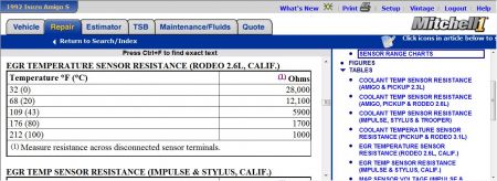

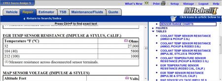

How can I bench test the EGR temp sensor?
Do I heat it with a flame or will boiling water work?
Am I looking for ohms Between the two pins or straight continuity?
Sep 7, 2010 at 8:04 PM
  • 75,992 POSTS
Hi cheetahchrome, Welcome to 2carpros and TY for the donation You measure the sensor's resistances in a given temperature-see below
https://images.2carpros.com/forum/automotive_pictures/12900_e1_3.jpg
https://images.2carpros.com/forum/automotive_pictures/12900_e2_3.jpg

I can assume these numbers are gathered by testing the sensor in hot water since the temp only goes up to 212?
Sep 8, 2010 at 10:58 AM
  • 75,992 POSTS
The resistances of the sensor drops as temperature increases between 32deg-212degs similar to a coolant temperature sensor if its not within range replace the sensor--
