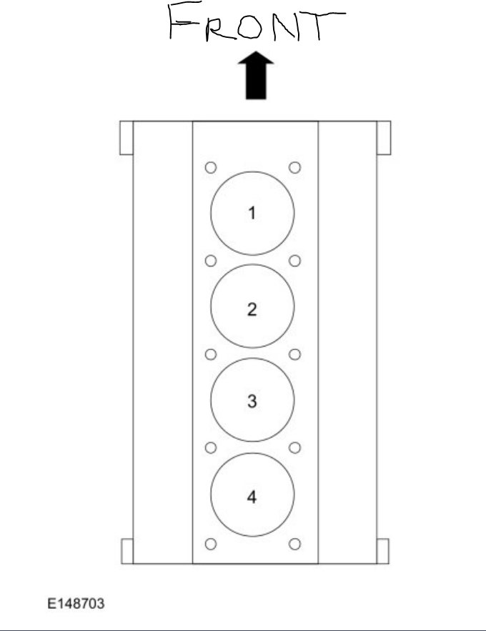

Have been having a miss in our escape while driving. It just comes and goes. Seems like while going up hill or around curves. It is usually worse when you leave it sitting over night and first start driving it. Like a cold start. It will sometimes also make a rattle sound when it does it sometimes but not all the time. We changed the spark plugs didn’t help. No lights no codes. The power train warranty won’t fix it until a code or light comes on. I was told to ride it until it throws a code or light. I am afraid I will tear something else up. We can not figure it out though. Any help would be appreciated. Thanks Kristy

Okay, so the first thing we need to do is figure out which cylinder has the miss. Your vehicle likes to miss when it's cold, and right now for us that's a good thing. To figure out which cylinder is missing, it will have to be missing at the time we run these tests. So, first thing in the morning, you and a helper need to go and start your vehicle. Confirm that the miss is present. Next you will need to go around a one at a time, with the vehicle idling, unplug a fuel injector connector and listen to what the engine does when you do this. If the engine bogs down then this is not the problem cylinder. Plug the fuel injector connector back in and move to the next cylinder. Repeat this until you unplug the fuel injector connector and there is no change in the engine. This is the cylinder with the miss. Here is a link for you to go to explaining how to fix misfires below:

A misfire sometimes will cause your vehicle's Malfunction Indicator Lamp (MIL) or "check engine" light to illuminate, and sometimes it won't. If it was illuminated for a misfire it would have the Direct Trouble Code(s) P0300(Random Misfire)or any combination of P0301 - P0304 (Misfire with the last number being the cylinder with the misfire)(P0301 Misfire in cylinder 1)(P0302 Misfire in cylinder 2) and so on. But a misfire might not turn on the MIL or "check engine" lamp. The key here is not whether the MIL or "check engine" lamp is illuminated or not but to find the cylinder or piston that is misfiring. We will do this just like I described above. Then we can figure out why your engine is misfiring, which is relatively simple and get it fixed. Please get back to us with what cylinder(s) or pistons are misfiring and we can go from there. I have also included a layout of your vehicle's cylinders, or pistons, so you have a reference to tell us which cylinders, or pistons are misfiring.
