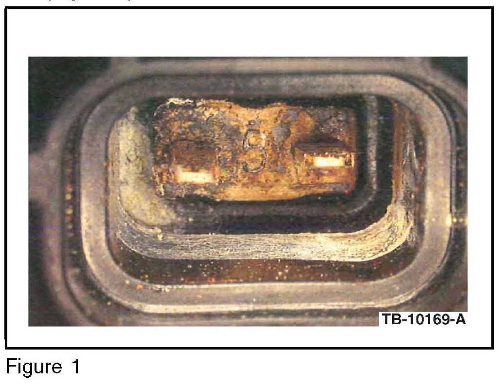

Did this last summer and it was due to air pocket resulting in having to let steam out of the bleeder valve and eventually quit overheating. About a week and a half ago this time i noticed when driving there was like a lag when accelerating and just doesn't have much get up and go. So few days later I get a mile down the road temperature gauge goes all the way up directly on the H and it seemed as if it were backfiring like it was going to shut off so I pulled over. After doing some research the signs all pointed to the CHT sensor is bad. The connector had some kind of goop build up on it and tiny wire cut. Without testing is there any way to determine if it's the connector or the sensor itself?

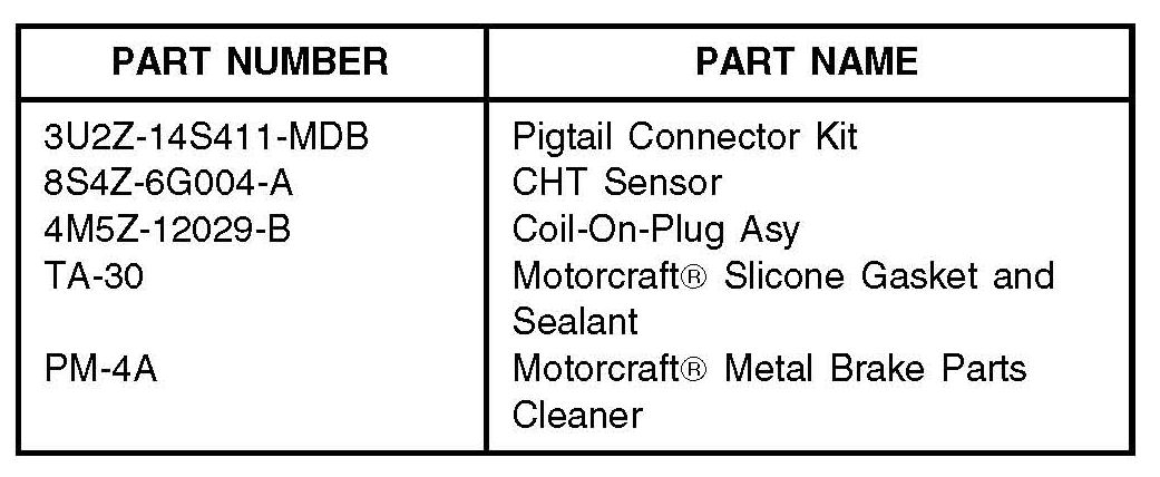

Ford has a technical service bulleting for this issue and you'll need to replace the sensor and the connector. Here is the official repair, and I've attached the part numbers and a view of a failed sensor.

Engine temperature concerns may be due to corrosion at connector C1164.
1.Inspect the cam cover trough, making sure it is clear of debris like leaves, wasps, dirt and the drain hole by cylinder 4 is open.
2.Inspect connector C1164 at CHT sensor for evidence of water contamination.
a. If evidence of water contamination is present, proceed to Step 3.
b. If water contamination is not evident, do not continue with this procedure. Refer to Powertrain Controls/Emissions Diagnosis (PC/ED) Manual, pinpoint test DL1 for normal diagnostics.
3.If corrosion from water contamination is severe and terminals are rusted and disintegrated: (Figure 1)
a. Cut off connector C1164 and install a new pigtail connector. Refer to instruction sheet.
b. Replace the CHT sensor. Refer to Workshop Manual (WSM), Section 303-14. Proceed to Step 4.
4.If corrosion is not severe, remove any water and thoroughly clean connector C1164 and the CHT sensor.
5.Before reattaching the CHT sensor cover to the cam cover, clean the cam cover and CHT sensor cover with Motorcraft Metal Brake Parts Cleaner.
6.Attach the CHI sensor cover to the cam cover and add Motorcraft(R) Silicone Gasket and Sealant around the CHI sensor cover, to seal and prevent water entry.
