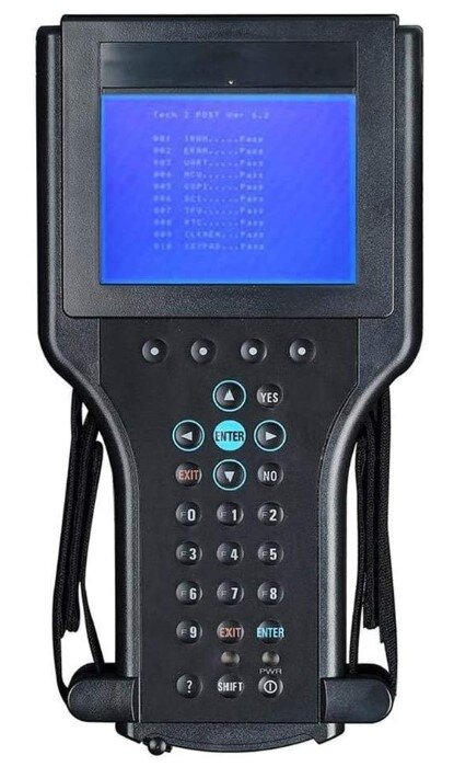

Wondering if you could recommend any tech 2 scan tool alternatives?
I have a new Body control module as well as a supposedly programmed to vin body control module. I thought I could do this myself because I own a tech 2 but it's toast it won't even turn on. For as much as i paid for it and the little I actually used it I don't see the point in buying another.
I know obviously the new BCM needs to be flashed but even the plug and play one doesn't work. I've seen other reviews where they just plugged it in and had no issues car started yadda, yadda. But mine won't and I'm guessing it's the security feature. I think this because I'm unable to successfully complete the relearn procedure and I've tried the many different described ways online from 10 min to 15x3 11, and so on. The security light doesn't turn off. It flashes a few times then stays solid, never shutting off. I was told to time it exactly and even if it doesn't turn off continue procedure but still nothing.
I've contacted a couple of local shops, but they all say similar things regarding being to do diagnostics first at $200 + and how I can't use my own parts so I would have to pay for a whole new module and programming. It's ridiculous.
If my tech 2 would turn on I could set up the BCM and keys etc.
With either of the 2 new BCMs my car has no crank no start. I have power lights coming on etc. And i also noticed there is no longer the option to sync keys or fob through radio settings. When i plug my old faulty BCM back in it starts right up but of course the lights are cutting on and off and my dash is full of warning lights. But it drives at least.
I just need a cheaper alternative to getting this BCM setup and it seems like all options are dang near more than my car is probably worth.
I've been looking online, and lots claim to be bi-directional or have pass through but i don't see any that specify what I'm looking for. I looked into rental on a tech 2 and again mine as well just buy one.
Totally regretting trying to do this on my own. I can't believe my tech 2 won't even turn on. Any options you would recommend??

I can't recommend one unfortunately that I can think of. I paid $3,500.00 for my scan tool from Snap-On. I was able to find a Tech 2 on Amazon for $80.00. I have added the link below.
https://www.amazon.com/Diagnostic-Scanner-Vehicle-Diagnosis-Multilingual/dp/B07ZTG8RC6/ref=sr_1_5?keywords=tech+2+scan+tool&qid=1676042038&sr=8-5
I am not sure if it is the right one you are looking for but check it out, maybe it will help.
It says Tech 2 but I'm not sure if it's the exact same one you have or at least close to it enough to get you up and running.
Let me know how it goes. In the meantime, I will look around for you and see what I can come up with.
I don't know or am I affiliated with the seller. So, make sure to read the description and return policy carefully.

JPM93, I have a few comments of value to share. First, given the other problems, try your scanner on a different vehicle first. We read quite often about the 12 volt supply terminal being dead in the diagnostic connector, then the scanner never turns on or communicates.
If you do need a new Tech2, as Brendon eluded to, there used to be a bunch of them listed on eBay as "new", for $300.00. I suspect those were excess inventory from the scanner manufacturer. That's how I got my Chrysler DRB3.
