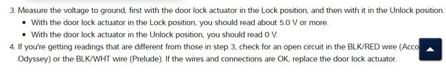

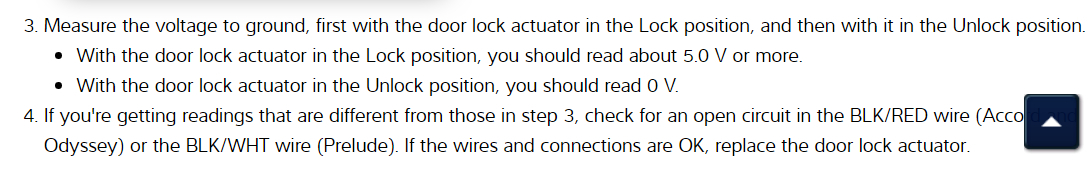

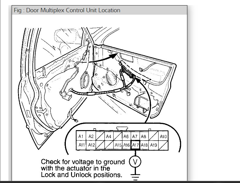

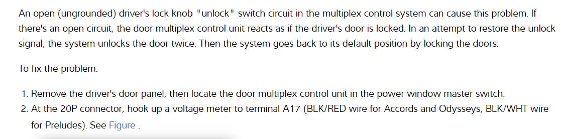

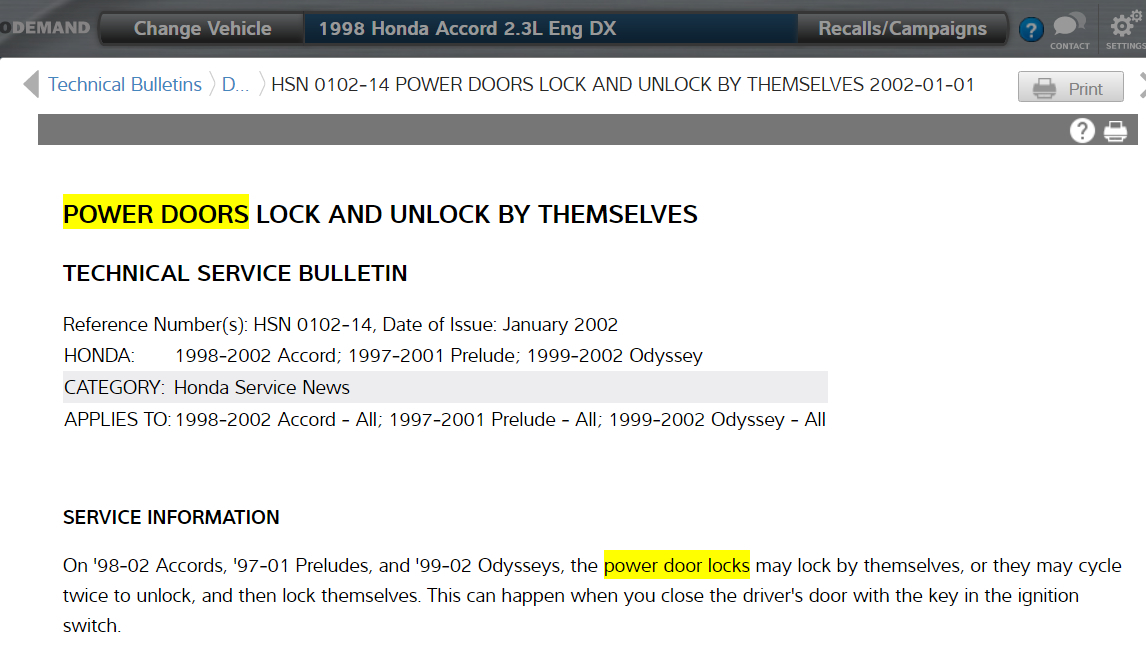

I saw on another person's issue you mentioned it could be a fuse. The dash has some lights out as well, such as the gear shift plate, and the clock. Also the dash panel is missing a light on the gas gauge area. Help! I'm poor and original owner of the car.
Sep 11, 2019 at 9:58 AM
SCGRANTURISMO
  • 4,897 POSTS

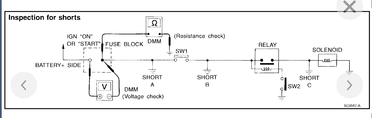

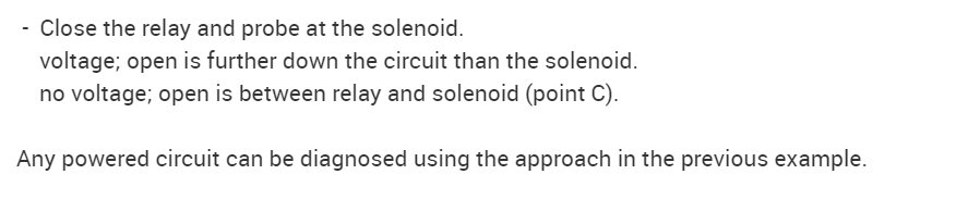

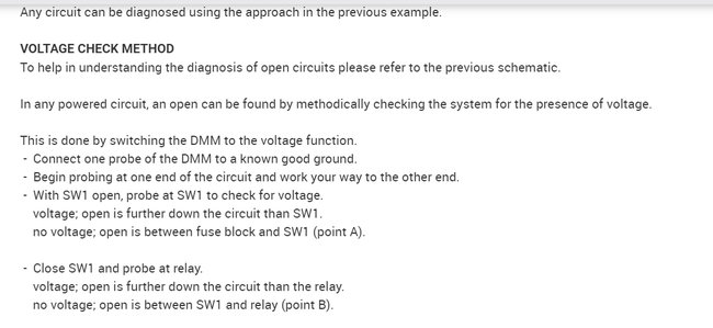

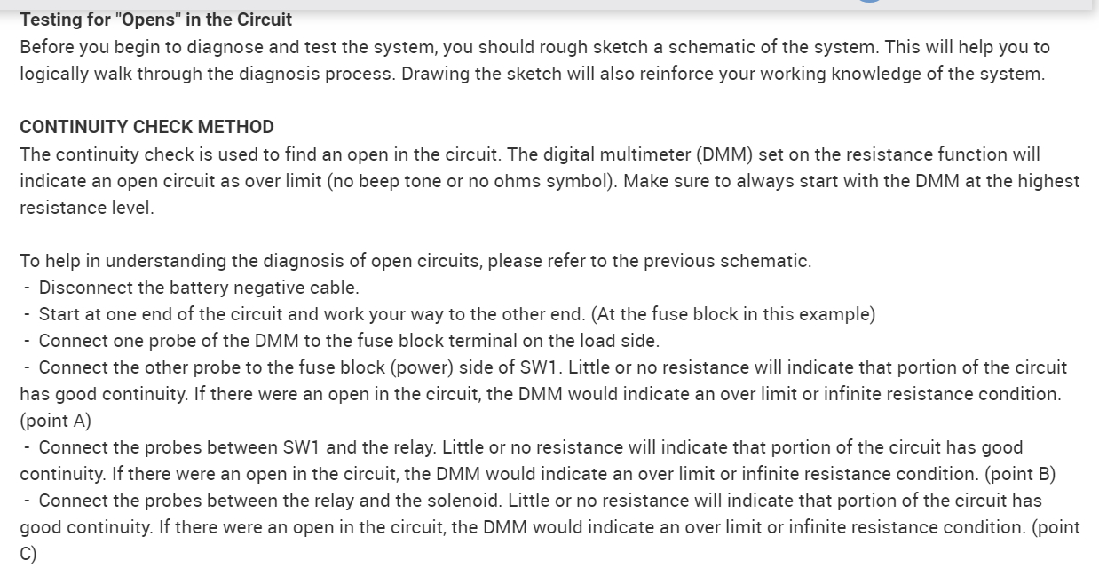

This is probably a ground problem with your vehicle's multiplex control system wiring and the repairs to correct this problem should be little to none. Fuses just protect an electrical circuit from a short to ground, popping when one occurs opening the circuit and stopping runaway amperage from causing an electrical fire. In the diagrams down below I have included a factory Technical Service Bulletin(TSB) that provide give you instructions on how to fix this problem. I have also included a guide for you on how to find an open in an automotive electrical system. You will need to use a Digital Multi-meter (DMM), so here is a link to a guide describing how to use one, if needed:
Please go through these guides and get back to us with how everything turns out.
