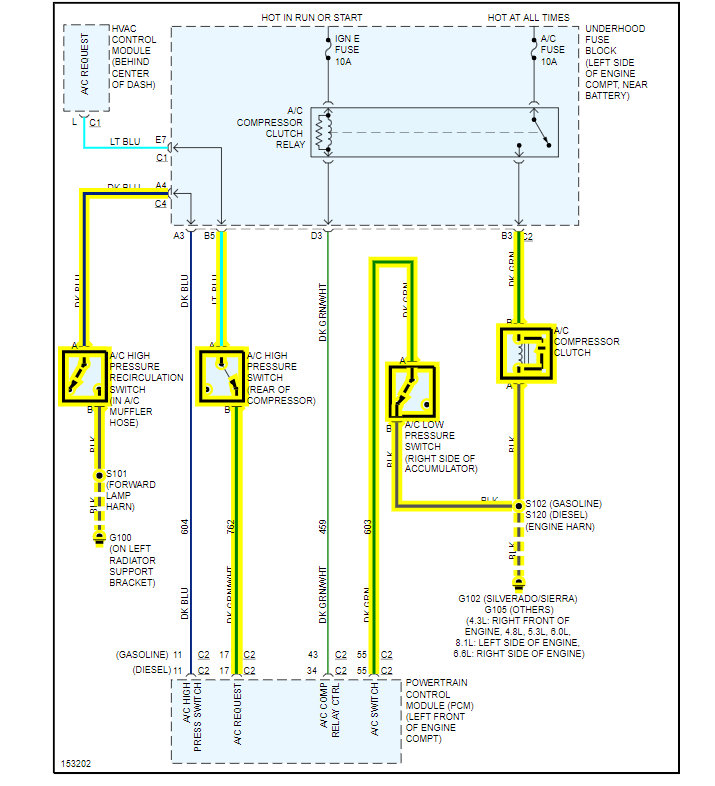

More not than working.
The only way I can get it to come on is crackpots the windows at highway speed or run up to over 85 MPH. Sometimes it works more often not and from 85 MPH if I coast to 70 MPH. If I put on speed control once it's on it will stay on for a good while.
Can you tell me if there is way to hotwire the compressor? I've replaced the sensors inside and out. It's always fully charged and no one knows how to find it. If they can get it to run at all.

Pressures are good, not it. Can you give me the supposed voltage from PCM to compressor so I can run a hotwire?
Sep 7, 2021 at 8:33 AM
What are the pressures? I need those readings.
It comes from the relay, not the PCM. Look at the diagram. Pin 87 of the relay is where the wire runs to the compressor.
You can jump pin 30 to pin 87 and the compressor should come on.

Not from PCM, got it. What is the voltage that ends up at the compressor?

The voltage that energizes the clutch?
Sep 7, 2021 at 8:54 AM
Battery voltage. It should be a minimum of 12 volts.

Are you 100% sure? I know the power is from the relay but the minimum coming from the relay is 12v? One last question please. If I run a switch 12v from the battery for the compressor, is there a way to incorporate the low pressure switch (if it's not the culprit) with this new switch?
Sep 7, 2021 at 12:49 PM
I am 100% sure.
You can run a wire from the battery to the low-pressure switch. The output from the low-pressure switch goes to the compressor.
You can install your toggle switch anywhere in that circuit.
