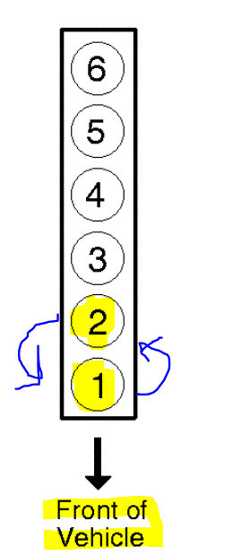

Here is what I want you to do. Each cylinder has its own coil pack. We are going to switch cylinder 1 coil with cylinder 2. Then you drive it. If the light comes back on and stays in cylinder 1, then it is either a spark plug or injector issue. If the miss goes to cylinder 2 (p0302), then we know it's the coil pack.

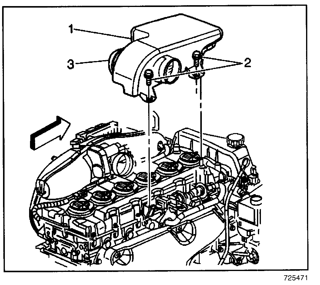

pic 1
1. Remove the bolts (2) holding the resonator to the engine.
2. Loosen the clamp (3) on the resonator.
3. Remove the resonator.

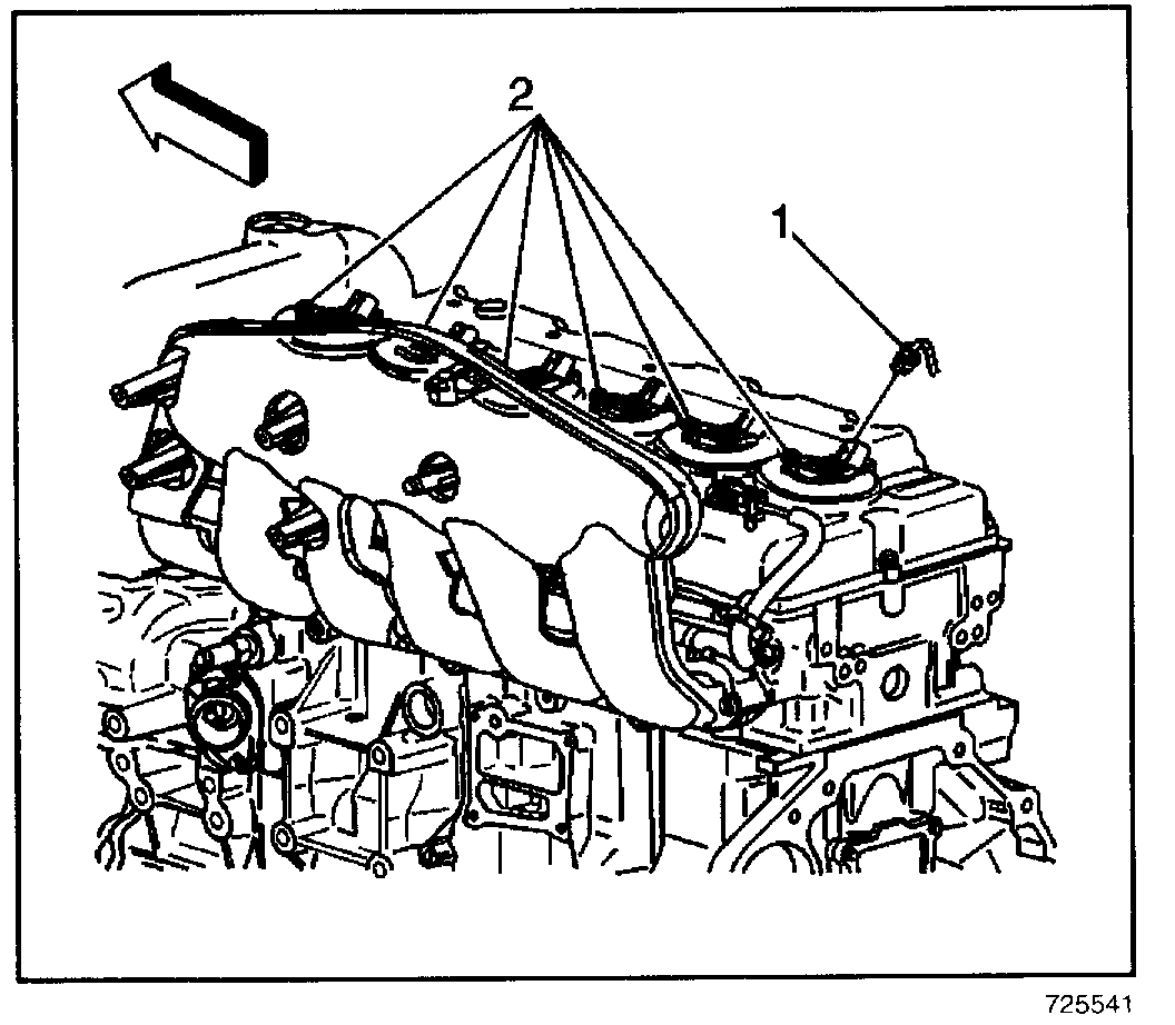

pic 2
4. Disconnect the ignition coil connectors (1) from the ignition coils.
5. Remove the retaining bolts (2) from the ignition coils.

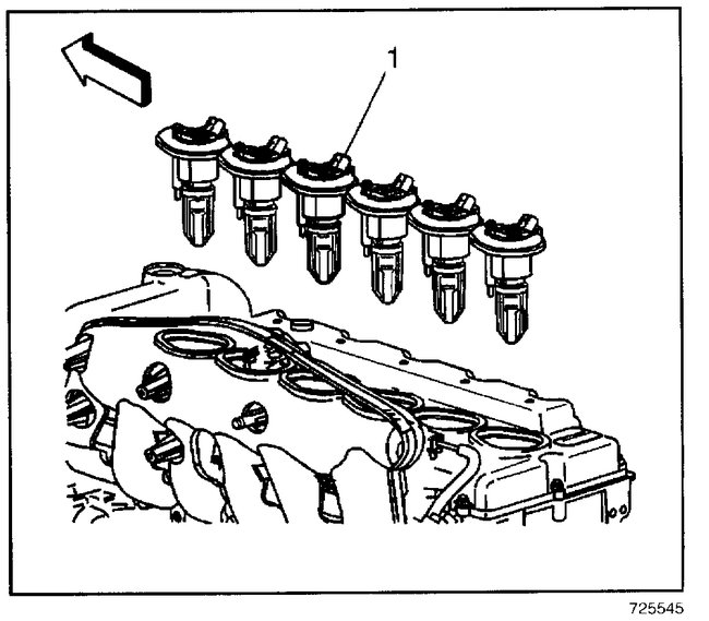

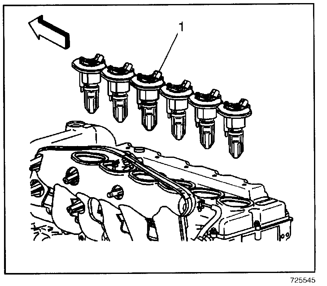

pic 3
6. Remove the ignition coils (1) from the engine.

pic 4
1. Install the ignition coil (1).

If you look at the last picture, it shows cylinder locations. Simply switch the coil pack between cylinders one and two and let's see if the misfire changes cylinders.
