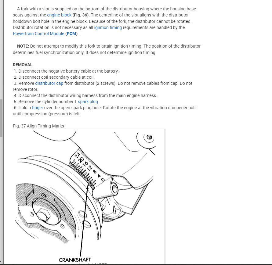

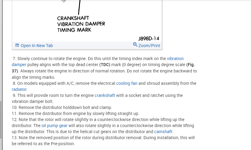

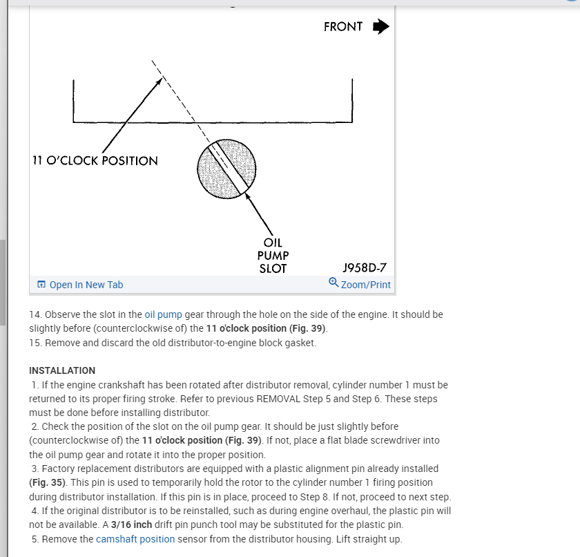

A bent exhaust valve could cause this, but it would not jump cylinders. It would remain on the cylinders that have the bent valve.
You can use a dollar bill and hold it against the tail pipe. If it feels like it is getting pulled into the tail pipe, then that is an exhaust valve issue.
However, I suspect we have a vacuum leak issue so let's start with checking for this using this guide:

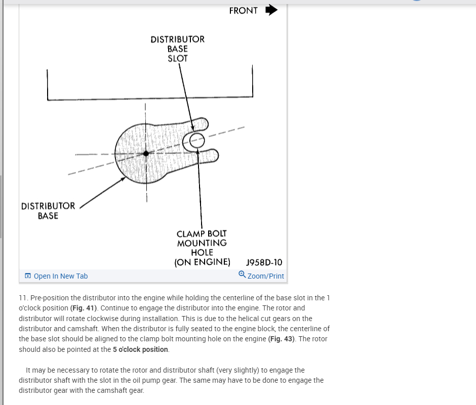

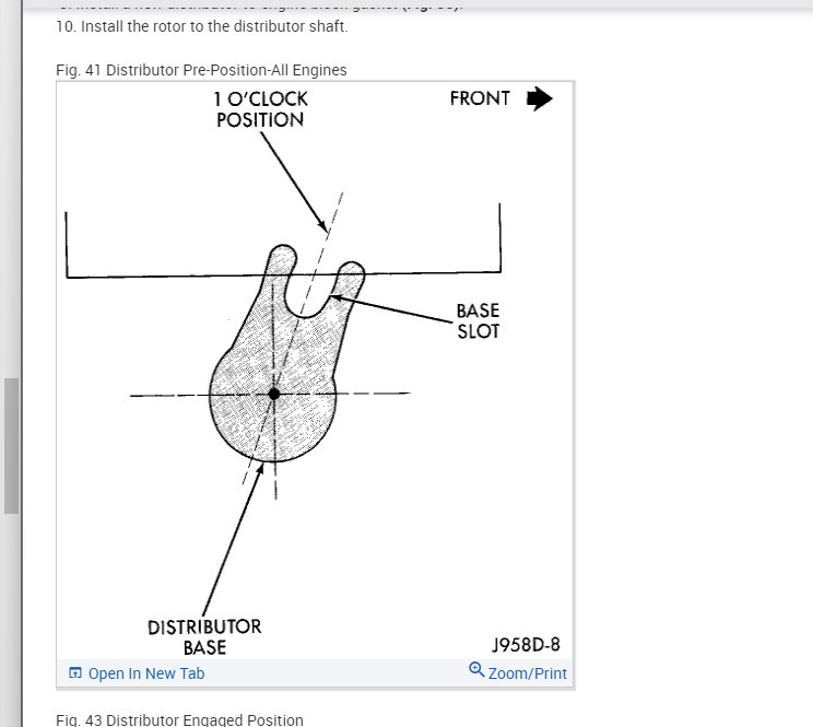

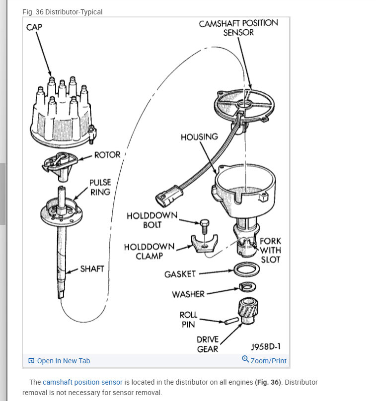

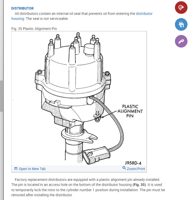

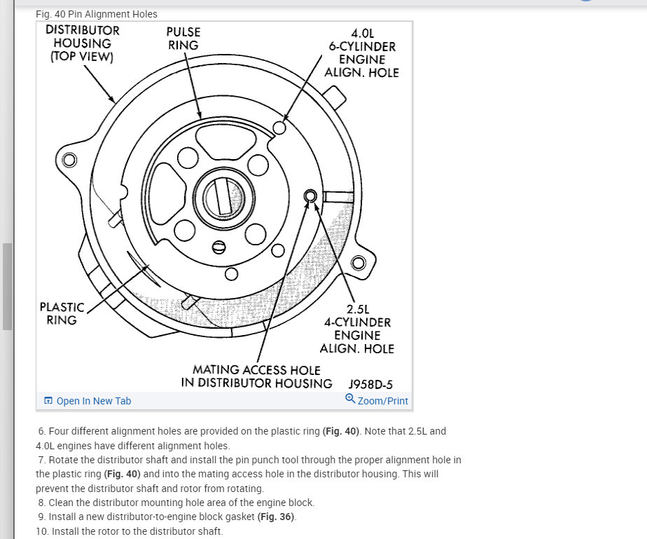

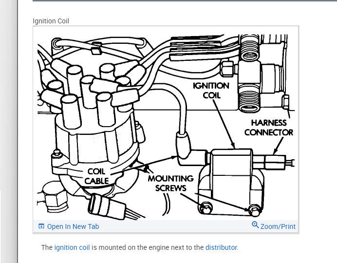

If that passes, then we need to monitor the spark and see if this is a bright blue spark because the next likely cause is a coil issue.

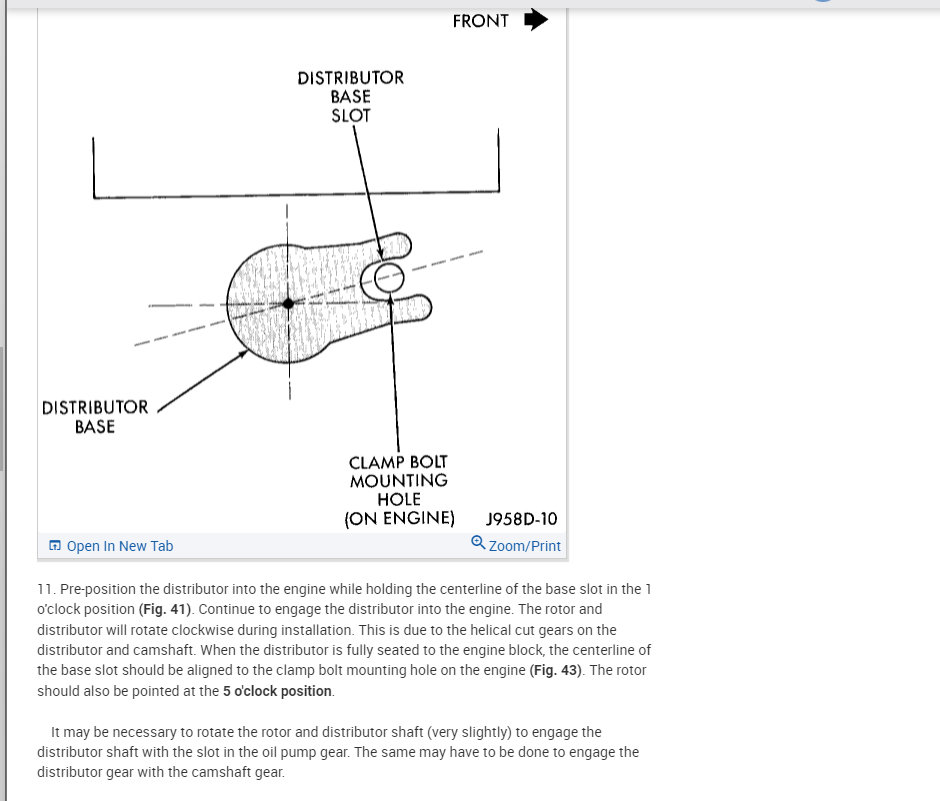

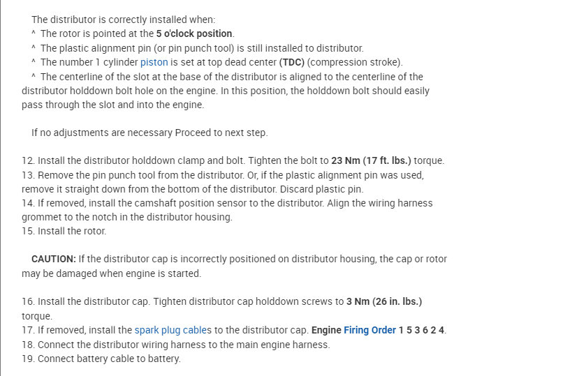

If this proves to be a weak spark, then I would go ahead and replace the coil and distributor as they are not that expensive, and most places will offer a kit, so it is a pretty good deal.
I am attaching the process for replacement below. Please run through this and let us know what you find.
