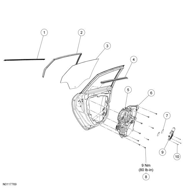

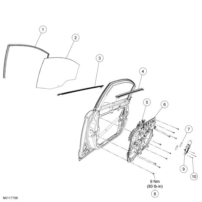

Intermittent noise sounds like coming from right door panel middle to back of car. The best way I can describe is it sounds like rocks being kicked around inside, but not constant and does not matter what speed. Started right after a recent Ford oil change and tire rotation. There was a lapse in the noise for almost two weeks but now it is back, still only intermittent.
Jun 3, 2018 at 10:40 AM
  • 110,248 POSTS
Hi and thanks for using 2CarPros.com. Since the noise seems to be coming from behind the door panel, chances are something has come loose in the door. What I suggest is to remove the panel and check for loose parts such as linkage, bolts, guides, regulator. I have attached an exploded view of both the front and rear doors. Picture 1 is the front.
