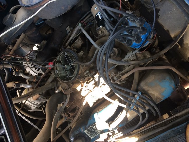

Okay so bare with me so I can list everything for you. Last year van started backfiring while driving down the road and it quit running one day and would not start again. I replaced the dual ballast resistor, coil, plugs, wires, cap, rotor, starter relay and final found it to be the ignition module/spark controller.
Two months later the van would occasionally shut off and not start sometimes. Stored it for the winter and brought it out two weeks ago to it running fine! No issues.
Last week I filled up with gas and parked in the driveway. Went out in the morning to start it and would not fire! Turns over strong but will not fire at all!
Looks like I have spark. Checked coil with a known good one just in case and no change. Tried jumping power to coil no change. Checked pickup coil and ohm tests are good. Cleaned all grounds. Rebuilt carburetor thinking maybe a fuel problem but has fuel too.
Left it a day and came back to it and it fired first turn of the key! Tried three more times In a row and it is good. Left it for an hour came back and would not start again.
Lost for what to do next!

Then if the pick up is good, and resistor new then it is probably the control unit on firewall or poor connection or see if you get good spark from coil to dist if you are spray carburetor cleaner down carburetor see if it fires if it does then it is a fuel problem like maybe the float level is to low, accelerator pump etc. You can test fuel by doing the 1/2 pint in thirty seconds velocity as well. One other thing Chrysler always had a filter prior to pump see if it is clogged.

Hi as mentioned above the control unit is also new, I am getting spark. Carburetor has been rebuilt. Filter changed. Carburetor cleaner caused a backfire so loud the pressure destroyed my new muffler.

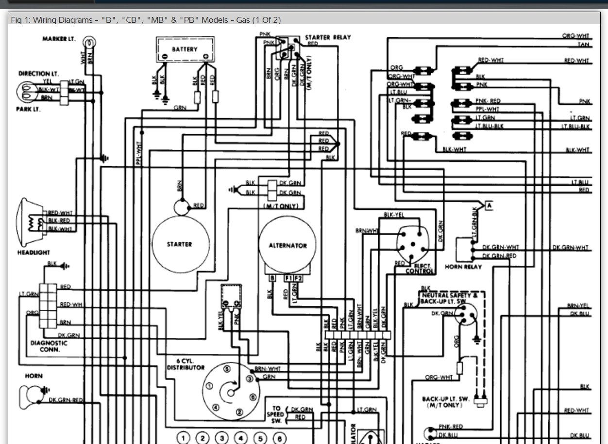

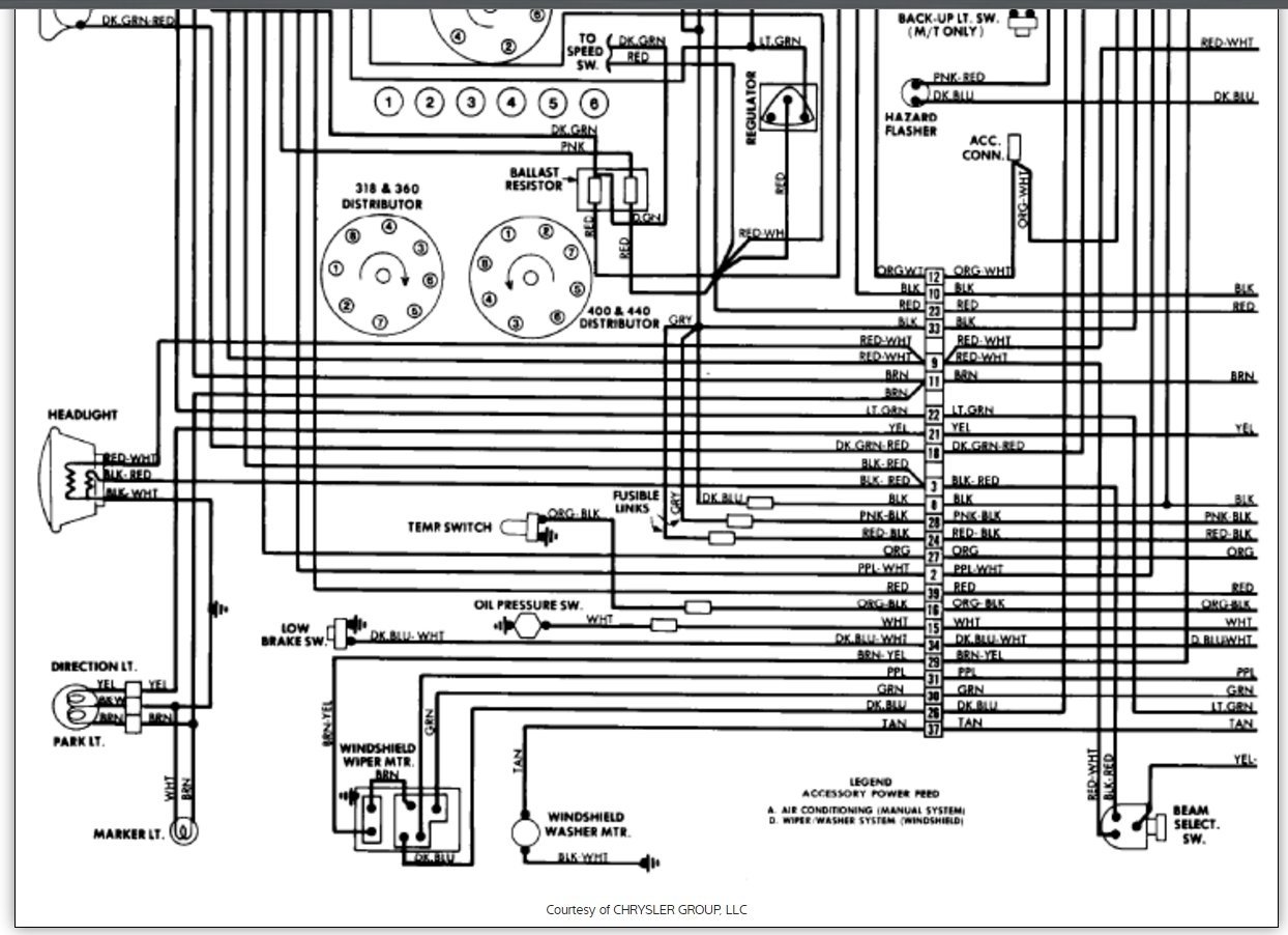

When the engine does not start can you check for power at the coil, it sounds like the ignition switch has gone bad which will cause the intermittent starting which will blow up the muffler as well. I am seeing a starter relay that supplies power to the coil as well, here is a guide and a wiring diagram so you can do some checking when the engine does not start.
The ignitions switch is the "electric control" in the diagram
Please run some tests and get back to us so we can continue helping you.

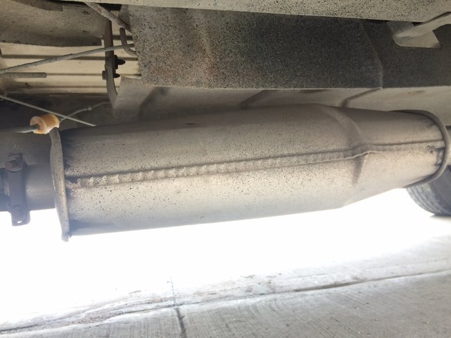

Hi trying to figure out how an ignition switch has anything to do with my muffler? Also as stated above the muffler blew up from a backfire caused by the dude above telling me to spray carb clean into the carb.
Power at the coil is 6 volts in "run" position and 12 volts during cranking. (Normal for a dual ballast resistor setup) engine cranks fine just does not fire. Ignition module is new, starter relay is new, ignition is good (as stated above)

If the ignition switch is shorting when it gets warm it will intermittently shut off which then fills the muffler with fuel then the ignition switch starts working again it ignites the fuel in the muffler which make the do that.
Most of the vans that year had a auto choke so we apologize for that.
When the van stops running can you please check the brown and white wire coming out of the ignition switch for power?
