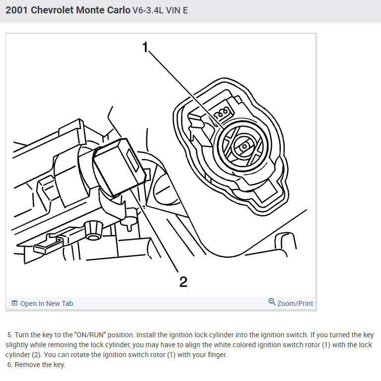

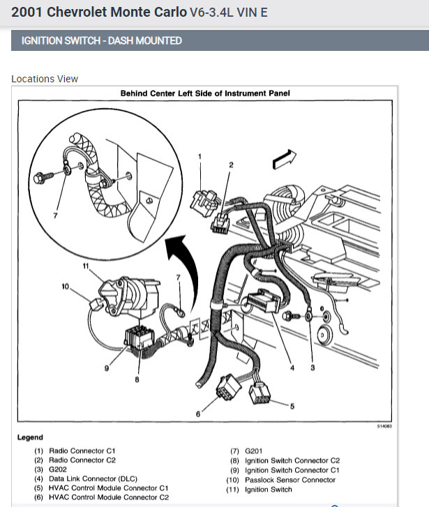

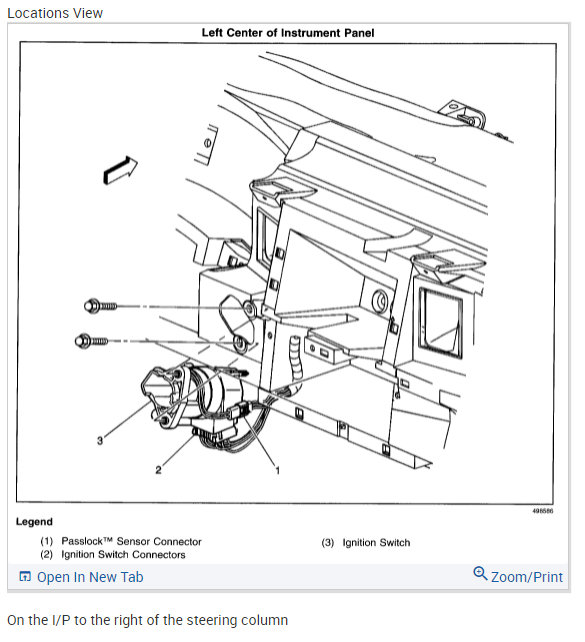

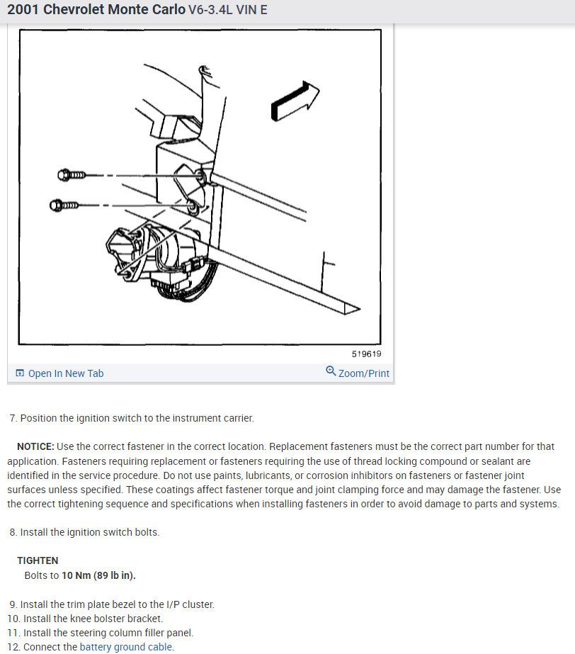

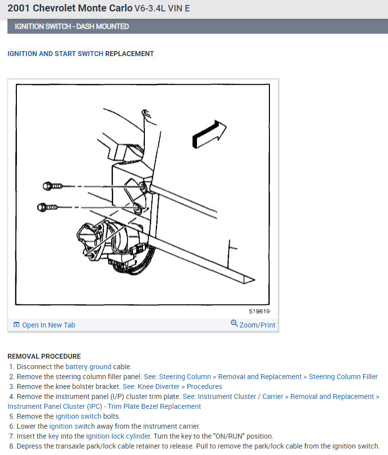

When you turn the key and there was not noise. Then it is likely an intermittent issue with the ignition switch, the electrical switch that the lock cylinder attaches. Many of these vehicles have issues with the dash mounted ignition switch.
Overtime the connector inside the switch wears off and you will get intermittent no start.
Here is a helpful video:
https://youtu.be/pM8-ugbMDTs
Let me know of any questions.

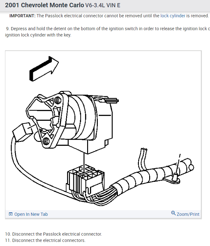

The pass lock gets its signal from the ignition switch. So yes it could be pass lock, but then again if the switch is not sending the signal to the pass lock it won't start the car. It will typically flash the anti-theft/security light.
