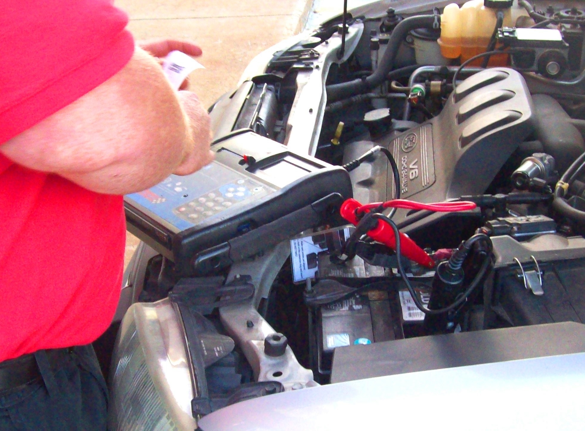

Many auto parts stores can check out your battery/ alternator/ starter with a portable machine used in the parking lot. It only takes a few minutes to test it all.
The pic below is from my local "Advance Auto Parts" store.
Keep us posted with your fix.
