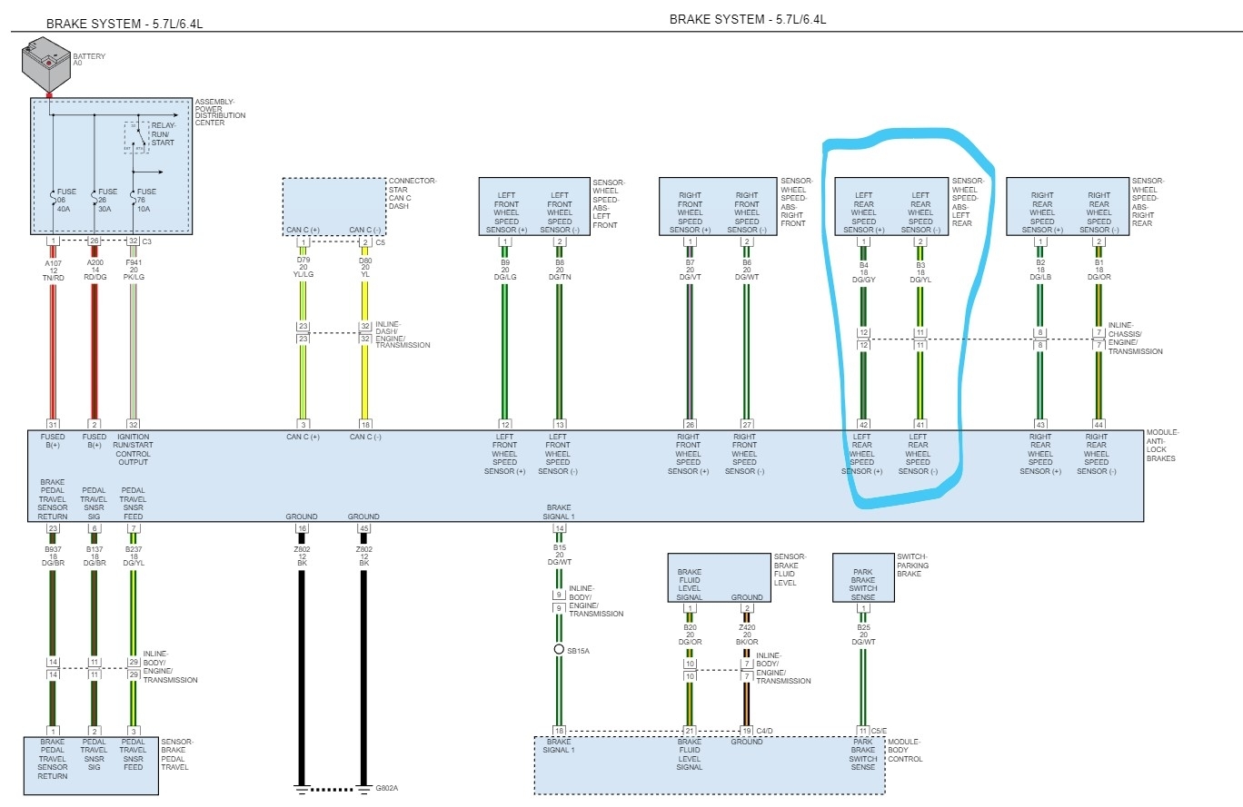

Can anyone post the diagram or link, please?
Apr 17, 2023 at 1:12 AM
STEVE W.
  • 15,349 POSTS
The two wires from the sensor go to the ABS module with a single connection in the harness. The easiest way to test it would be to go to the ABS module and find the dark green with yellow stripe and dark green with gray stripe at pins 41 and 42. Then unplug the sensor and short the terminals and test at the ABS end for continuity. The other way would be if you have a scan tool that can read live ABS data and if you have that you could unplug both rear sensors and jump the right signal to the left side and see if you can now see the speed show up on the left side when you spin the right wheel.
Attached is the wiring for those sensors and the inline connector.

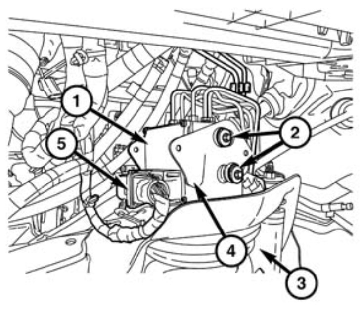

Where is the ABS module?
May 7, 2023 at 7:24 AM
  • 110,244 POSTS
I noticed you haven't been contacted for a couple of days. Have you been able to make any progress?
As far as the module, I attached a pic below to help you locate it. Let me know if that helps or if you have questions.
See pic below.
May 9, 2023 at 1:11 PM
STEVE W.
  • 15,349 POSTS
The ABS module is located under the fender behind the liner on the driver's side attached to the hydraulic brake module that has all the brake lines coming in and out of it. To get to it you remove the wheel and then the fender liner. The modules are above the spring mount. You can see it from the engine compartment but not really get to it. I take it that jumping the sensors still showed a bad left sensor? Hope it's just a bad harness or connection.

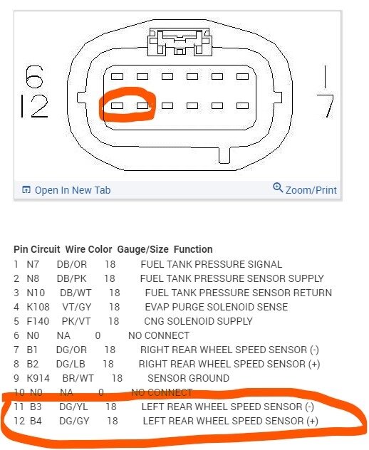

I tested the line from the sensor connector to the ABS module connector and found good continuity on leg 41 but no continuity on leg 42.
Now I'm at a loss as I cannot find the 12-pin connector. My belief is this connector is between the left rear sensor connector and the front ABS connector. I am hopeful this will shorten the wiring I need to replace to try to correct my problem. I have a new 2 wire connector to replace at the left rear if needed.

That harness connection is under the truck below the driver's seat area as shown in the image below. If they replaced the sensor and the error cleared but returned, I would suspect it's the connector where the sensor plugs in, the ones Chrysler uses have a bad habit of failing right at the crimp where the wire enters the metal terminal. As you know where the terminal on the ABS module is you might want to try a puncture test. Take a sewing needle or similar and poke it through the insulation an inch or two up the wire at the sensor end, now test for continuity. If it's okay now, it's the connector. If you still have nothing dig out the inline connector and check there. Use a drop or two of liquid tape or similar to seal the hole you poked in the wire. Or if you replace the connector, be sure to cut the wire above the hole.
May 11, 2023 at 2:14 AM
SUGARRAY40
  • 36 POSTS
So, I tested the 2 separate runs. From the rear connector to the 12-pin connector and from the 12 pin to the control unit. Both runs had continuity. I’m going to replace the rear connector as suggested and see how this affects things. I hope to get to this today. I’ll keep you updated.

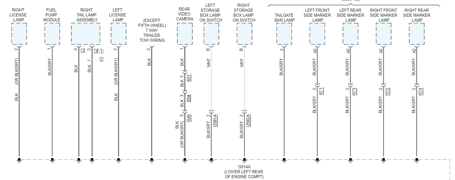

Update:
I took a vacation for 2 weeks and sent my truck to a different local shop that I have been told the owner worked at 2 Ram dealers before opening his own shop.
He stated he found a rubbed through wire in the front wheel well but is unsure if it is the ABS circuit. He repaired this and stated he drove the truck on "rough" roads and didn't have any codes, warnings, or lights.
I paid and left the shop and when I put in reverse my dash told me I had a backup light out.
No big deal, I have 128,500 miles on the truck. Then within 4 miles after going over a bridge on the interstate at 76 mph the traction control light flashed, cruise stopped. I was able to resume the cruise and drove another 2 miles and fueled up. When I started the truck to head home my dash told me in addition to the backup light my right brake/turn light was out. Again, didn't think much of this given the age of the truck. So, I went to Auto Zone and picked up replacement bulbs and when I put the truck in reverse with key in run the right light was out. When I took the bulb out, the wire was intact. I used a jump box to put 12 volts to it and it lit right up. So, I became suspicious that there is now a problem in this circuit. I have LED brake lights so I can't replace them and have to buy a new taillight assembly, $450, but I do not believe it is really out.

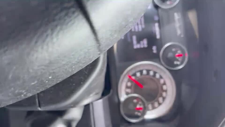

While driving around town, 25-35 MPH, the same intermittent problems occurred and now a new problem with the rear park sensors. I'll post the video.
So, I still do not have my problem fixed and have 2 new problems.
My plan is to contact the most recent mechanic and have him tackle it again.
Thoughts?

The taillight issue could be the ground, it is common between all the lights and it runs all the way up the truck and to a ground point 914 in the left side of the engine compartment. Likely in the same harness where the other wire was. An easy test, black wire is the ground, use a pin to push through the black wire, connect the pin to ground, light works? Bad ground wire, Remove pin and seal puncture with liquid tape. Chrysler is well known for bad grounds that look perfect. That same ground point connects to these other items as well. I would have them look at that same harness again then the ground. It would not be the first-time multiple issues were ground related.

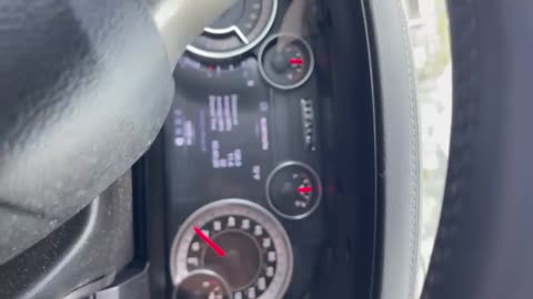

While I was watching the video, I noticed once or twice it appeared the information center glitched on and off. Did that happen or is it because it's a video?
If I had to guess, there is an internal fault with the ABS module. Let's see if Steve has any other ideas.
I'll watch to see what he says. Also, let us know if the shop told you what color the wire was that was repaired.

Yes, it will now flash between the warning and the normal “cluster” I use.

Yes, there is a "glitch" on the dash. But it is accompanied by a dinging when the rear park sensors are "off". This is new, it was just dinging 1 time and then telling me the sensors are off. It only has done this off/on "glitch" 2 times.

Update:
1) Thermostat replaced and no further problems
2) Right taillight and back up light - found the "repaired" wire which the dealer stated was only taped and not repaired. Repaired this broken wire free of charge and taillight works as does back up light. On a side note, the original call back about the backup light was that "I needed a new bulb" and I had to correct them that I checked the bulb, and it was intact.
3) Rear Park sensors - those intermittent warnings have resolved once the above wire was repaired.
