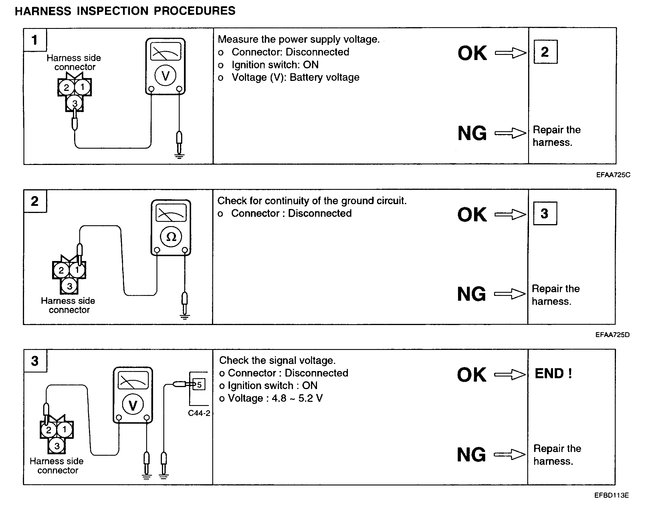

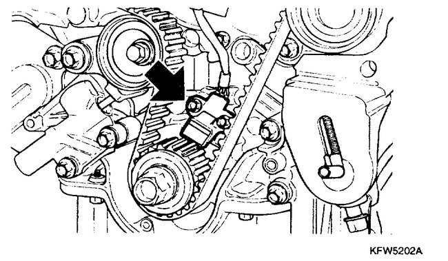

What you described sounds like an issue with the crankshaft position sensor. It can fail and not set a code. Take a look through this link and let me know if it seems to mirror what you experience.

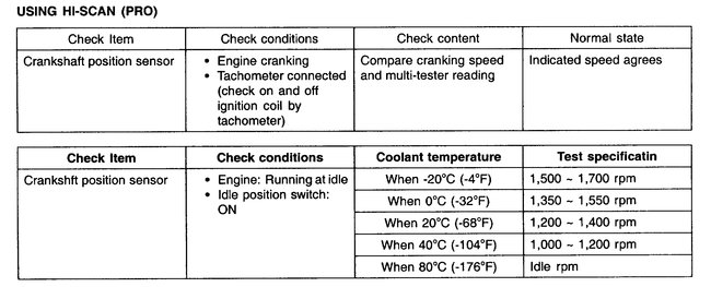

What I suggest is this. When it refuses to start, either check for ignition spark to the plugs, or if you have a live data scan tool, check for an RPM signal when the engine is cranking. When these sensors start to fail, oftentimes they are affected by heat. Once they cool, they work again.
Here is a link that explains how to test ignition spark:
We want to be sure if the sensor is bad before trying to replace it. It isn't an easy one to replace simply because of its location. If you question it, here are the diagnostics for testing the sensor and system.

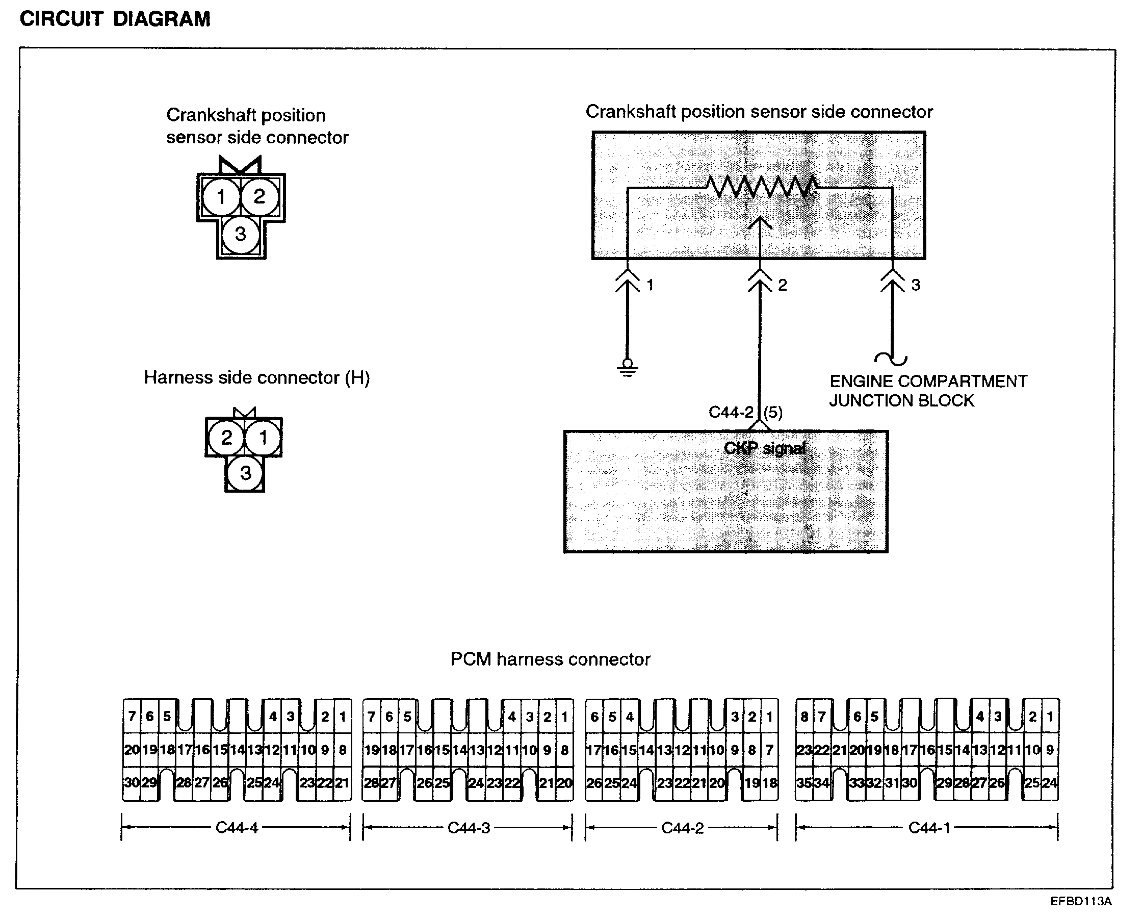

CRANKSHAFT POSITION SENSOR
The crankshaft position sensor is a Hall-effect sensor that senses the crank angle (piston position) of each cylinder and converts it into a pulse signal. Based on the input signal, the PCM computes the engine speed and controls the fuel injection timing and ignition timing.
Circuit Diagram
pic 2

Using Hi-Scan
pic 3
Harness Inspection Procedures
pic 4
