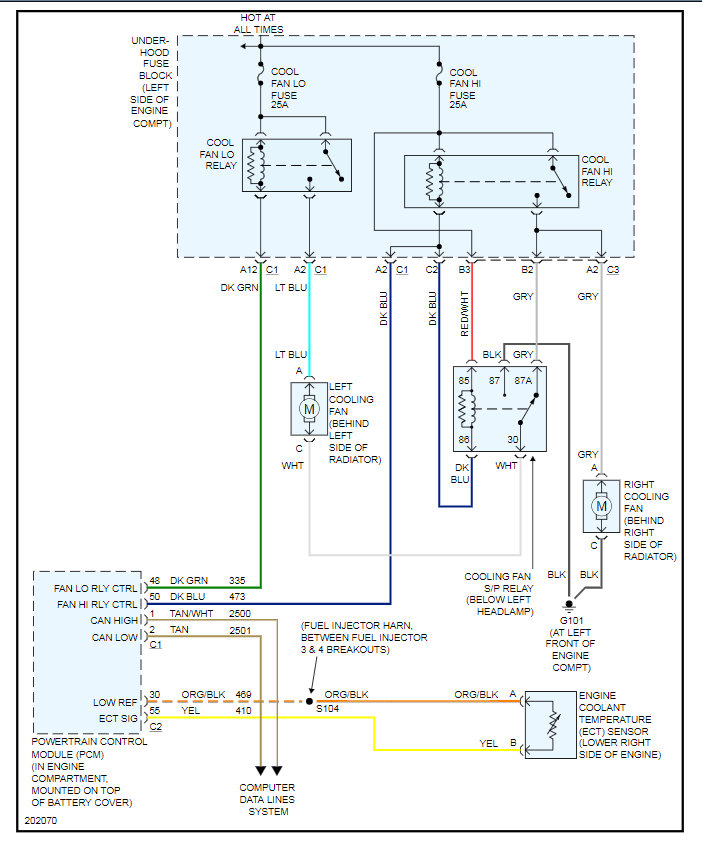

A/C works fine at highway speeds but not stopped in traffic. Both cooling fans are running at all times but still won't cool unless constant speed above 50 mph.

Charge is fine holds 1.75 lbs. I evacuated system to 500 microns and recharged it just to be sure. Charge is not the issue. 45 psi low side 220 psi high side.

Okay. That is great info. Thanks for that. Then that leaves us with air flow over the condenser. I didn't go here because you said both fans are working but if the A/C is working properly when moving and not when sitting still then the Freon is not getting cooled enough when you are not moving. That is the only variable when you are moving versus not moving.
The only thing in the system that "knows" you are moving is the amount of air flow over the condenser. Otherwise the system all works exactly the same whether you are sitting still or moving down the road. Again, this points to an air flow issue. Are you able to confirm the fans are coming on high? You should have two fans that have two speeds. Take a look at the wiring diagram for the relays. I would suggest we remove both relays and jump them both so that the fans come on high.
Let me know that the fans go to high speed.
