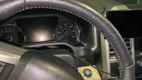

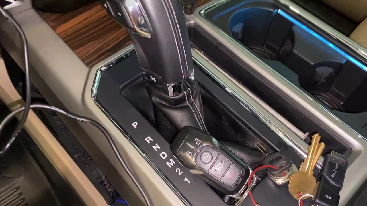

The brake lights work when you press the pedal even though it won’t start. The attached video shows that I’m pressing the brake and this time it only took four presses of the start button to get it to crank and start. Yesterday it took about 15 times. I’ve noticed the last couple of times, it finally did a short crank and the next press on the button had a full crank and start. The mechanic that looked at it said he hit the brake hard and it started but I’ve never seen any difference between a normal press and a hard press of the pedal. Since the brake switch was replace new with an OEM part, the problem was the same with the old and new. When I said it cranked slowly, I meant that it hesitated to crank immediately when the button was pressed in the beginning. Now the hesitation has becoming multiple button presses to get it to do anything.
May 23, 2021 at 5:49 AM
Okay. That helps. Couple more questions because it was hard to tell exactly when you pressed the button after the first one and then when the engine started.
When you pressed the button, it appeared the lights and everything came on like you pressed the button to turn it to the accessory position. So when you do not press the brake and push the button, it goes to the accessory option and everything comes on. Is this what is happening? It is like you are not even pressing the brake?
Next take the key and use it to press the button and see if it starts the first time. This is a push button/immobilizer override and if there is an issue there, it should start right away.
Lastly, have you checked for codes? I am not sure there will be any but we need to check and make sure.

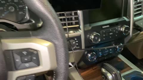

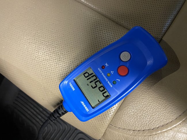

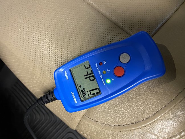

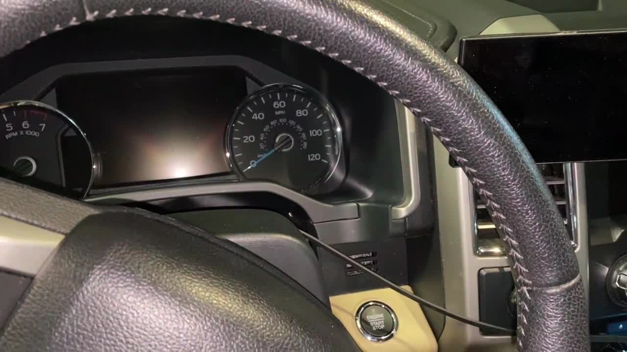

I’m attaching a better video. It took 11 tries to get it to fire this time. I used a small scanner and it came back with 0 DTC. I’ll include the photos of that. I really appreciate your help.

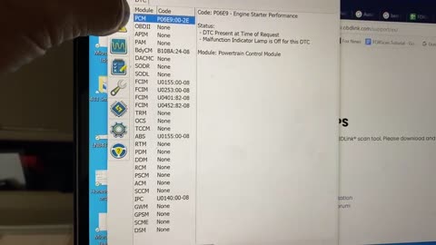

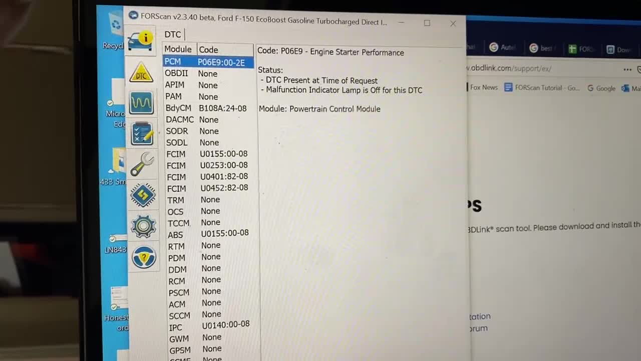

Added a Forscan tool to the truck and got this short video of the codes.
May 24, 2021 at 7:44 AM

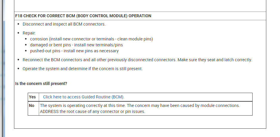

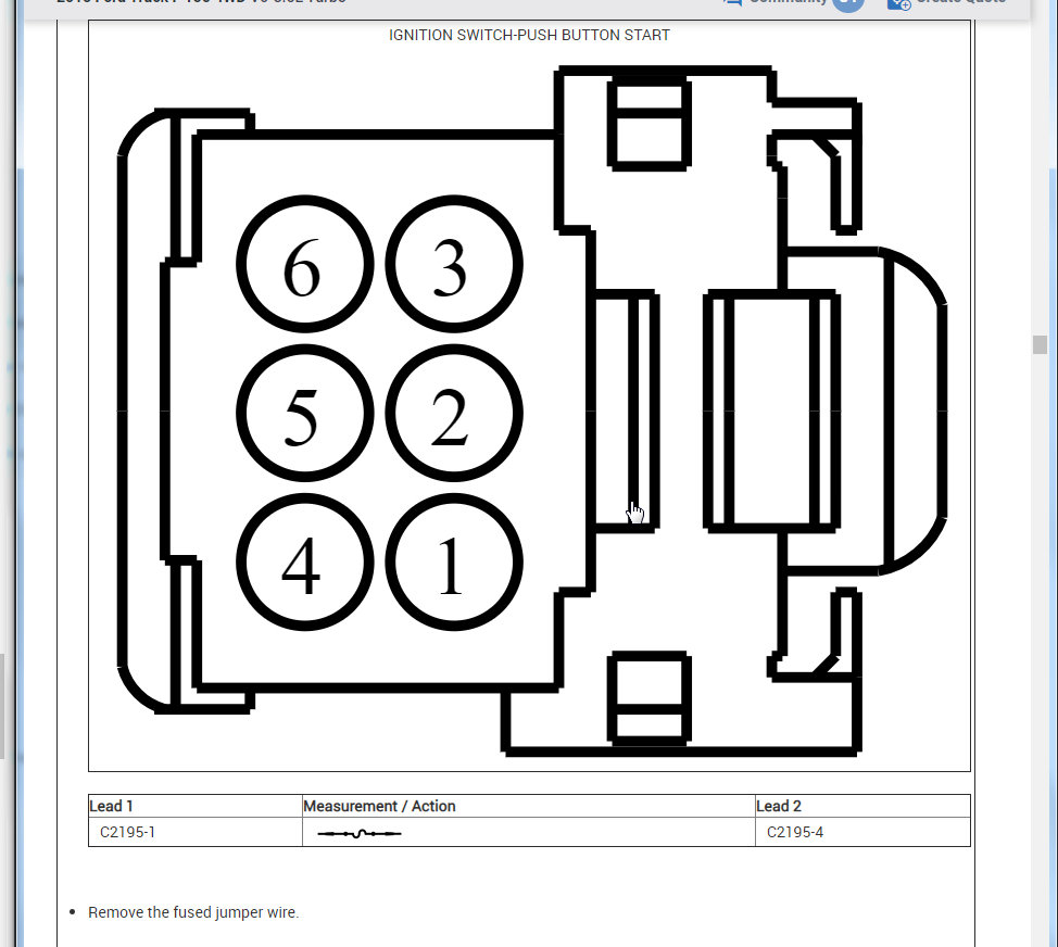

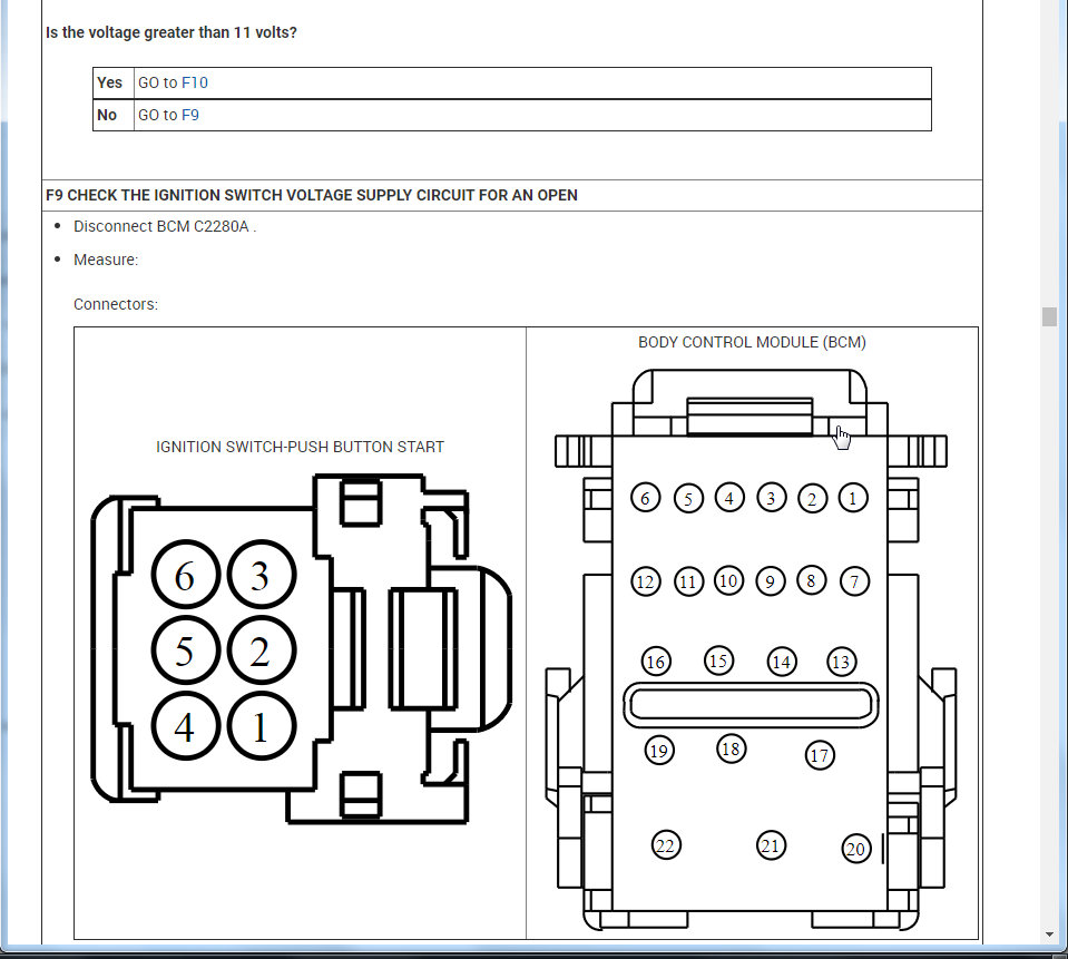

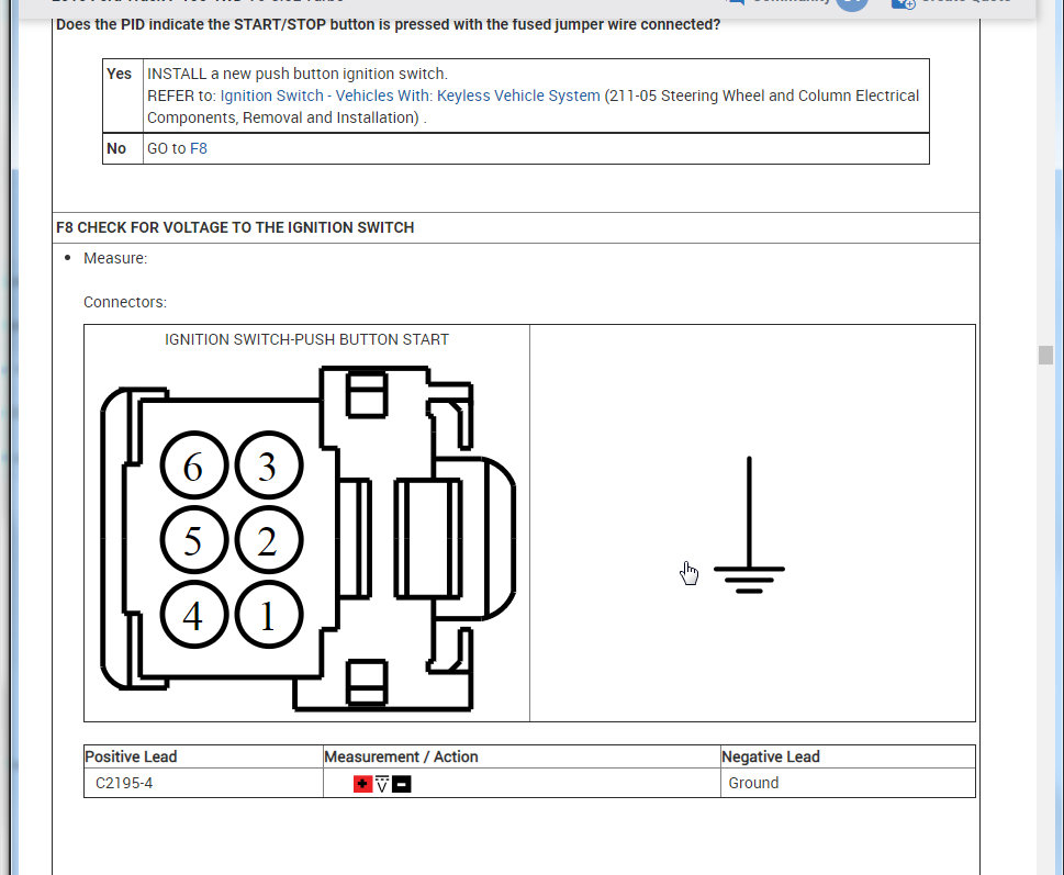

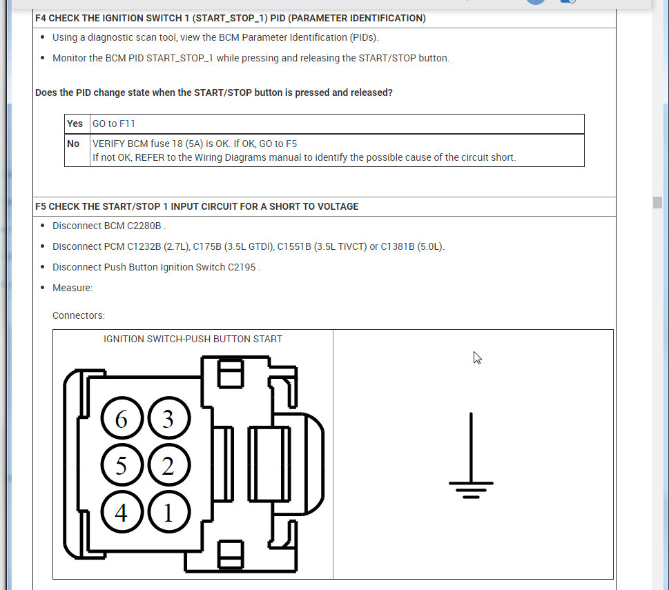

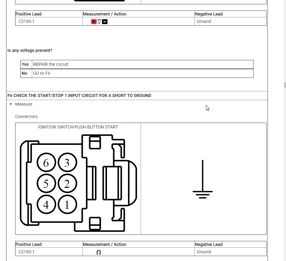

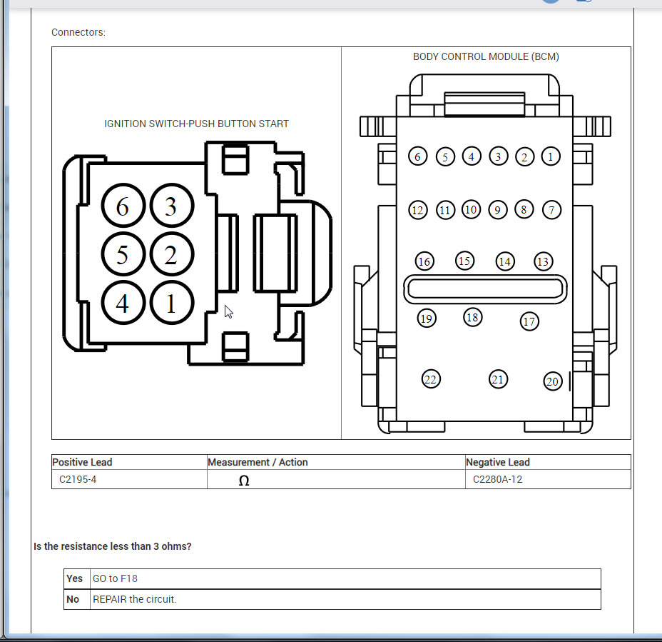

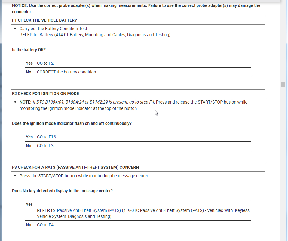

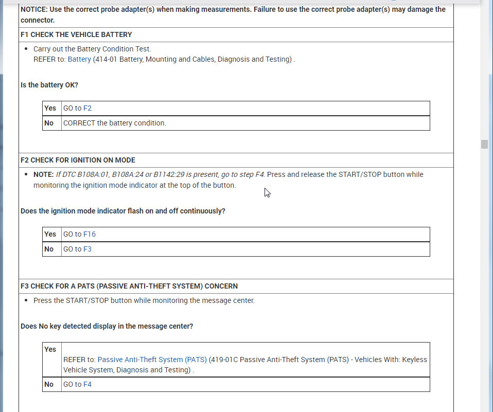

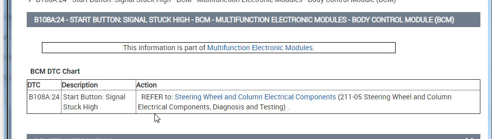

That is all great info. If you notice the light on the push button is flashing when you press it and it fails to start. That is normally a signal that the button is the issue.
However, with the last scan you have more evidence as to what is happening. The B108A is what we need to start with. This is directly for the start button.

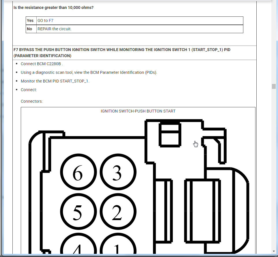

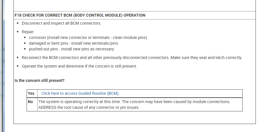

I attached the info below for this code. If everything checks out then it may be the BCM but we can get into that next.
This testing is not the easiest and I am not sure your scan tool will do some of this but it is worth looking into.
Things are starting to add up.

I really appreciate the feedback but this last info and testing was a little over my head. I scheduled with a local shop I've used and they diagnosed the issue as the starter having an excess current draw of over 200 amps when it should be around 150 amps. Right turbo (passenger side) coolant line was leaking and draining onto starter causing it to fail. They replaced four lines to stop the leak and also replaced the starter and I picked it up an hour ago. $1,400.00 and fingers crossed that this will solve the issue. Thanks again for your help.
Jun 4, 2021 at 7:44 AM
If they found coolant leaking on it then that absolutely makes sense. Thanks for the info and I am sure that will take care or it.
