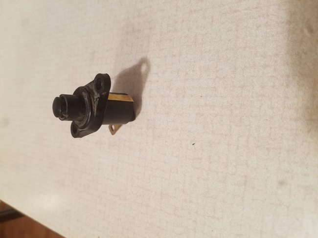

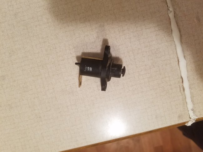

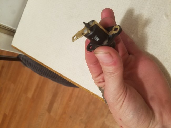

No problem, I have a hard time explaining things in an understandable way sometimes. Basically the switch showed signs of a possible short, to my understanding at least. With the switch depressed, the Door/deck light will stay on at times. And other times the indicator light on the instrument panel will be off and the door is open. I hope that makes sense. Not sure if it would make any difference at all but I took a couple pictures of the switch as well.

Okay. No problem. I think I understand just fine now. Just to be clear, when the door is closed the lights should go out. When it is open, the lights turn on. So the only way the computer knows the door is open or closed is the door switch.
If the switch is shorted or not working and the computer thinks the door is open all the time then it will turn the lights on all the time. If the switch is not installed right now then it thinks the doors are open and it will keep the lights on. Plus it looks like that plunger is stuck.
If it were me, I would just replace that switch and if the lights stay on then we either have a short to power or an issue with the BCM/Cluster.
The meaning of a short to power is that the lamp circuit is getting voltage when it should not. This is causing the lamps to stay on when it shouldn't. I would start with the switch and see what happens.

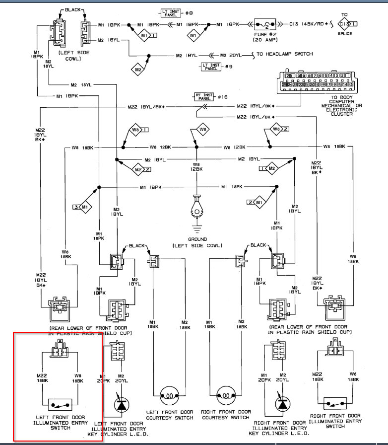

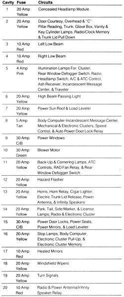

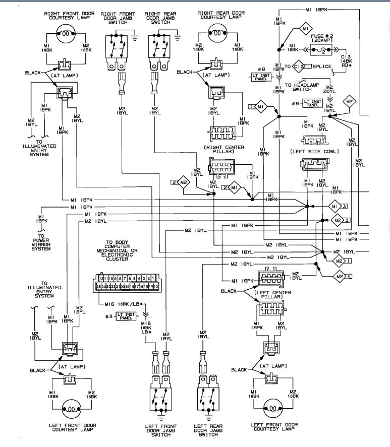

Thank you, I appreciate the help! So, the only fuse I found to control power to these lights was #2. With that circuit controlling radio memory it would have constant power anyway right? If the door switch is not the issue is there any sort of relay I need to find and check? I've been trying to find a wiring diagram but having no luck.

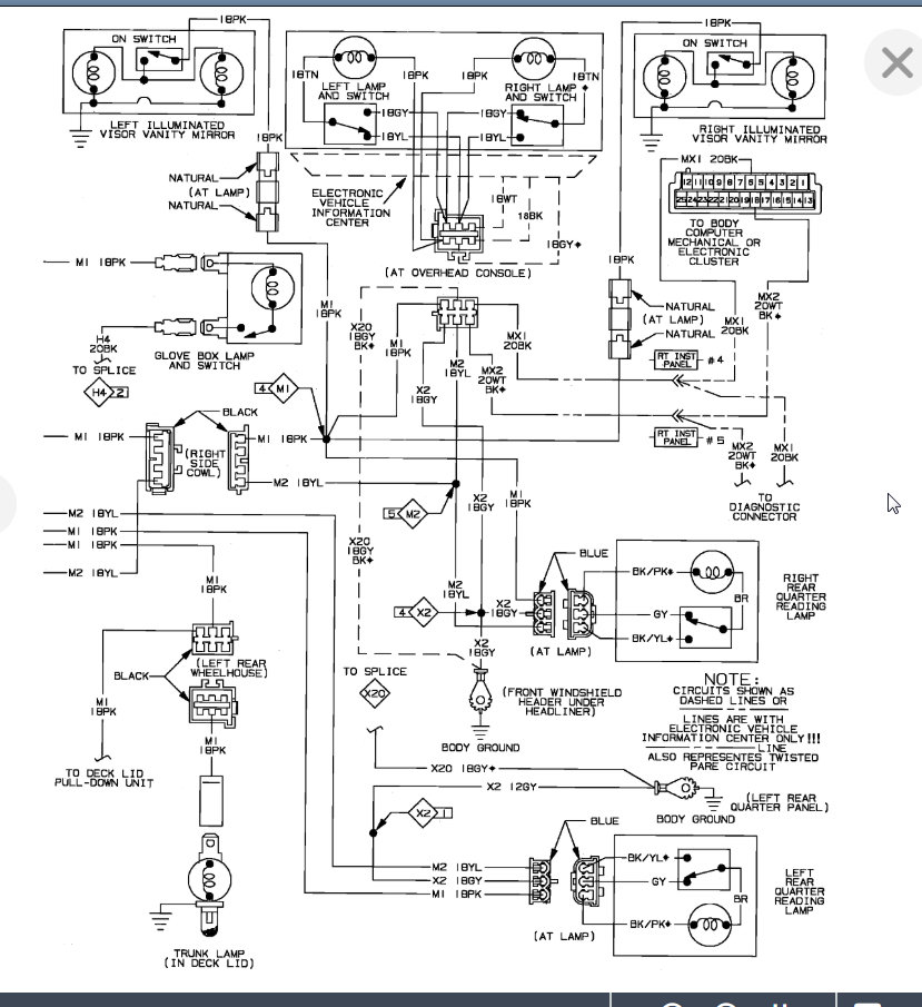

I attached the wiring diagram below. These are the old style diagrams and not the easiest to read.
There are no fuses or relays other then number 2. If you remove that fuse and it goes out, then the short to power would need to be before the fuse which is unlikely. Looking at the wiring diagram it looks like the other likely cause is the cluster. Also, we need to suspect the switch which could be keeping them on as well.
I would start with the door switch that was acting up and then we need to check voltage coming out of the switch and go from there.
