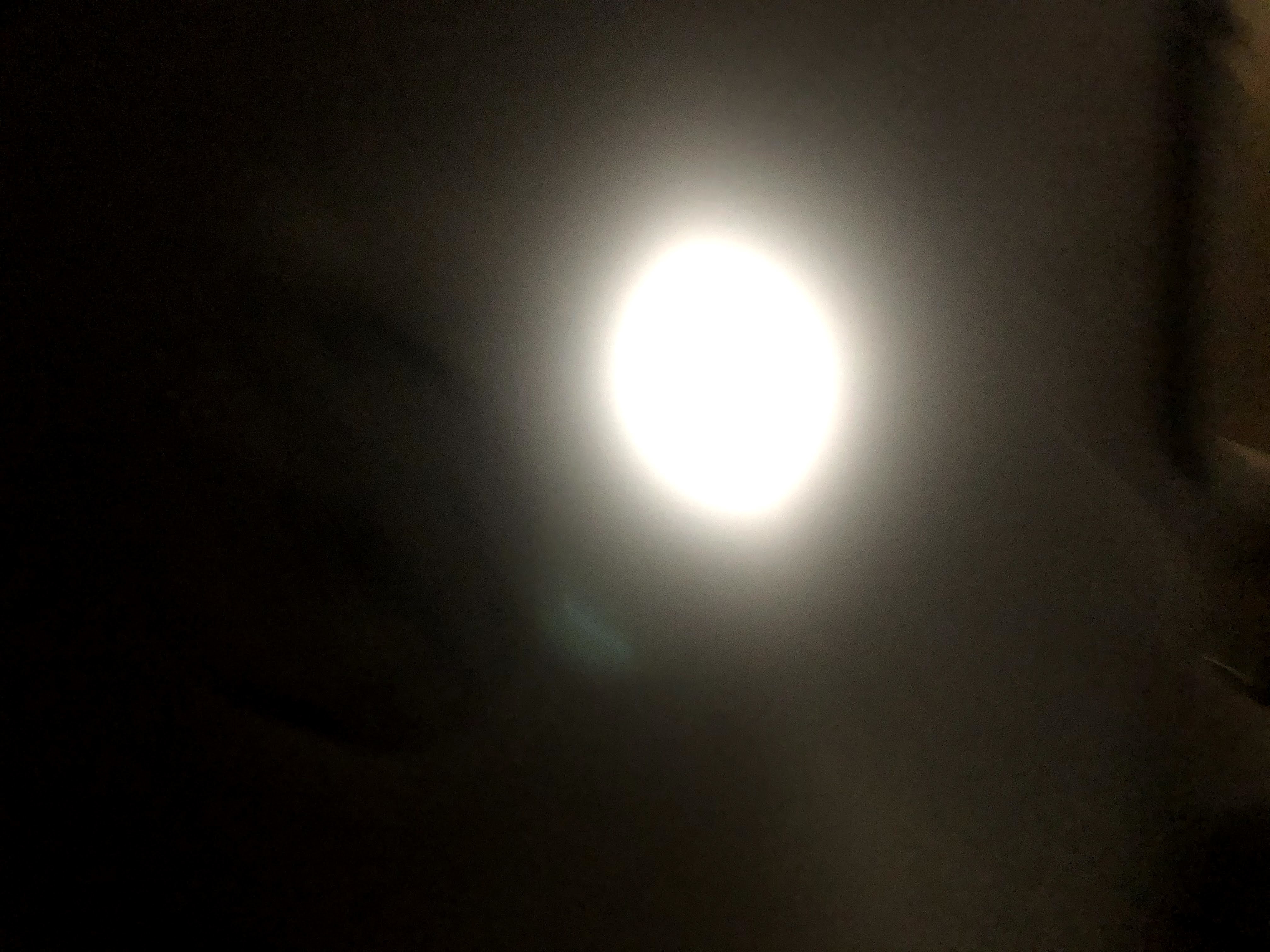

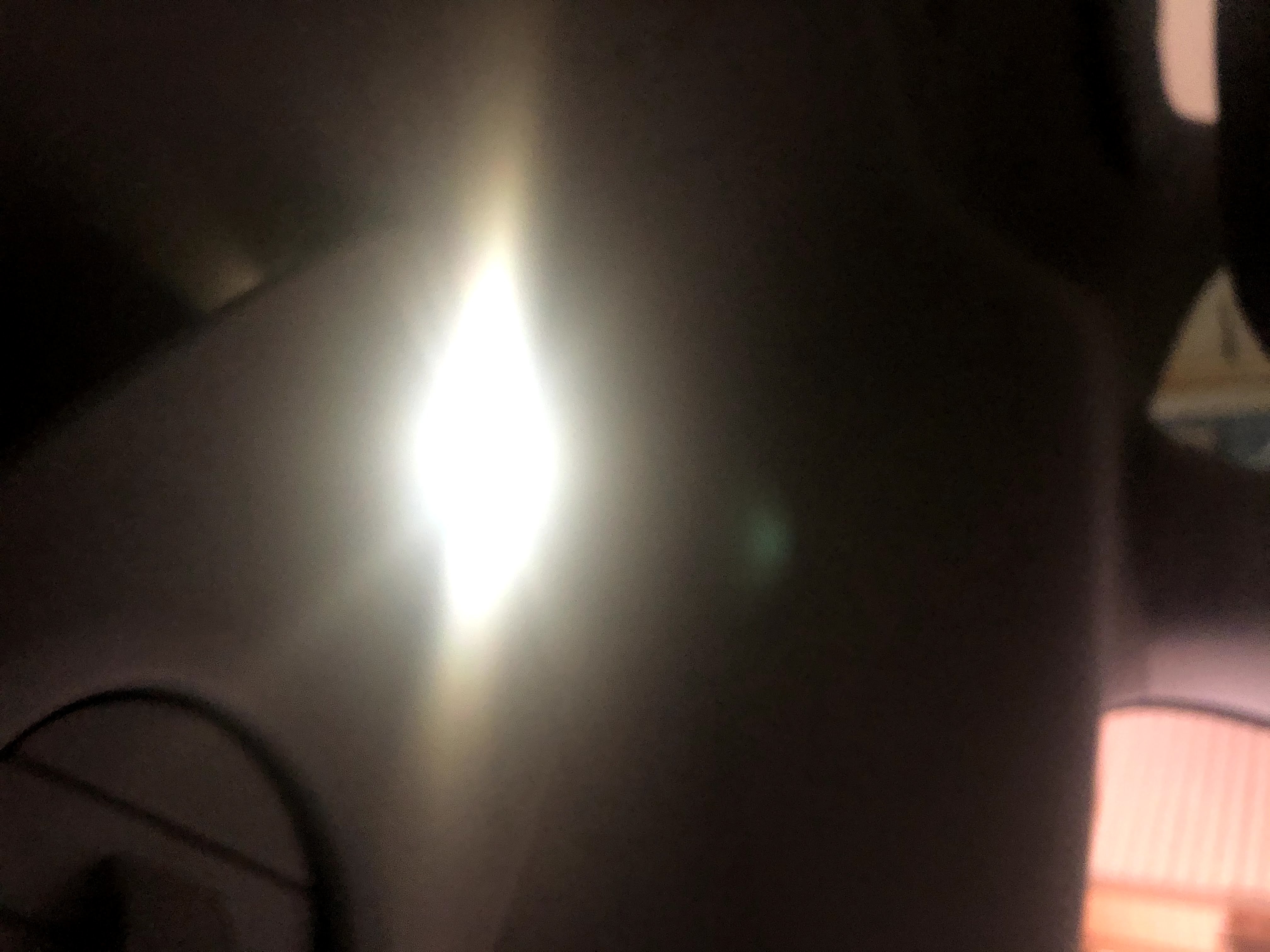

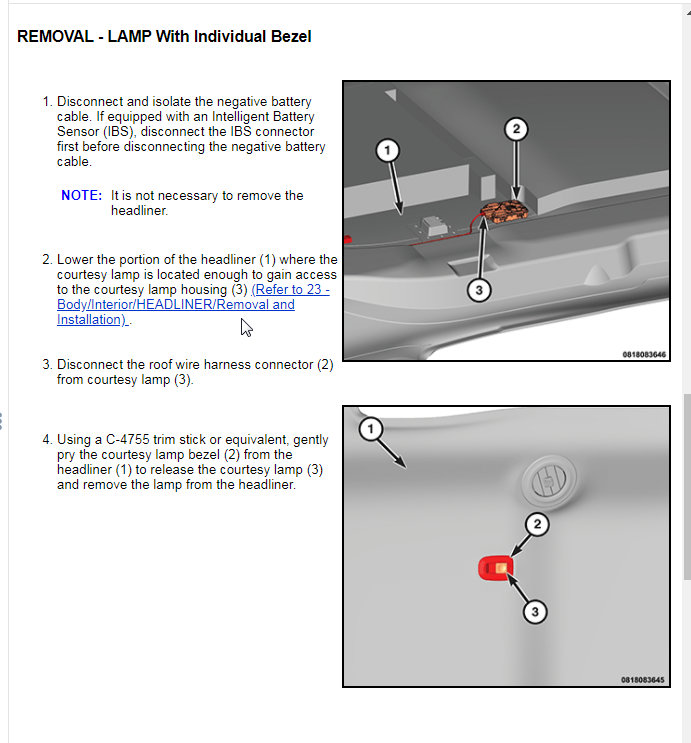

I created the following video related to an issue with my driver side rear courtesy lights.

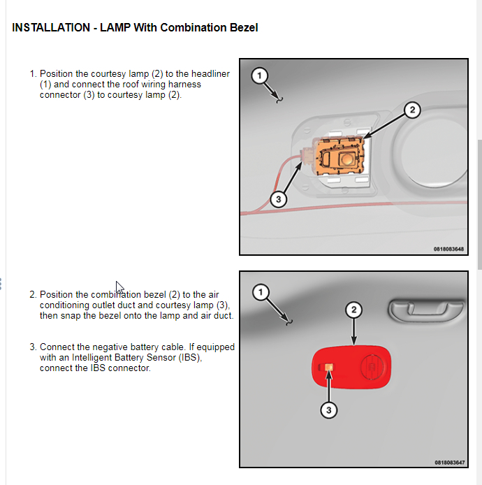

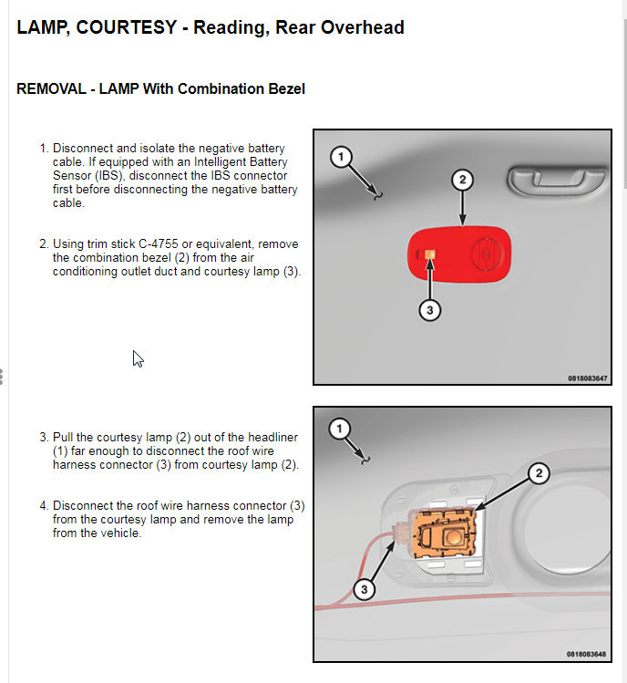

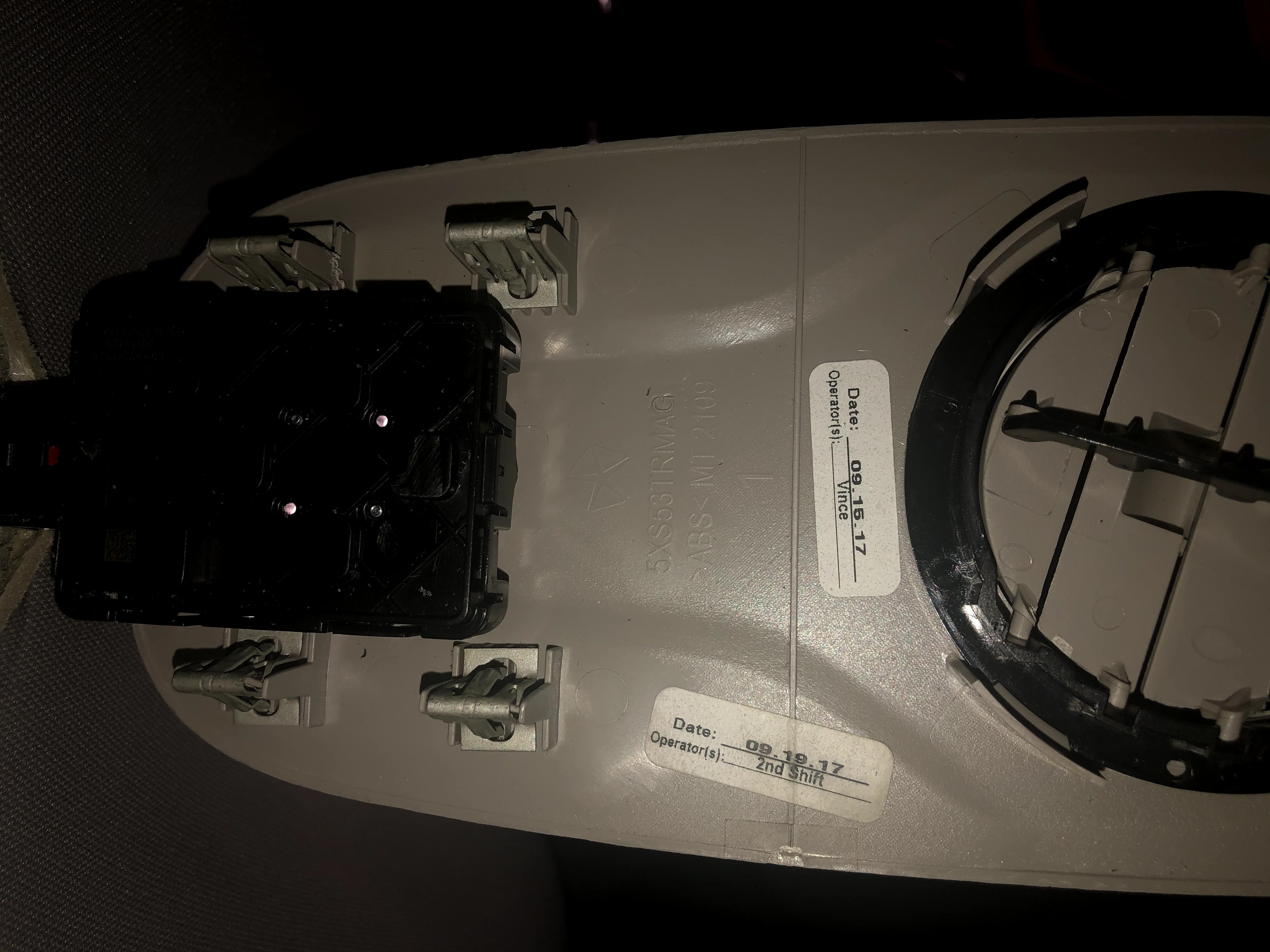

Great video. That panel should just pop out and you can retrieve the light bulb. You may need to replace the actual piece as I am not sure that will pop back in as I have not seen one pushed in like that but once you get it out you will be able to determine that.

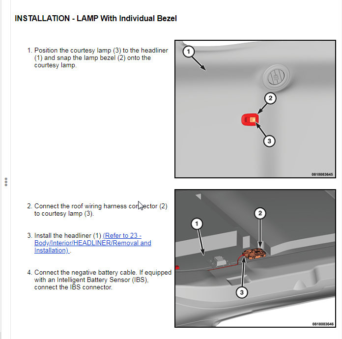

I attached the instructions from the manual for both the combination panel and the individual lamp. Your vehicle has the combination panel/bezel as it has the vent with it but others that view this with this issue may have just the lamp so that is for their benefit.
Let us know how you make out. Thanks

CHARLES RANDLE
It worked like a charm. Thank you so much.
