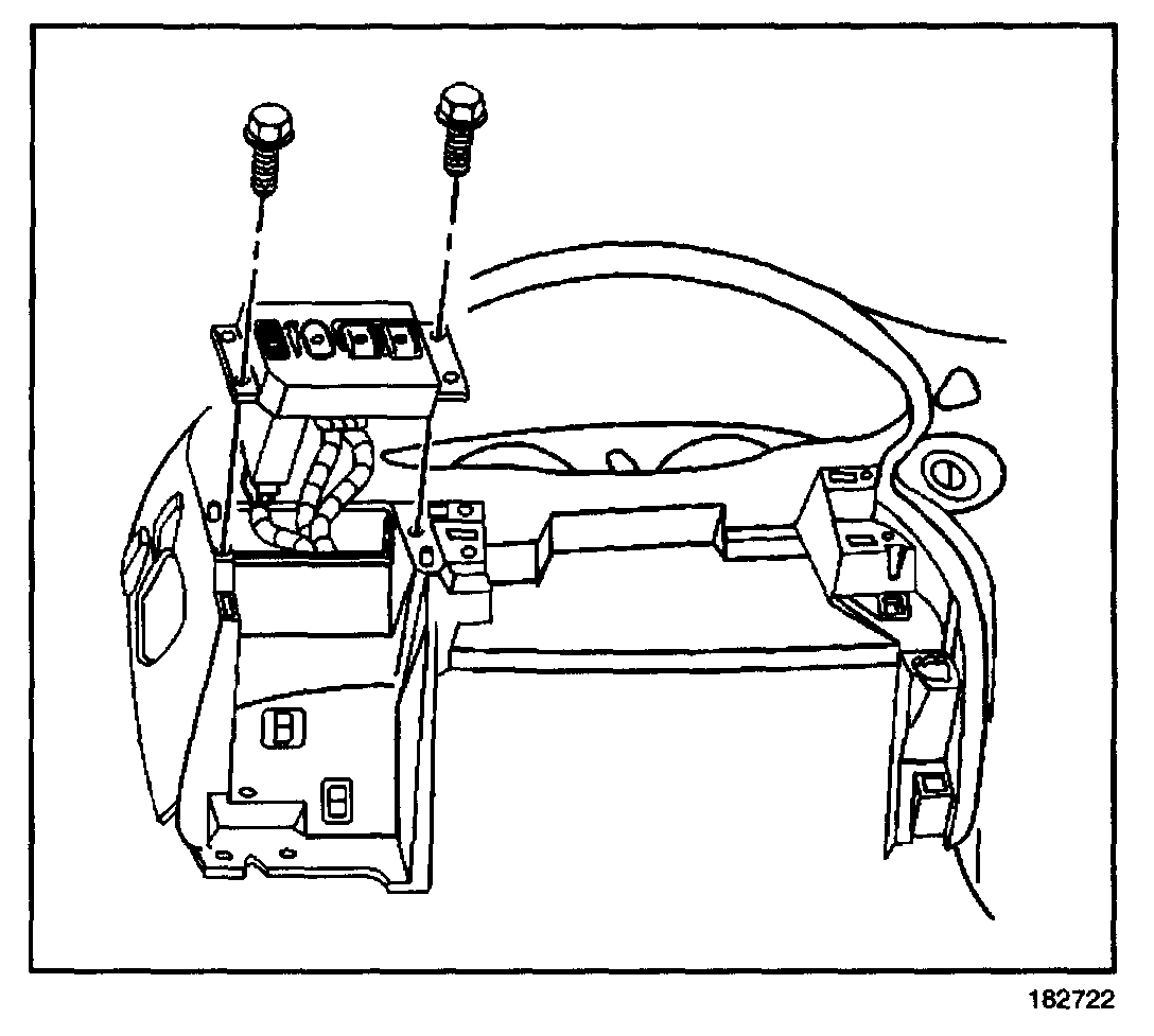

The issue with the lights being intermittent could be the dimmer section of the light switch. Try turning it up and down a few times and see if the lights work properly then. The variable resistor can start to develop a bad contact and do this. If moving the dimmer fixes the issue you can leave it in a place that works or you could replace it.
Replacement isn't really difficult, you remove the trim around the steering column and up over the dash around the instrument panel, then a few screws and swap the dimmer.

Presently, I get interior lights if I turn the key to the on position. When I turn the key to the off position the lights time out as they should. But, when I open any of the doors no lights come on nor do they come on when I turn the engine off and remove the key. Sometimes after the car has been sitting for a bit and I go and open the door the lights come on (that one time only) but will not come on again. If I try to turn the lights on with the dimmer switch when the lights do not come on from opening the door they still do not turn on. I tried replacing the ignition switch as I keep a spare one on hand and still know difference.
Just a thought, do you think it might be a BCM problem?
Appreciate your help!
Jan 4, 2019 at 10:02 AM
STEVE W.
  • 15,200 POSTS
Okay, if the door switches and the dimmer don't turn on the lights every time then the issue could be in the BCM. However, it may also be a bad/corroded ground to the BCM, it is on the side of the steering column.
