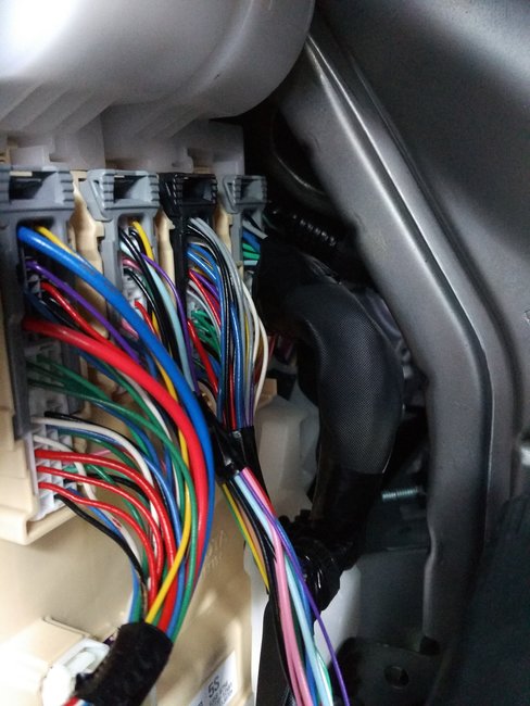

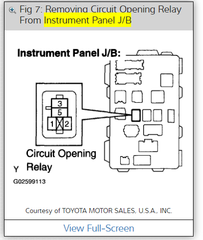

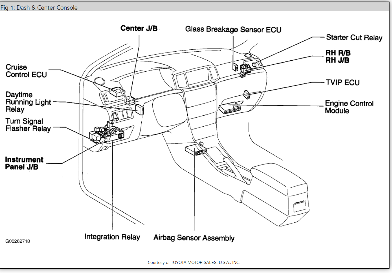

Where can I find the wires to power interior lighting? Thanks for help.
Nov 20, 2018 at 3:33 AM
JONNYB1963
  • 263 POSTS

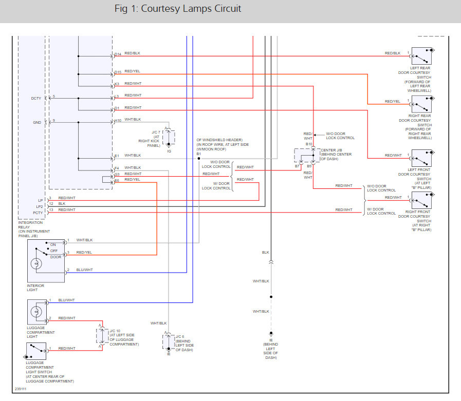

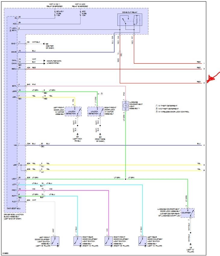

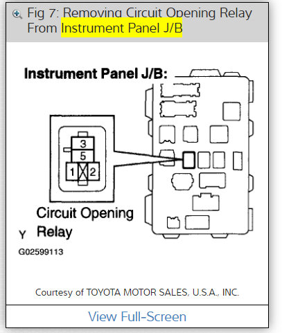

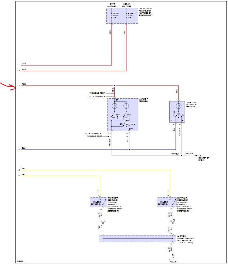

You will want to find the drivers side junction box under the dash panel on the drivers side.
See the attached wiring diagrams.
You will be looking for a red wire that comes from the dome cut relay. C42
You will want to splice into that circuit somewhere along that line.
Let me know if you need anything further.
Jon
Nov 20, 2018 at 5:17 AM

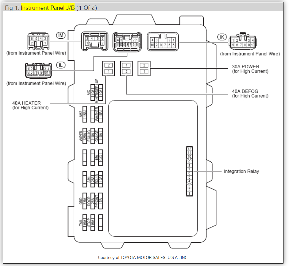

MISOM
Thanks for the information.

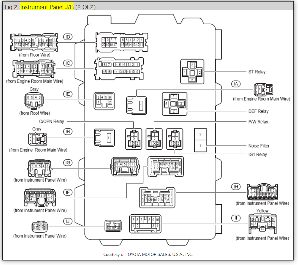

You probably thought this junction box (in the attachment). Do you have a description of the connectors (there is more than one red wire)? I cannot determine which is what you indicated in the wiring diagrams.
Michal
Nov 20, 2018 at 6:16 PM
  • 55,399 POSTS
Yep, that would be rough. I would test the red wires with a test light to see which one lights up with the dome lights. Here is a guide to help:

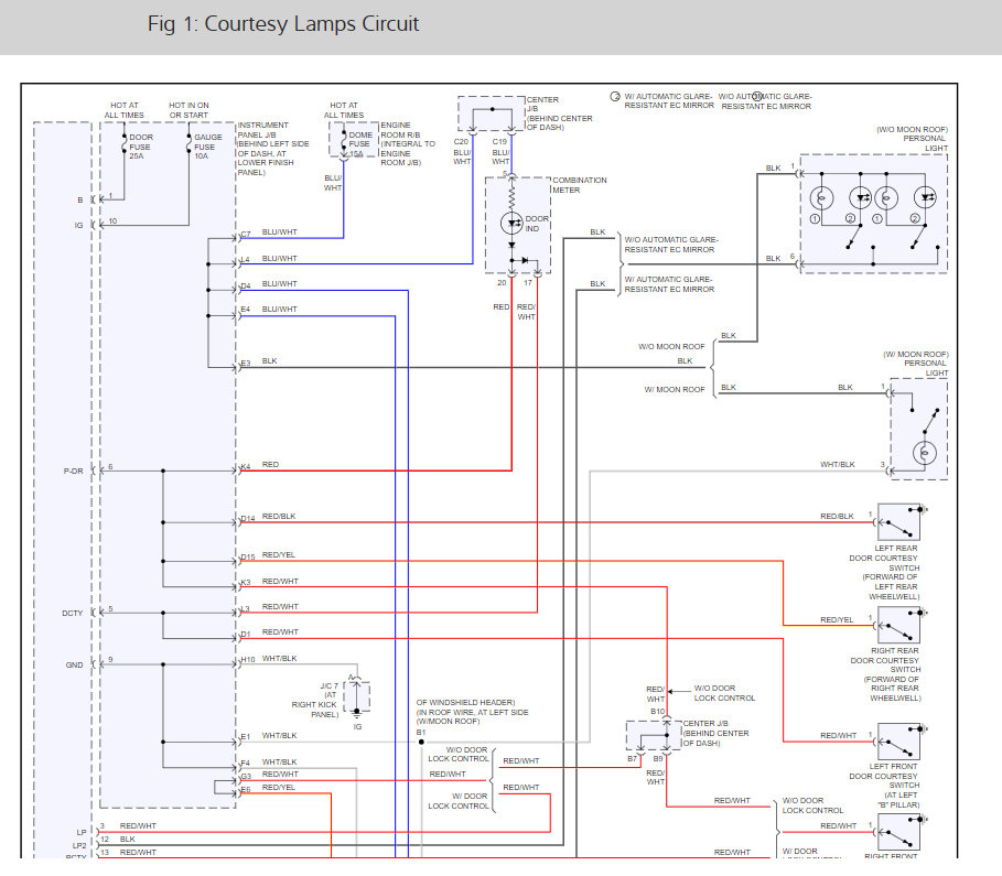

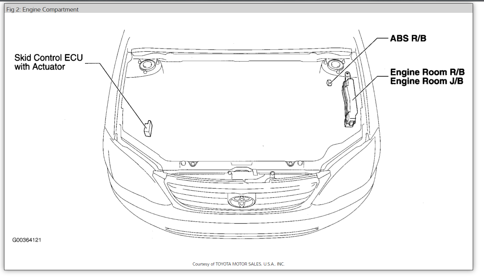

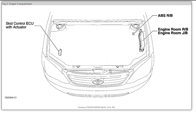

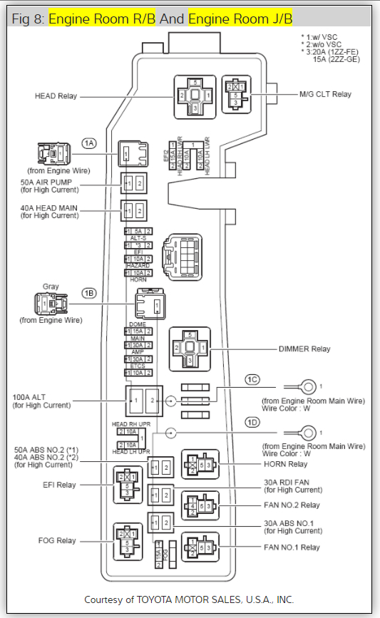

There is a dome fuse that needs to be checked int eh engine bay here is a guide to help test and the fuse location with the interior light lighting wiring diagrams so you can see how the system works.
Mar 6, 2021 at 3:05 AM (Merged)
PAYAT777
  • 0 POST
Nice post I replaced the fuse fixed it!
