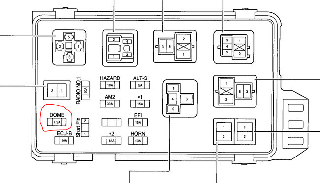

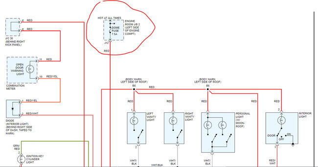

No light when open door or use remote.
Jan 8, 2020 at 12:41 PM
  • 110,194 POSTS
If none of the lights work, I suspect it's a fuse. Under the hood in the fuse junction box (left side) is where the dome light fuse is located. I attached a pic of the wiring schematic indicating the fuse and the second pic shows location. Check this and let me know what you find.
