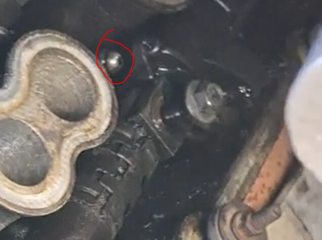

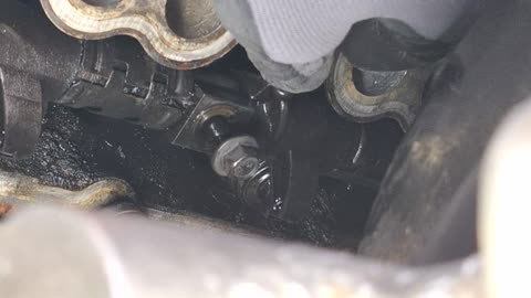

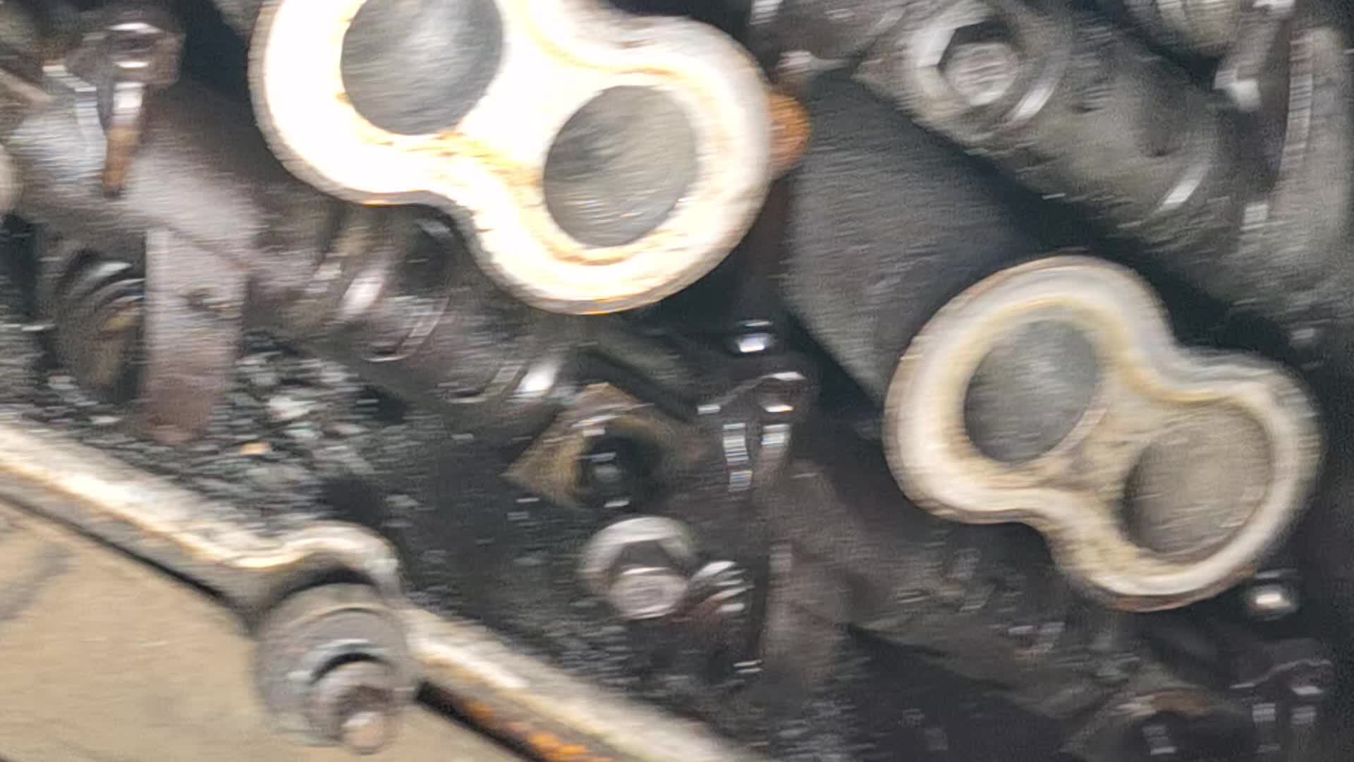

I got new valve springs so I can replace these. please watch video and if possible, please let me know what the issue is.
Mar 3, 2024 at 6:29 AM
  • 110,240 POSTS
Are you able to move the push rod (see pic below)? Also, no that is not normal. Either we have a bent/damaged pushrod or something is broken on the rocker arm. It's hard for me to see it.
If the pushrod is can be moved, inspect the valve to make sure it isn't stuck down.
See pic below.
Mar 3, 2024 at 8:43 AM
STEVEN GRIBBINS
  • 26 POSTS
The push rod can be moved and I'm going to blow air into the cylinder to see if valve moves because the valve spring is very tight.
Mar 3, 2024 at 10:10 AM
  • 110,240 POSTS
If the valve spring is collapsed and tight, it sounds like a bent valve. Let me know what you find.
