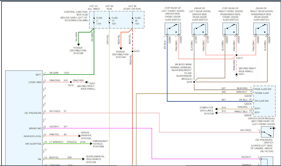

My cluster turns off and on at random. nothing works not even the diming lights turn on. none of my gauges work, but at random times it turns on. I changed my cluster but did the same thing, then I check the wiring harness that connected to the cluster and check it with the circuit tester some were good, notices one was flickering when I moved the harness.
Point is, I have no idea where to follow it and where it's connect to or even where to buy the whole harness itself.

Hello, I'm Danny.
Here is a tutorial for you to view on how to test wiring:

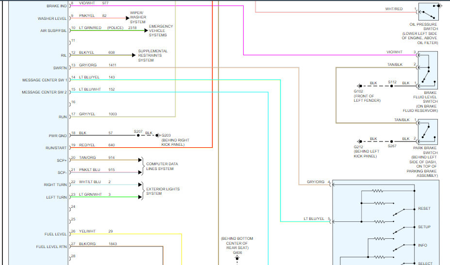

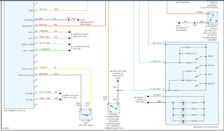

I've attached a wiring diagram for the instrument cluster below for your car for you. I've cut the picture into 3 pieces so you can view larger. Let us know what you find and keep us updated. Hope this helps and thanks for using 2CarPros.
