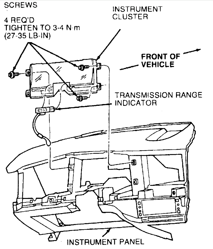

Odometer and trip mileage guages stopped working. Speedometer still does.
60,000 MILES • 4.6L • V8 • RWD • AUTOMATIC
BARBARA HATFIELD
What could it possible be? I have changed the vehicle speed sensor (vss) That didn't work. What else could it be?

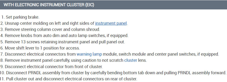

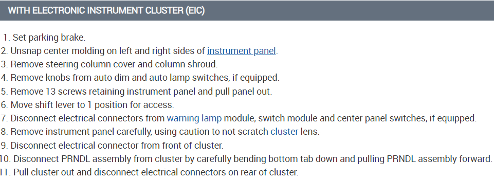

if speedo works and odometer doesn't it's either the speedo or the cluster is bad and needs to be rebuilt. You can get a used or rebuilt unit by searching google or ebay, here is how to change it out. Check out the images (below). Let us know how it goes
