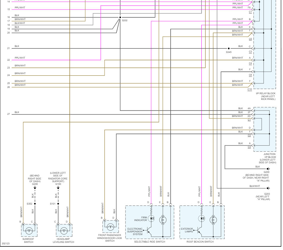

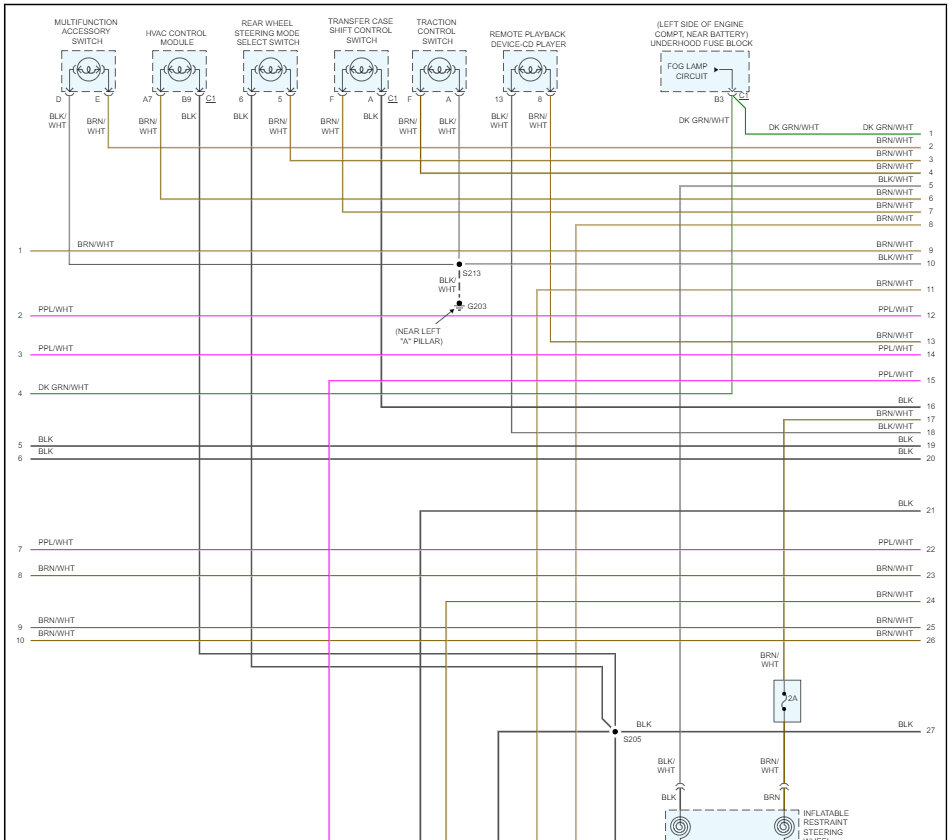

My instrument cluster lights work great at night and the dimmer works great as well; everything works as it should, but during daytime, the instrument cluster lights won't work at all, and I can't see my cluster. The odometer and everything on the LCD readout works fine and I can see that.
I just can't see my gauges during daytime.
Please help. What is wrong?
Aug 17, 2023 at 1:17 PM
  • 55,065 POSTS

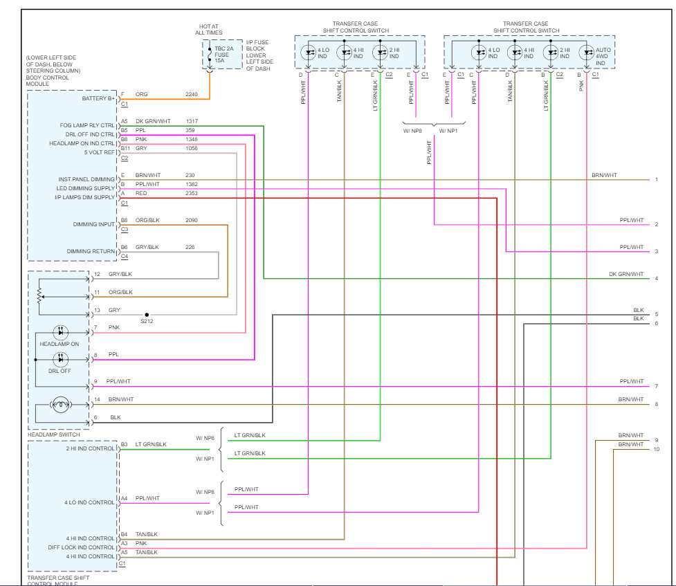

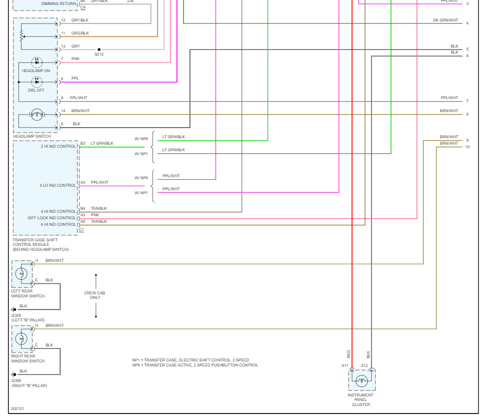

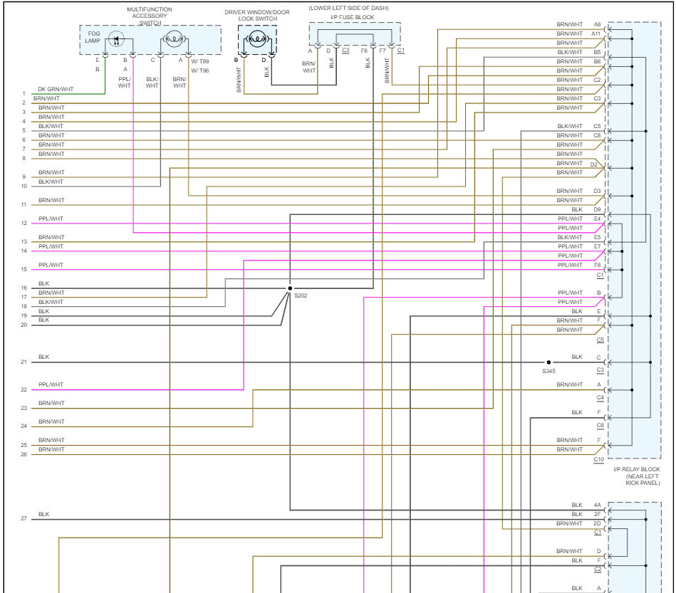

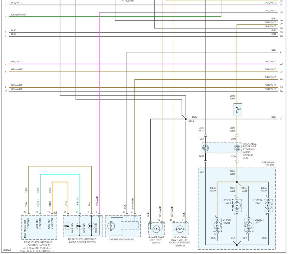

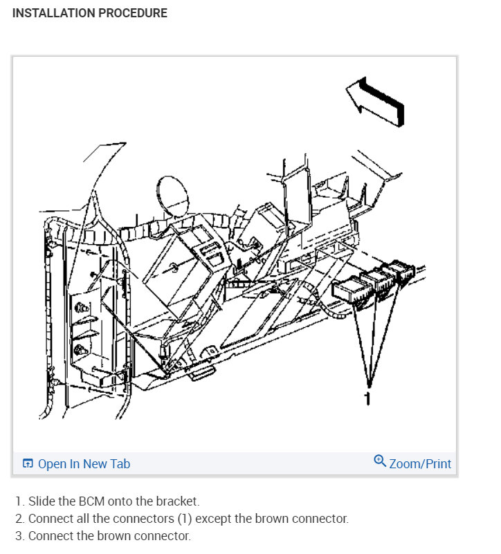

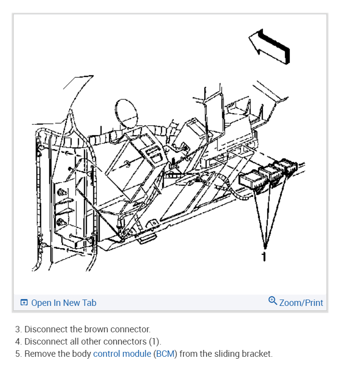

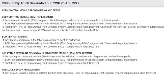

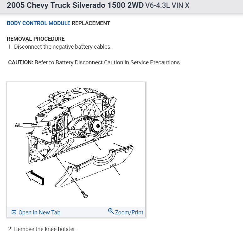

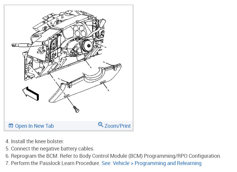

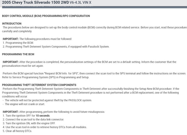

First, we need to check the fuse TBC 2A in the fuse panel on the left side of the dash. This guide can help:

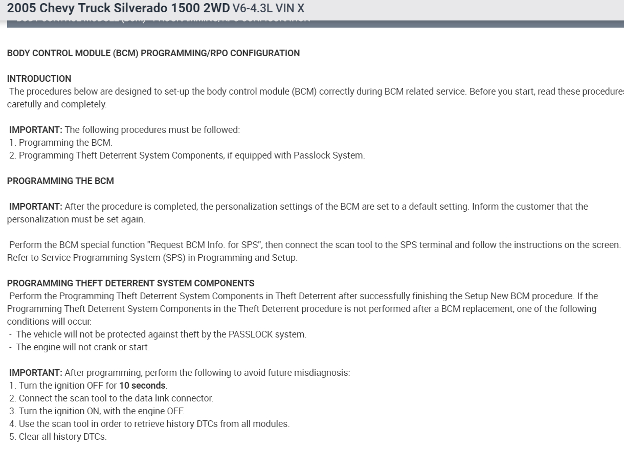

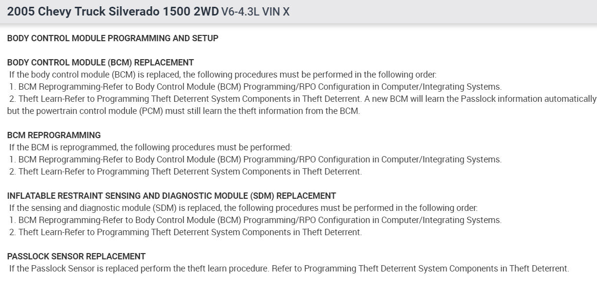

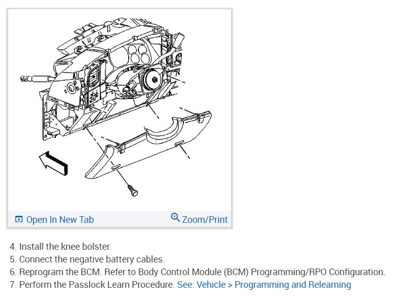

If the fuse is okay, it sounds like the BCM is out but to be sure we should do a CAN scan. You can get a CAN scanner (Controller Area Network) which will work on most cars from Amazon.
https://youtu.be/u-4syLc-ifQ

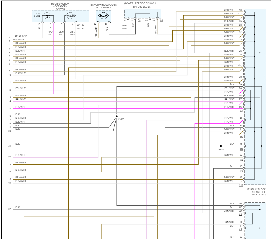

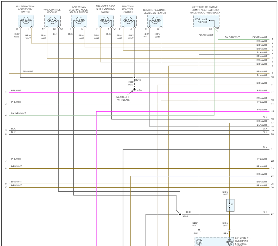

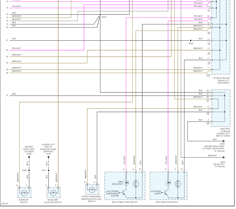

Here are the instrument cluster wiring diagrams so you can see how the system works and how to swap out the BCM, you can get a preprogrammed unit by searching Google or Ebay. Check out the images (below). Please let us know what happens.
