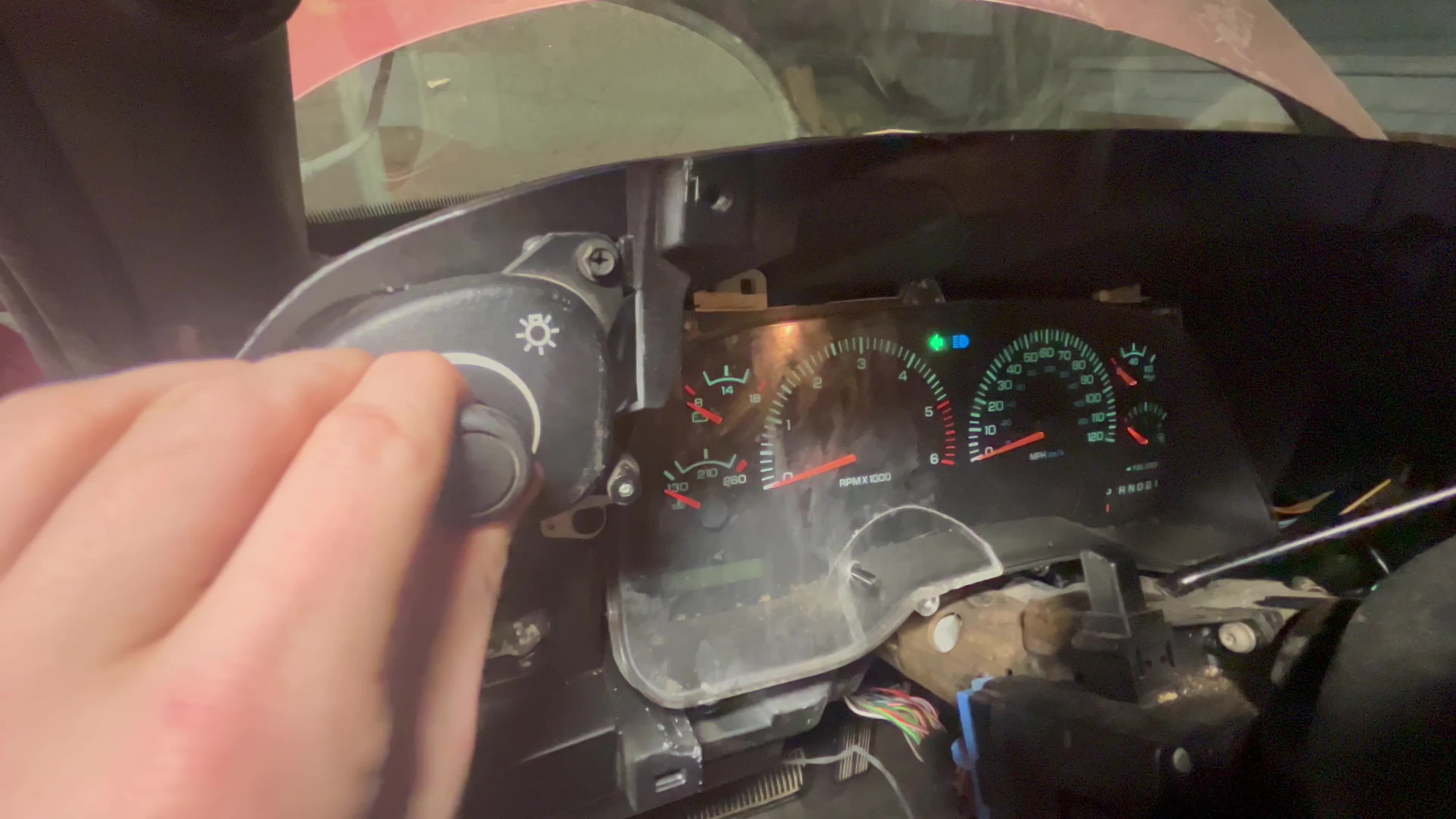

Recently installed a new dash shell and I’ve gotten everything wired back in but now the instrument cluster is giving me issues all the gages won’t respond and no matter what the left turn signal light and bright icons stay bright any ideas?

Do you mean you installed a cluster or the entire dash assembly? What wiring did you use? What year is the housing from?

It’s the same cluster and same wiring. I just put a new dash assembly in since the last one was cracked. I haven’t changed any of the wiring that’s what’s confusing me on what’s going wrong

To me, it looks like one of the dash ground wires is not connected. Do you remove any ground wires when you were doing the work?

I would check the fuses as well, here is a wiring diagram to show the grounds and the fuses you should check as well.

Reconnect any dash ground wires that may have been left off during the dash shell swap, and check the related instrument-cluster fuses.
