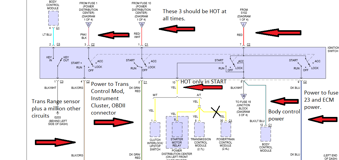

Okay, we are just going to have to jump back and forth a bit. Fuse number twenty three should be Hot with Key in RUN or START. This power from the ignition switch to the ECM, Fuel pump relay and one other circuit. We may have to go by the VIN number tomorrow, so I can see exactly which model I am looking at here. It seems they changed some of the ECM harness with this production change.

I did a little more research here, I am thinking you may want to have a look behind these fuse panels, both, the one under the driver side dash and the one under the hood if you are up to it. They can get corroded underneath and we need to find why that fuse blew. Check for loose harness plugs under the dash as well, this can be a problem on this vehicle.
We also need to make sure the ignition switch is sending power to the ECM in RUN an START position. So to start with I am sending some diagrams of the ignition switch and what wires to check for power at certain key positions. This should not be too difficult, I am labeling everything for you.

Well we have discovered the answer but the mystery deepens. There was no fuse in number twenty three. I put a new fuse in and everything works perfectly. I was meticulous in my removal and installation of the fuses. I have no idea how or why that fuse would be missing. How would someone be so that savvy to remove it? How did the other one blow? This is insane. All I can say is thank you for your help.

Well that is extremely strange to say the least, If you did not remove it, then I do not know what happened. I just know it powers everything important. Sorry our diagnosis took so long, but that would explain why for sure. Did you get the right size fuse in there I hope? It protects the ECM on the ignition circuit, so it has to be the right amp size. Glad everything worked out good. Took a few days but we figured it out anyway.

Number twenty three fuse should be twenty amp.
