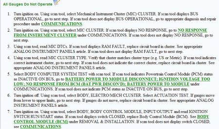

My car would not start and was towed in. The mechanic said the distributor went out. My husband replaced it and did a turn up. Now the instrument panel doesn't work. It is lit up but none of the gauges work. Also it acts like it want change gears from 3rd(its an automatic). Any suggestions?

Sorry for the bad news, but it's either the body control module, or the circuit board in the instrument cluster, only way to tell is wth the DRBII chrysler scanner...
https://images.2carpros.com/forum/automotive_pictures/62217_bcm_1.jpg
