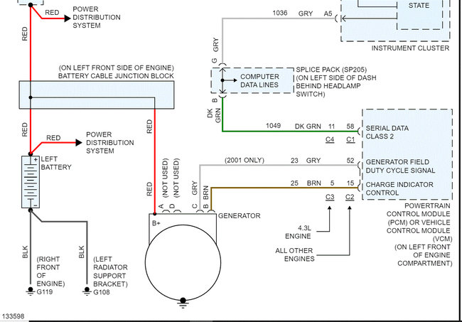

The instrument clusters in the GM trucks during this time period are known to fail and need to be rebuilt. What you described sounds like that is the case. The solder joints fail internally on the printed circuit boards. As a result, the gauges act a bit crazy.

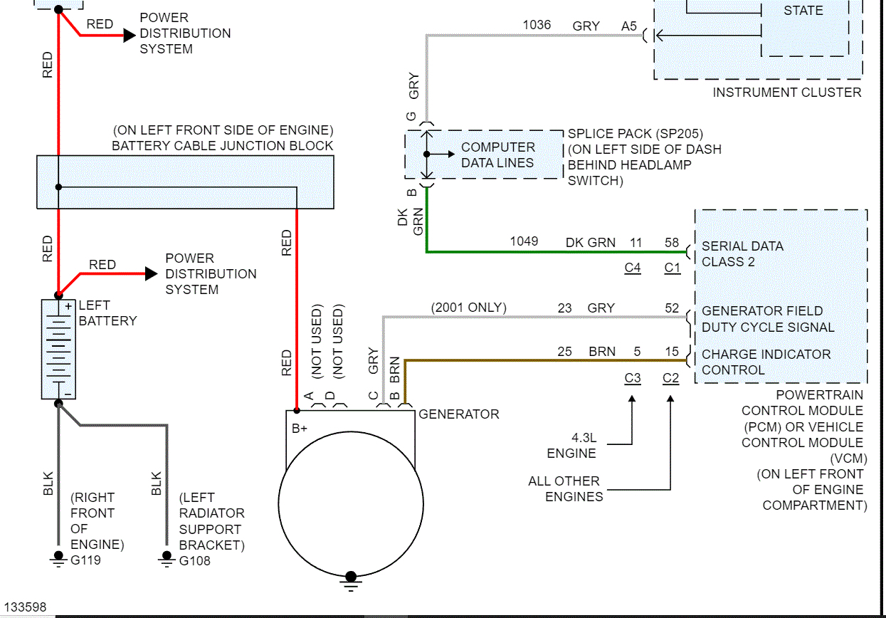

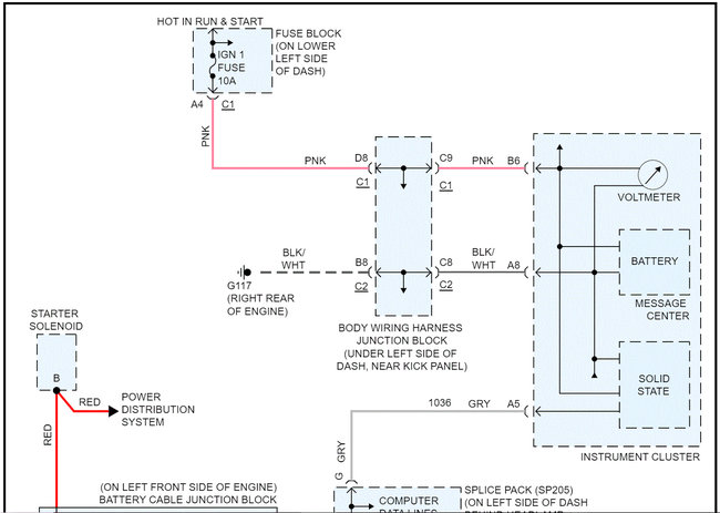

As far as the charging, I attached the wiring schematic below for the charging circuits. Take a look through them.
Also, let me know how you determine the alternator is producing.
I will watch for your reply.

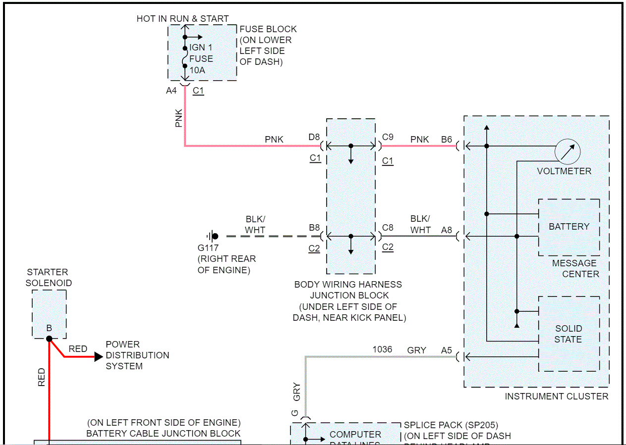

See pics below. Note: I had to cut the schematic in half to make it readable. I did overlap them so you can follow from one to the next.

I was just going off the intermittent instrument cluster to determine if the truck was charging. When the gauges are acting normal the volt gauge does show charging and the message center is blank.
I'll use a multi meter to verify the alternator is in fact charging the battery.

Used the diagrams you provided and determined pin A8 (ground) going to the instrument cluster now has 1 OHM short to the metal in steering column, key switch, and door nuts. This was after cleaning the firewall ground location. So, I don't know what it was before.
The headlight switch from the blazer wouldn't work as a donor. Since blazer switch was made with a place for fog lights. Which the Sierra doesn't have. So, I took the existing switch out of Sierra, disassembled, stretched a little spring for the contacts. I applied some more dielectric grease and reassembled. Switch works as it should.
Using multi-meter, determined the battery had 11.98 DC volts. (Was playing radio while working on it) Started truck and gauges worked as they should. Message center was blank. Just had a service engine soon light on. So, I still need to get the codes read.
With the engine idle and at 1,500 RPMs, alternator was putting 14.25 DC volts at battery with headlights, blower, and radio on. Switched meter over to AC and had 0.33 AC volts at battery at 1000 RPM.
