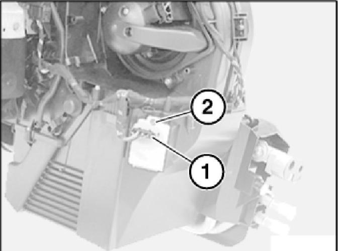

I have a 2002 Mini Cooper S (John Cooper Edition)
Last 7 of vin# TD56071
Diagrams, do not show actual location of part, or what parts come off prior to the resistor to gain access to the part.
There are 2 different resistors listed for this car, based on your car having, or not having, the << Auto-Air/Climate Control feature.>>
AutoAir - YES
PART # 64111499122 (( (parts diagram Photo included )))
I need a step by step service manual DIY guide explaining the following;
A.) The location of the A/C Blower motor resistor
B.) What parts need to be removed to be able to access the part to complete the repair.
Show me the accuracy, speed, & user friendly, your service is this first time,
And I will gladly use the donation button and pay you for assistance me with the 8-10 other repairs I need to make on this car.
Thanks,
Gary

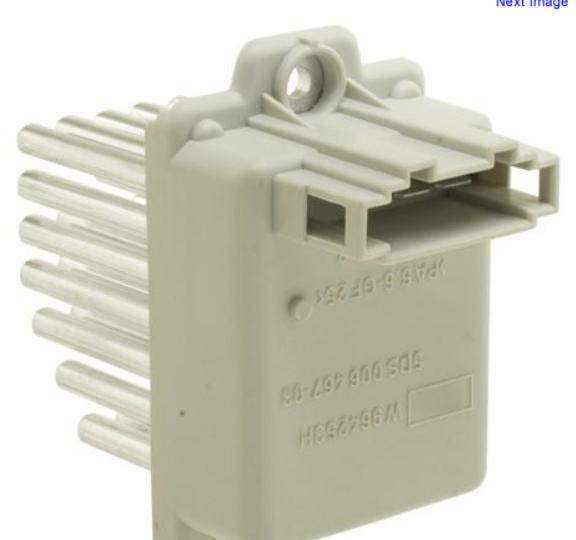

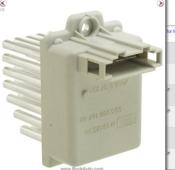

It's under the dash on the passenger side, held in by one screw. https://www.2carpros.com/images/external/101683251.jpg

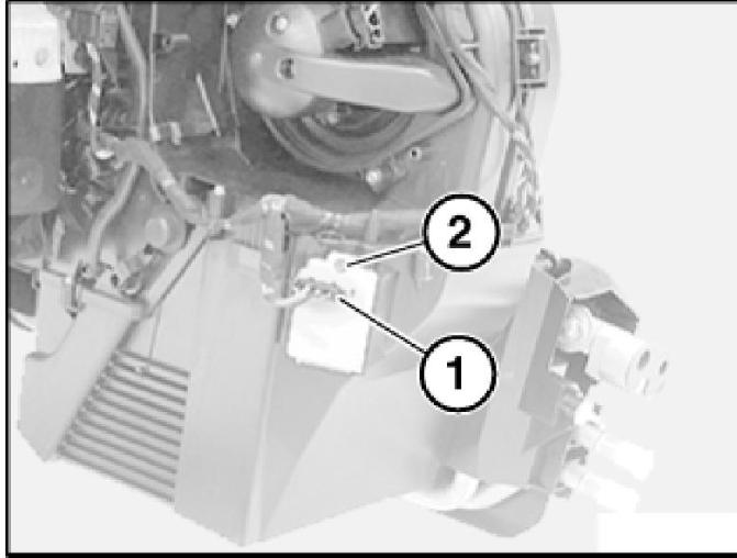

If you will go back and read my question carefully, you will notice I included a photo of a parts Diagram. I also included the part number for the ("CORRECT") part. Part # -----> 64111499122
There are 2 options for 2 very different parts, that go in totally different locations for this repair based on the car having, or not having the ( AUTO-AIR ) Feature/Function.
The photo you provided me back, is of the other part # 64111499121 blower motor resistor WITHOUT the "AUTO-AIR "FEATURE/FUNCTION.
I need the instructions for part number# 64111499122
<<<<< PLEASE NOTE: in the photo of the parts Diagram, it shows part # 2 going there to the left, on the evap wall, either it goes there but, it is somehow located over or on the inside of the evap wall, or it is just showing the part in the wrong location all together. In several photos I have found, they all Say: part goes Here, with a arrow pointing to behind a, 3prong male 2 female plug, the plug is mounted to the evap wall with wires running over the top of the evap wall.

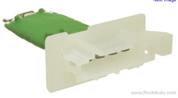

With auto temp control the resister is replaced by a blower speed control module which this manufacturer calls a "Blower output stage". When you ask for a resistor, that's what you get.. Here is the component you are looking for. https://www.2carpros.com/images/external/125396843.jpg

I have given you factory supplied pictures of both types of blower speed control for your exact vehicle. There are no pictures of yours showing up here either.

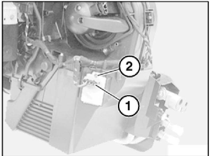

.64 11 222 Replacing resistor for heater - A/C fan (IHKA)
NOTE:For purposes of clarity, illustration shows heater/air conditioner removed.
The resistor for the heater - A/C fan is located in the right footwell.
Unfasten plug connection (1) and disconnect.
Release screw (2).
Remove resistor for heater - A/C fan.
Fig. 13: Removing Plug Connection
Courtesy of BMW OF NORTH AMERICA, INC
Jan 7, 2019 at 9:32 AM (Merged)

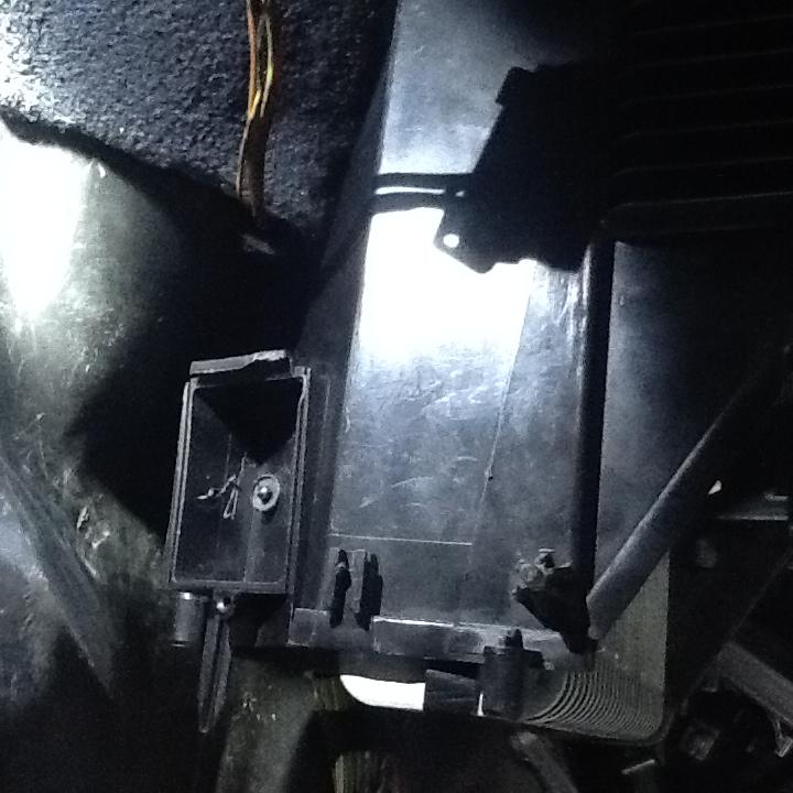

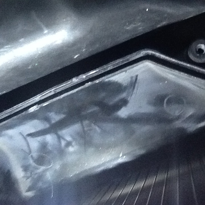

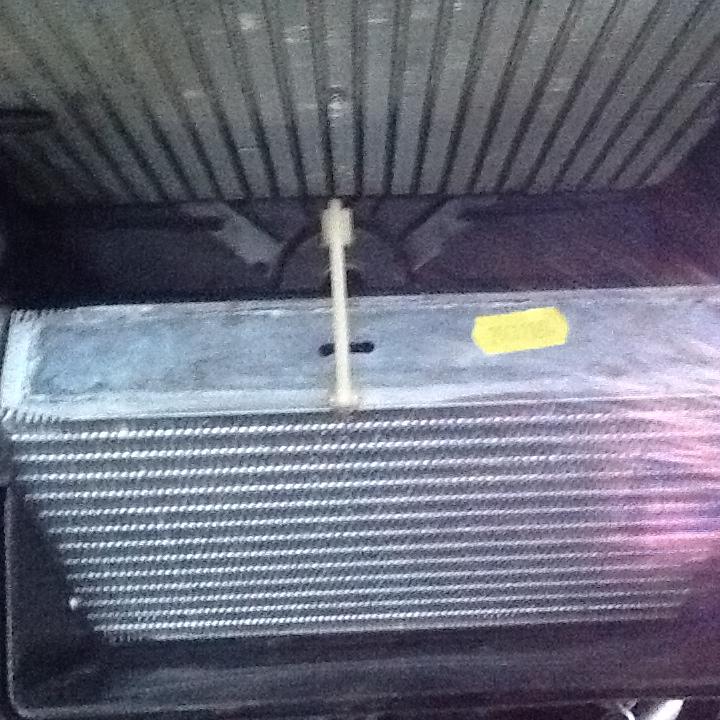

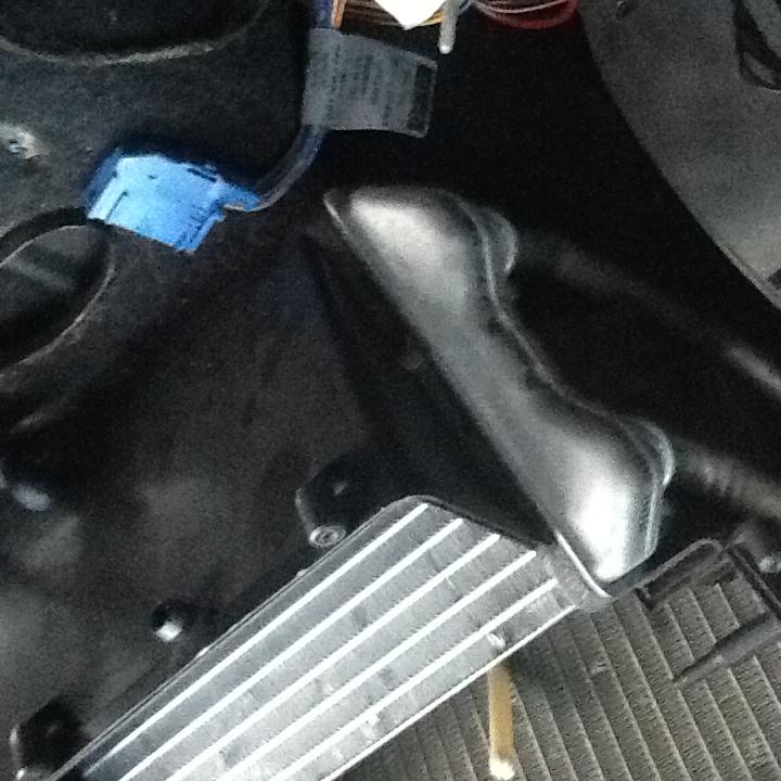

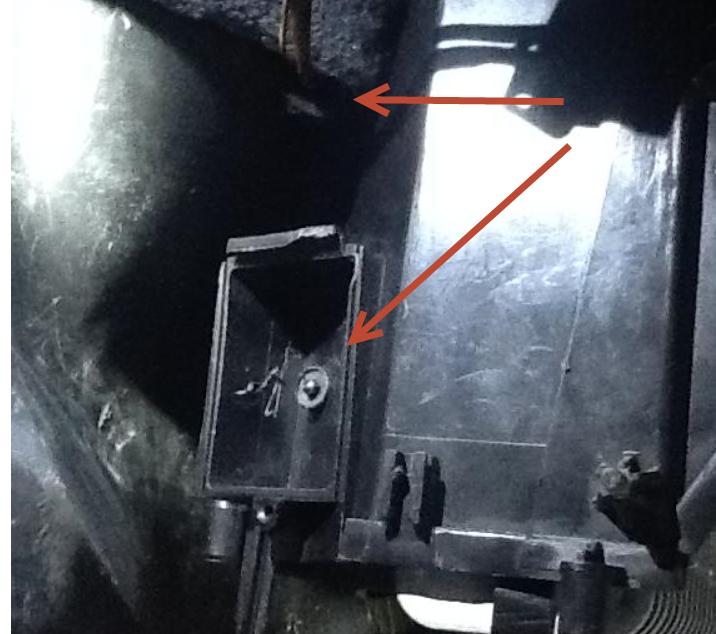

Here are some photos of the heater A/C housing box totally disassembled down to the base.
In the photos I took, they are:
Photo -#1 is the right footwell location that the parts diagram shows as where the part shows to be mounted. But, as you can see from the photo, it clearly is not there.
Photo-#2 is from above looking down into the base of the heater housing box.
Photo-#3 is looking down into the empty cavity where the part would be seated, from inside, on the right side is where the part would be protruding through the wall. If the part was where the diagram shows it should be located, you would see all the long silver prong post over on the right side of the photo.
Photo-#4 is a view of the left side or drivers side of the heater housing box.
Any other possible location you might come up with would be something to look at.

1KONGFISH
  • 12 POSTS
I sent some photos of the area where your parts diagrams show the part to be, as you can see in the photos I included in my previous email, the part is not where the parts diagrams show it should be. Any further information on this problem locating exactly where this part is mounted let me know,

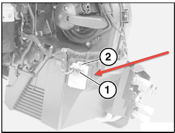

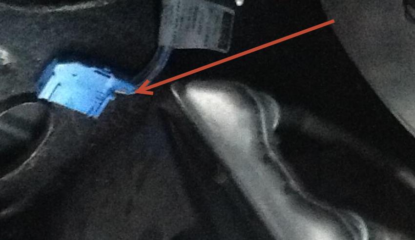

looking at the pic i'd bet it goes to where I have thearrows to and the harness is supposed toplug into it. both have an arrow to them. also in second pic it looks like an empty harness unless it goes to something else. as I said in last reply the resistor may be in the right footwell as our manual shows it there for auto temp control.
HMAC300
  • 48,601 POSTS
the one pic look s like a resistor may go there but is missing....... sorry got the wrongpic. insecond one.

Gary, did you ever get to the bottom of this. If have exactly the same issue with a 2002 mini with auto-air con. Fan is on full or off. The levels of speed have no effect.
I've got exactly the same blanking plate where i expected to see the hedgehog resistor.

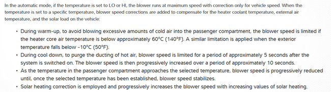

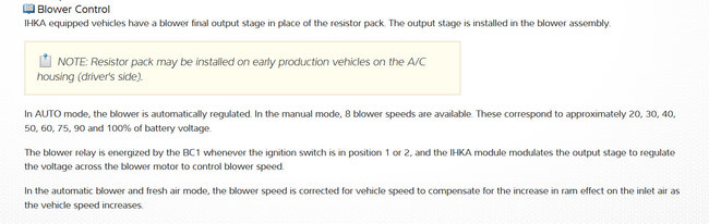

ok after reading this about this specific a/c system it looks like there were SOME models with a resistor and others that it is part of the blower motor from what I can understand. see pics for description. Because when I look at rock auto the square pic is of the resistor which clearly you do not have so I am suspecting it's part of blower. when that specific number is punched into rock auto search engine the resistor is the one that is coming up with as replacement. it also shows same thing for 2003. Before you pull any more hair out or bomb the car, check with a mini dealer and see what they come up with. Unless you already have it may be necessary to take your vin number with you. see pics
RAGTP66
I think the piece to your puzzle that your missing is there is the "early version" 2002 to roughly 03/2003 build dates and then the later 03+. If you look here you will see the cutoff date for the blower motor: https://www.bmwminipartssource.com/oem-parts/mini-blower-motor-67326901862
The early cars were a 3 pole blower motor and the later cars went to a 2 pole motor. I could be wrong but I think on the early cars the resistor is incorporated into the blower motor. Which would probably explain its ReDICKulous price. I have also found some sources that say it is located on the passenger side footwell attached to the SIDE of the case up close to the firewall, I have also seen it listed on the drivers side almost facing towards the firewall.
