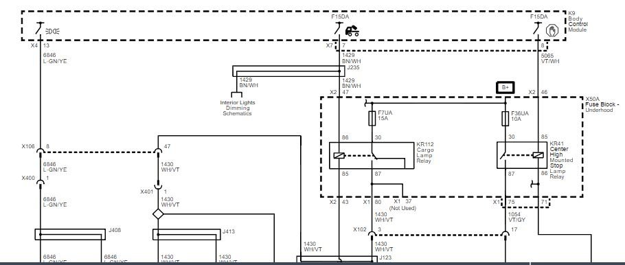

installing light bar
2018 CHEVROLET COLORADO
15,000 MILES
LILLICOTCH

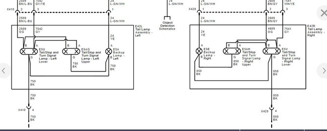

don't know what colors mean on wiring harness.
I have green, yellow, red, black, brown, blue, and white.
On the light bar I only have four which are green for right turn, yellow for left turn, white is the ground and brown is the running lights.
I think yellow goes to yellow.
Green goes to green.
White goes to black.
I don't know where brown goes.
Mar 4, 2019 at 2:45 AM
  • 110,244 POSTS

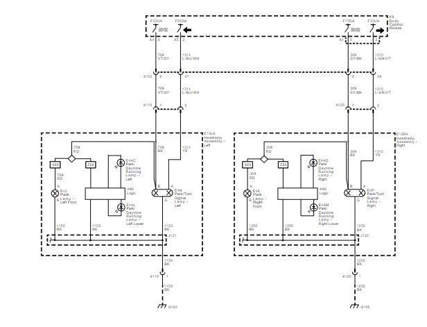

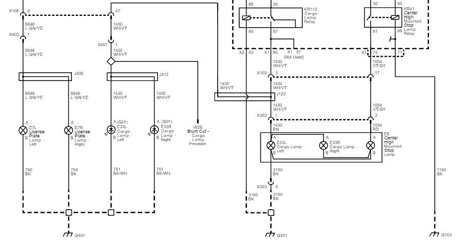

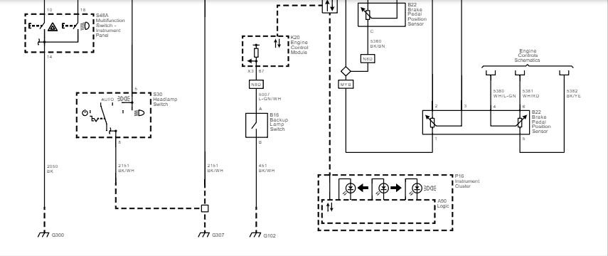

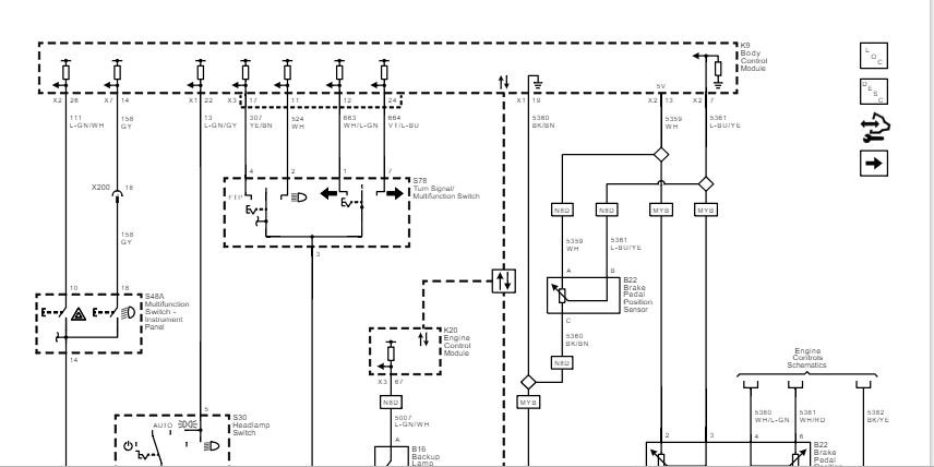

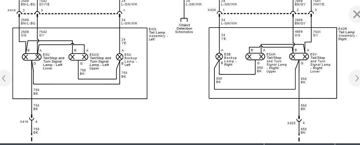

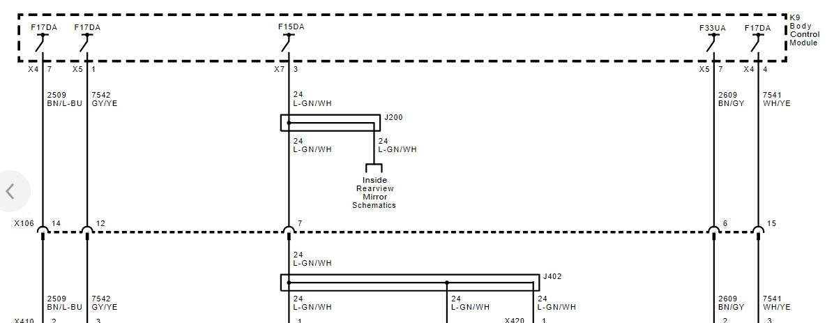

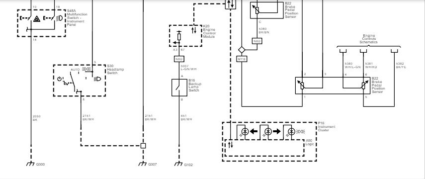

Before you do anything, lets make sure we know what you are attaching to. The first thing I need to know is what part of the vehicle you have found the wires you are referring to. On a schematic, wire colors can change from one point to another and still be part of the same circuit. I have attached all of the lighting/wiring schematics for the exterior of the vehicle. Some of the schematics had to be cut in two so I could fit them. They will follow each other and I overlapped them so you could follow them.
Take a look at these schematics. I picked a 4wd with the 2.5L engine. You didn't list one. If that is incorrect, let me know and I will review others to check for differences.
Let me know if this helps. Also, when you start looking for power wires, use a test light or multi meter to determine if you have the correct wire.
