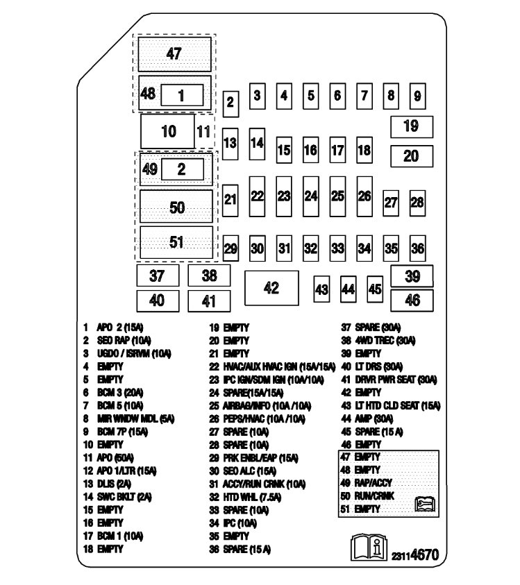

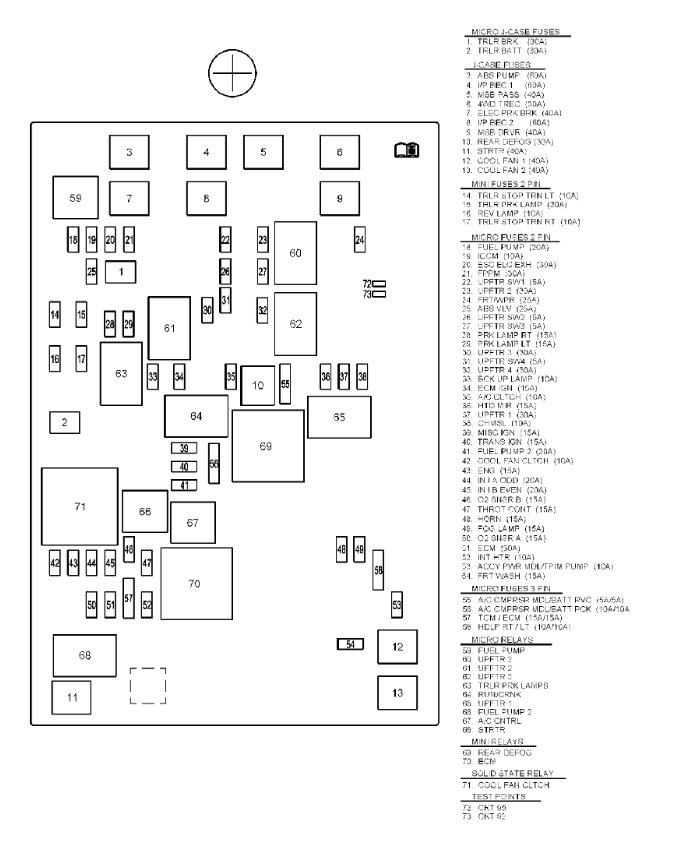

My blower motor is not working why?
2014 CHEVROLET SILVERADO
114,000 MILES • 5.3L • V8 • 4WD • AUTOMATIC
JORYPEYTON

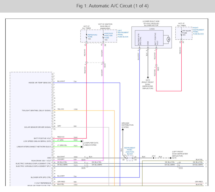

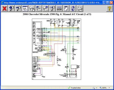

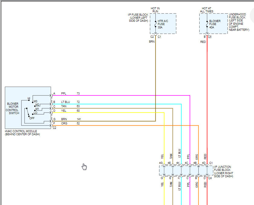

Dealership said the blower motor is bad but I installed a new blower motor but it doesn't work either?
Aug 1, 2020 at 9:39 AM

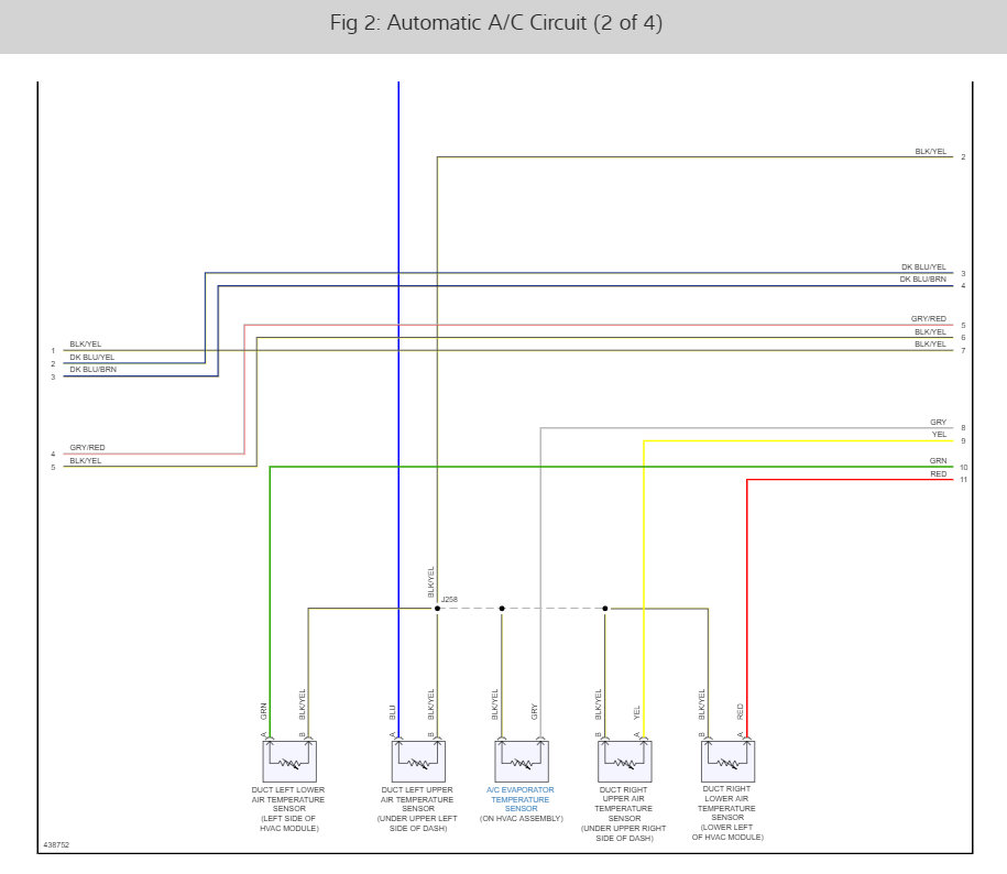

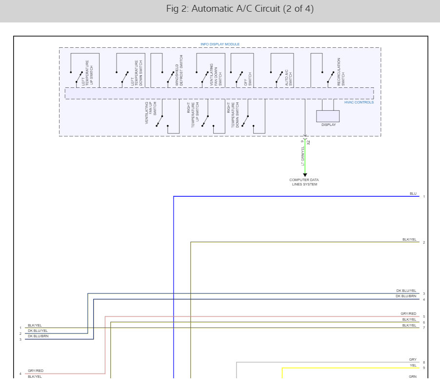

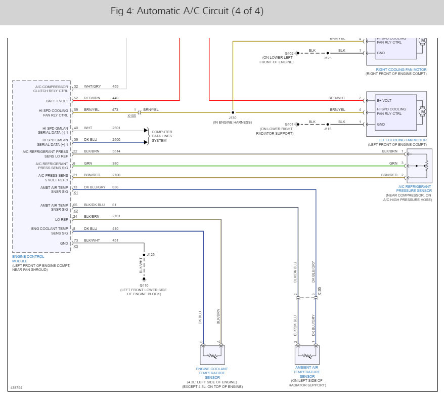

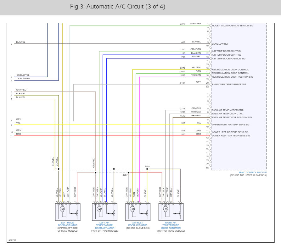

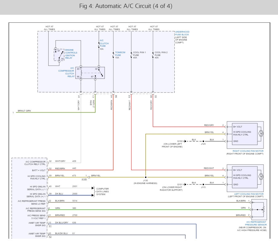

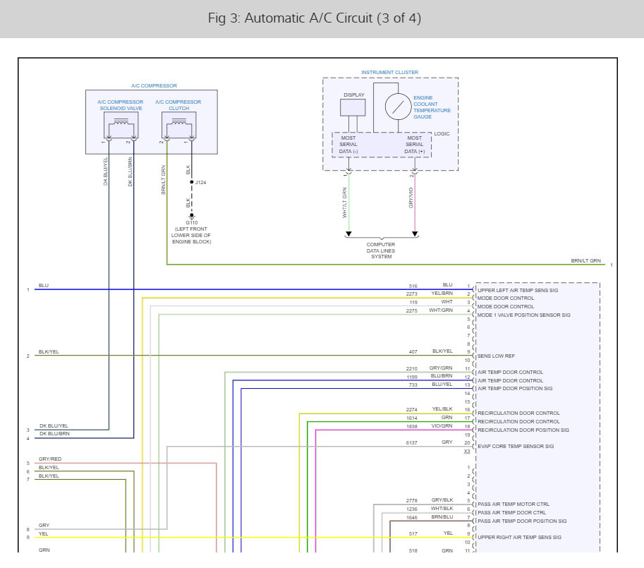

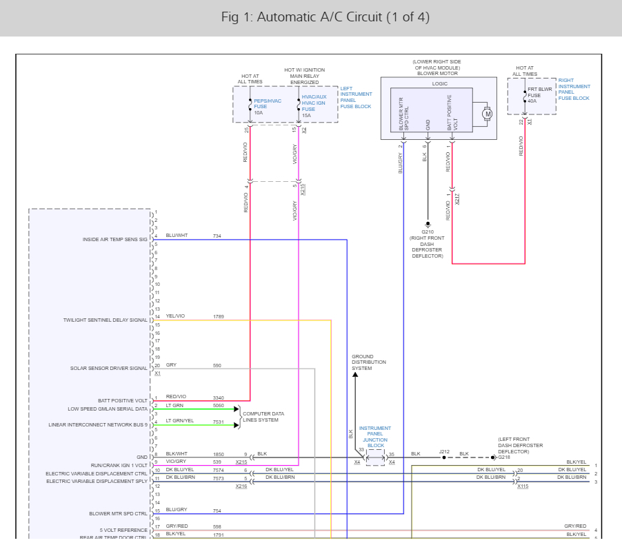

it sounds like the main blower fuse ( frt blwr fuse #40) is out but to be sure lets run down this guide which shows how to check for power and ground at the motor. I have included the fuse location and a guide on how to check it in the diagrams below.
https://www.2carpros.com/articles/blower-fan-motor-works-on-high-speed-only
and
Here is a wiring diagrams so you can see how the system works as well. Check out the diagrams (Below). Let us know what happens and please upload pictures or videos of the problem.
Aug 3, 2020 at 12:14 AM

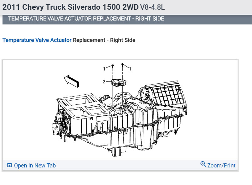

I noticed my heater fan making a squeaking screeching noise on high then it stops working? Also my defrost doesn’t work on passenger side.
Apr 30, 2021 at 7:19 AM (Merged)
  • 55,214 POSTS
You have to problem the first is the noise and blower motor operation which you will need to replace the blower motor for and the passengers side blend door actuator for the air flow issue. Here are two guides to help walk you you through the repair with diagrams below to show you how on your car:

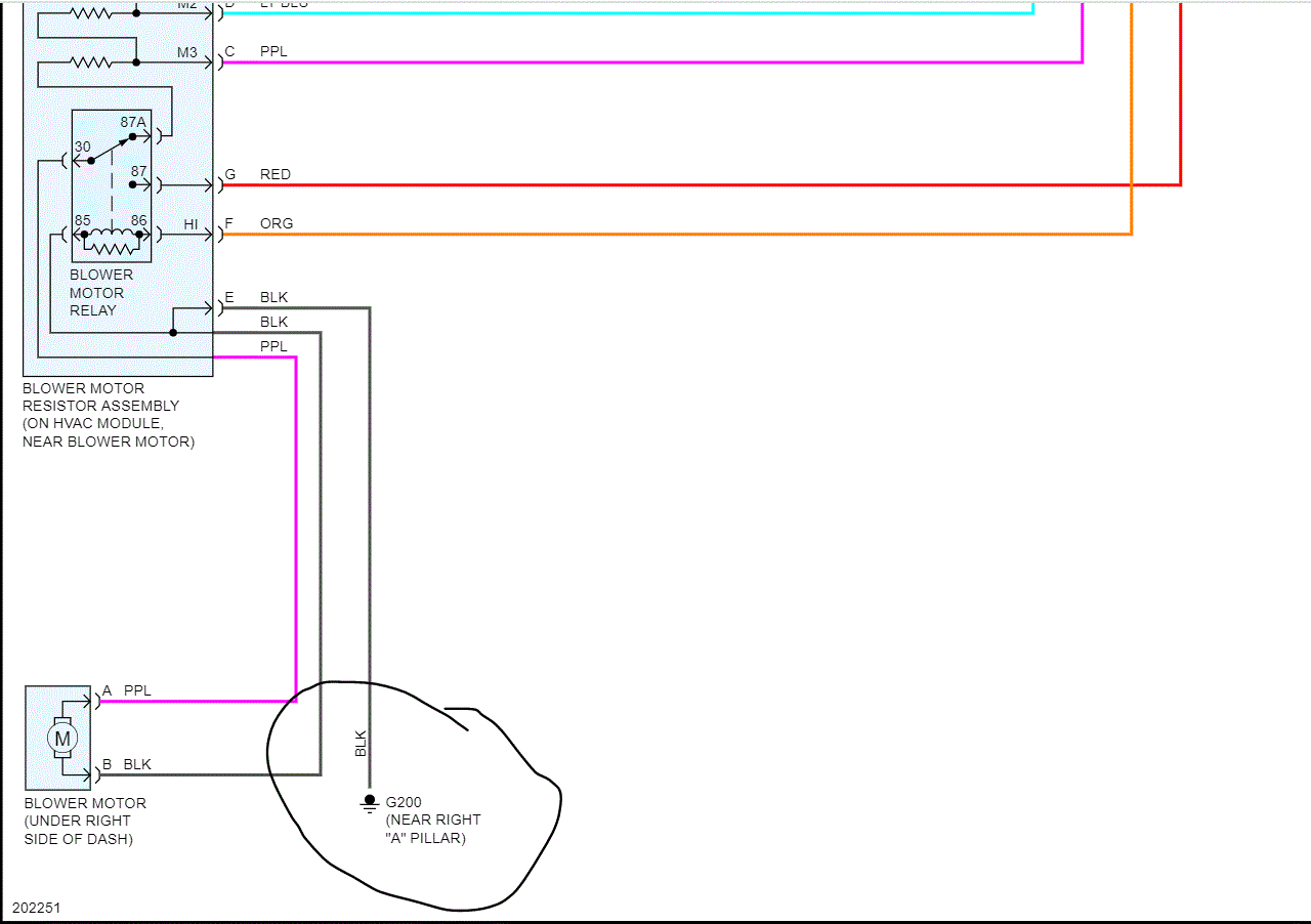

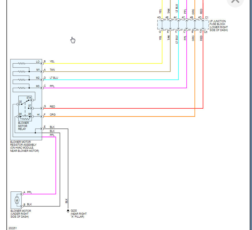

I replaced the blower motor, blower motor resistor, and A/C climate controls. I checked the power and ground wire and I have power in both wires so there is no ground.
Apr 30, 2021 at 7:20 AM (Merged)
  • 110,240 POSTS

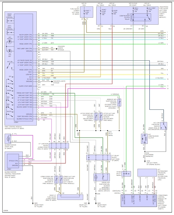

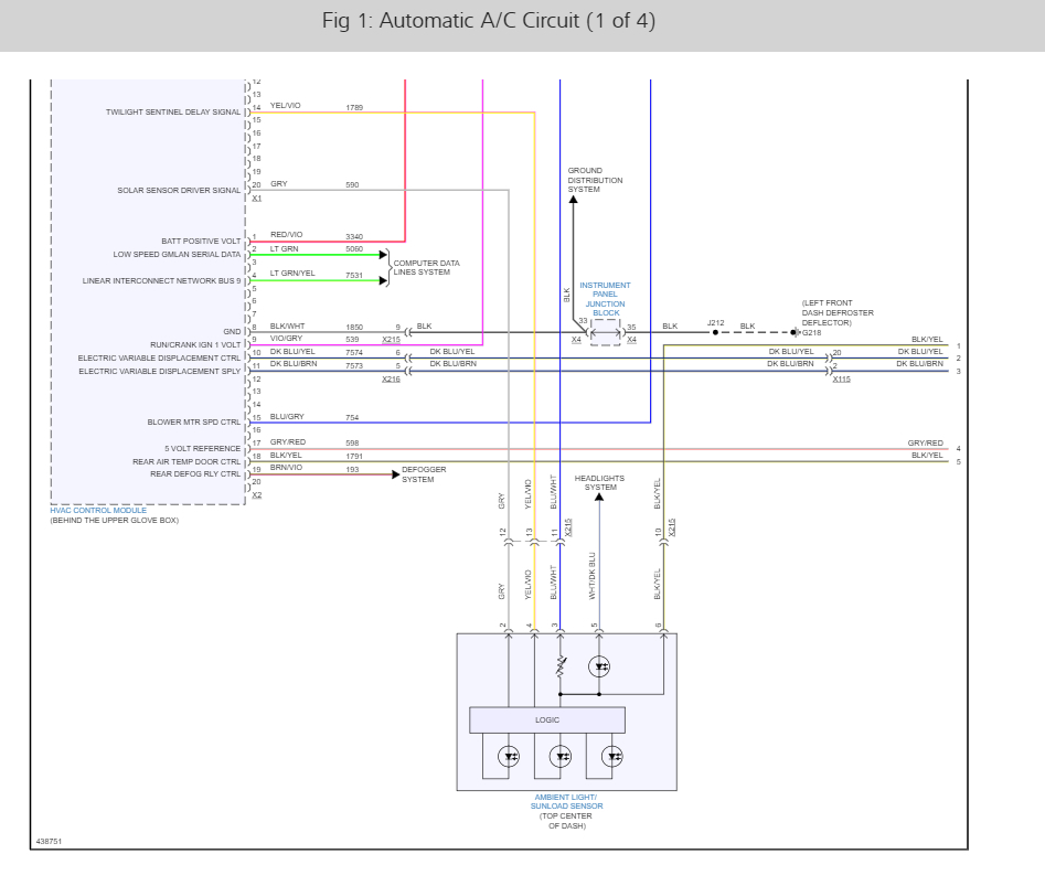

From the blower motor resister, there are two black wires. They are grounds. One will go to the blower motor and the other goes near the right side A pillar.
This guide will help with diagrams below
I attached a pic of the wiring schematic below. Let me know if this helps or if you have other questions.
OSWALD_ZRT
The connection looks good what should I do?
  • 110,240 POSTS
I need you to check for continuity to ground between the black wires at the connector and a known good ground on the vehicle. You will need a multi meter. Basically, set it to ohms and check to see if continuity exists. What you are doing is basically making sure the wire has no breaks in it and that power flows through it and is grounded to the vehicle body.
Check the black wire that goes to the A pillar first. If that ground isn't good, then the other one won't be either. The one that goes to the A pillar and is bolted to the body is the actual grounding point.
OSWALD_ZRT
Can that cut be causing it?
  • 110,240 POSTS
Are you referring to the connector itself or is there a cut in the wiring? If it is the connector, chances are the color difference isn't causing a problem.
Was there continuity to ground?

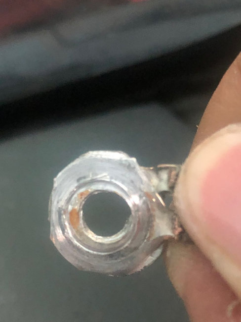

OSWALD_ZRT
The connector is broken for one of the grounds which i'm thinking its the HVAC ground wire because it's the only one that is not working. I grounded it separate from the other ground, now it is working thank you.

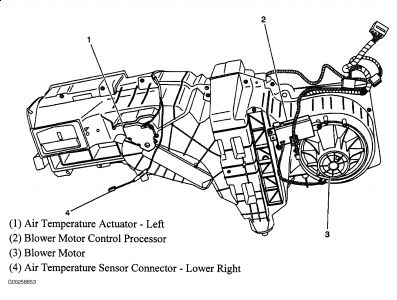

My blower was working on 1,2 ,3 and 4, not 5, now it's not working at all. What could be the problem?
Apr 30, 2021 at 7:21 AM (Merged)
OBXAUTOMEDIC
  • 3,711 POSTS
Hello, The most likely cause is the Blower Motor Control Processor...

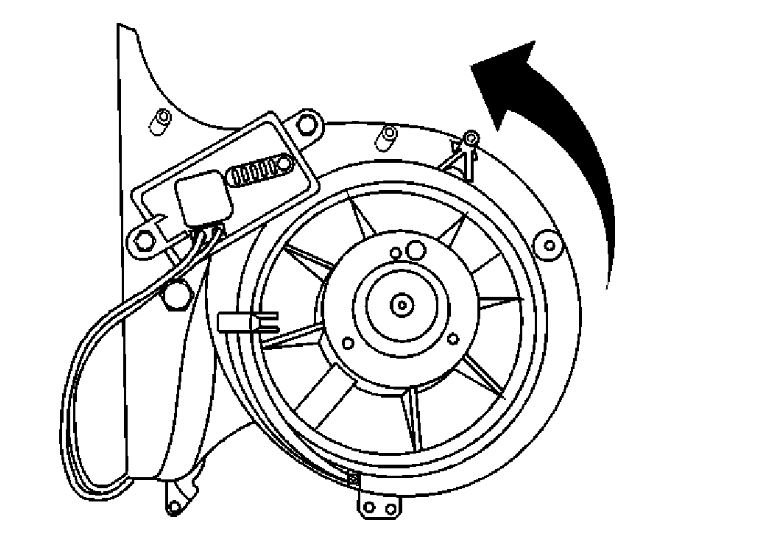

LEGITIMATE007
  • 5,121 POSTS

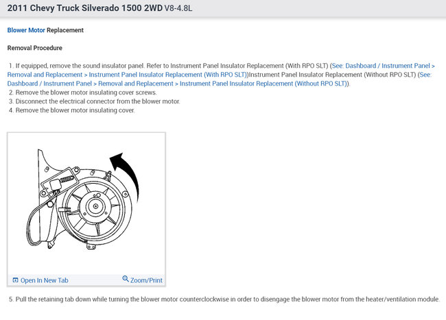

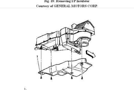

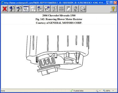

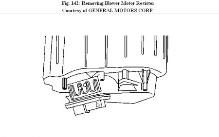

its behind the instrument panel inside the blower motor housing, you'll need a test light and check each of the slots in the resistor(heres a pic) with the ignition key in the on position and the test light on a good ground, you'll test each slot as you are putting the switch on each speed.
https://images.2carpros.com/forum/automotive_pictures/88091_ScreenHunter_02_Nov_10_2321_1.jpg
LEGITIMATE007
  • 5,121 POSTS
this is the instrument panel insulator that you will have to remove first
https://images.2carpros.com/forum/automotive_pictures/88091_ScreenHunter_03_Nov_10_2347_1.jpg

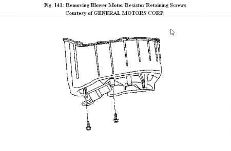

LEGITIMATE007
  • 5,121 POSTS

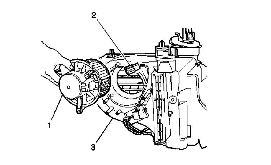

blower motor resistor retaining screws
https://images.2carpros.com/forum/automotive_pictures/88091_ScreenHunter_04_Nov_10_2351_1.jpg
LEGITIMATE007
  • 5,121 POSTS
removing blower motor resistor
https://images.2carpros.com/forum/automotive_pictures/88091_ScreenHunter_05_Nov_10_2353_1.jpg

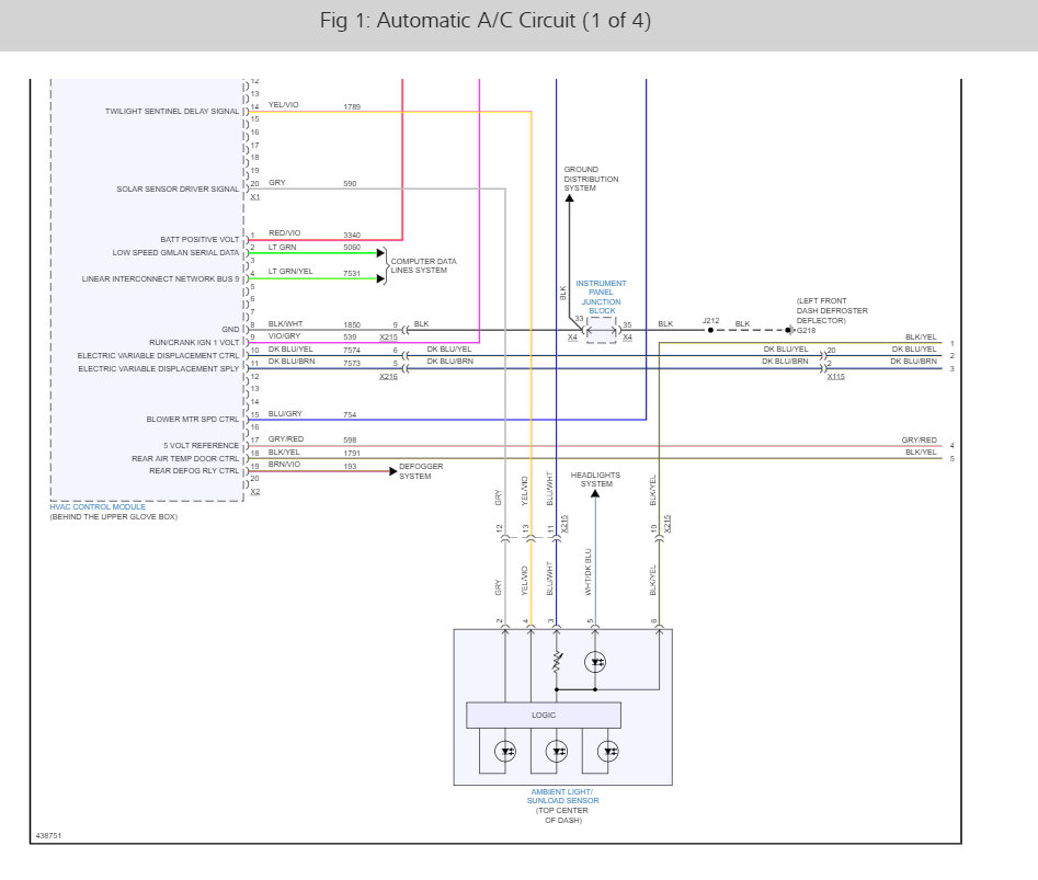

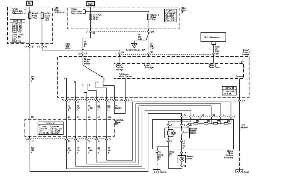

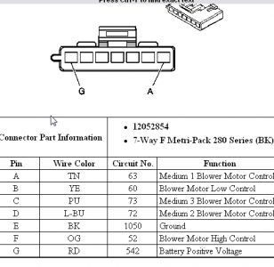

So we need to go to the blower motor and see what we have for voltage. I included the wiring diagrams where we need to check. Basically trace the power back to the two fuses and see where you don't have power and that will tell us what the issue is.

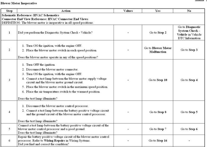

MIKEH
i have a 2006 chevy truck dual control auto temp i have tested the wires at the fan and i'm getting power on the purple wire that plugs into the fan one thing i noticed there is a small purple wire coming into resestor and it has no power to it. can you help me please
KHLOW2008
  • 41,814 POSTS
Does fan works when the Black wire of fan motor is grounded?
Disconnect the blower motor connector. turn ignition switch ON with engine OFF. Install a test lamp between the terminals of wireharness. Turn blower speed to maximum. Place air temperature switch to warmest position. Does test lamp illuminate?
Do you mean the Purple/White wire (Purple with a fine White line on it)?
Does blower motor works in any speed?
MIKEH
i did that test and i have no power, yes the purple/white wire that comes into the resistor it says input on the resistor. i took fan out and hooked power and ground to fan and it worked like that. the doesn't work on any speed when it stopped it was like some1 had turned the speed down slowly. the it stopped. thanks for the help
KHLOW2008
  • 41,814 POSTS

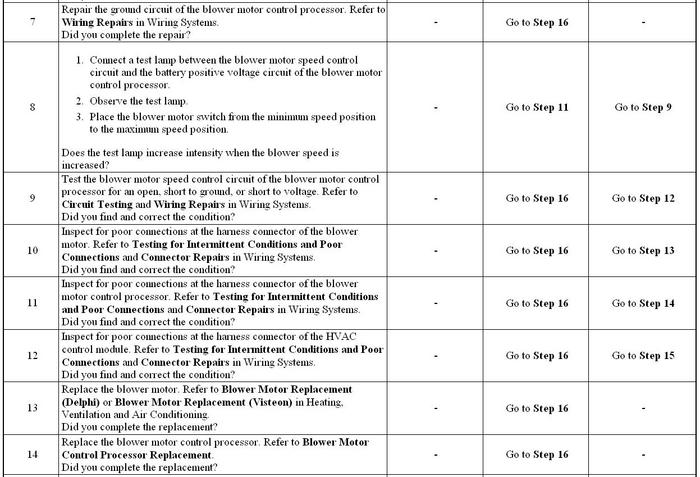

Here are the cmplete diagnostics for the blower motor. Go through and let me know what you find.
MIKEH
ok thanks i think we have it its the heater control panel in the dash.

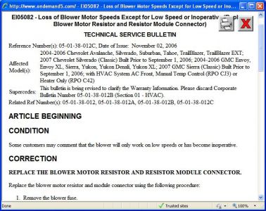

I had a mechanic look at and we found that the wiring harness going into the Blower fan resistor had burned out. He told me to get a new resistor and wiring harness and how to hook it all up. I then asked him if I needed to replace the blower fan and his response was get everything else fixed and then with the fan running hold my fingers on the wiring connector see if becomes hot. If it does then the blower fan needs to be replaced. My question to you is Do I really need to replace the fan even if it gets warm or hot?

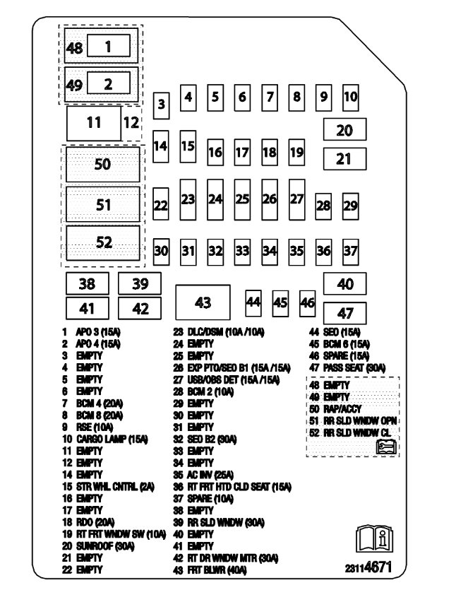

VICTOR1438
please where is the fuse for the blower motor i dont finned in the fuse box
Apr 30, 2021 at 7:22 AM (Merged)
  • 75,992 POSTS
Check and test all these fuses: Blower fuse 40amp and HVAC/ECAS fuse 10amp in the unde rhood fuse block, also the Htr/AC fuse 30amp and HVAC 1 fuse 10amp in the instrument panel fuse block to include the blower motor relay.

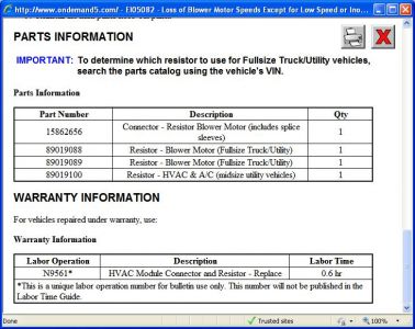

BILL TROUTT
  • 6 POSTS

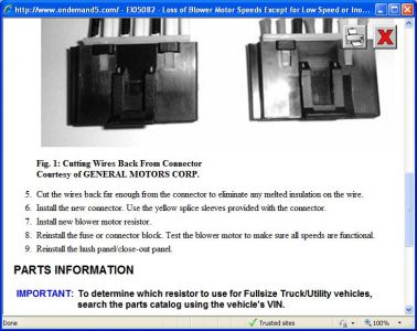

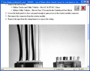

After having a ignition switch replaced at the local dealership my fan motor quit working a few weeks later. Last week I took it back to the dealership and was told there is a resisitor bad causing the problem. In order to replace I would need to purchase a new pigtail which the resistor was built into at a cost of over $250. I feel the dealership was pulling my chain. Any advise? If so are there any wiring diagrams aviable?
May 25, 2021 at 4:45 AM (Merged)
SATURNTECH9
  • 30,869 POSTS
https://images.2carpros.com/forum/automotive_pictures/416332_2006_1500LTac_part1_1.jpg
https://images.2carpros.com/forum/automotive_pictures/416332_2006_1500_LT_blower_motor_resistor_1.jpg
https://images.2carpros.com/forum/automotive_pictures/416332_2006_1500LT_blower_motor_bulletin_part1_1.jpg
https://images.2carpros.com/forum/automotive_pictures/416332_2006_1500LT_blower_motor_bulletin_part2_1.jpg
https://images.2carpros.com/forum/automotive_pictures/416332_2006_1500LT_blower_motor_bulletin_part3_1.jpg
https://images.2carpros.com/forum/automotive_pictures/416332_2006_1500LT_blower_motor_bulletin_part4_1.jpg
I solved the wire harness for the blower motor resistor card i posted the bullitin so you could read why you have to get the harness too.I also posted the wire diagram for it as well.If you have anymore questions let me know.
