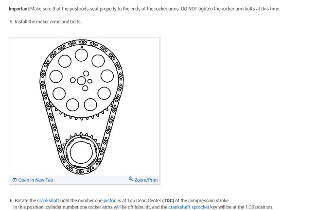

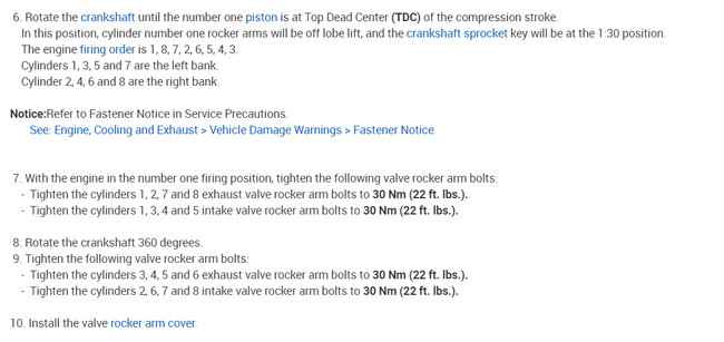

Putting rebuilt heads on a rebuilt engine, my question is: How do I set rockers in and do preload. Also, are the rockers the same for intake and exhaust and how to tell difference?
Thanks
Nov 13, 2022 at 9:46 PM
  • 55,433 POSTS

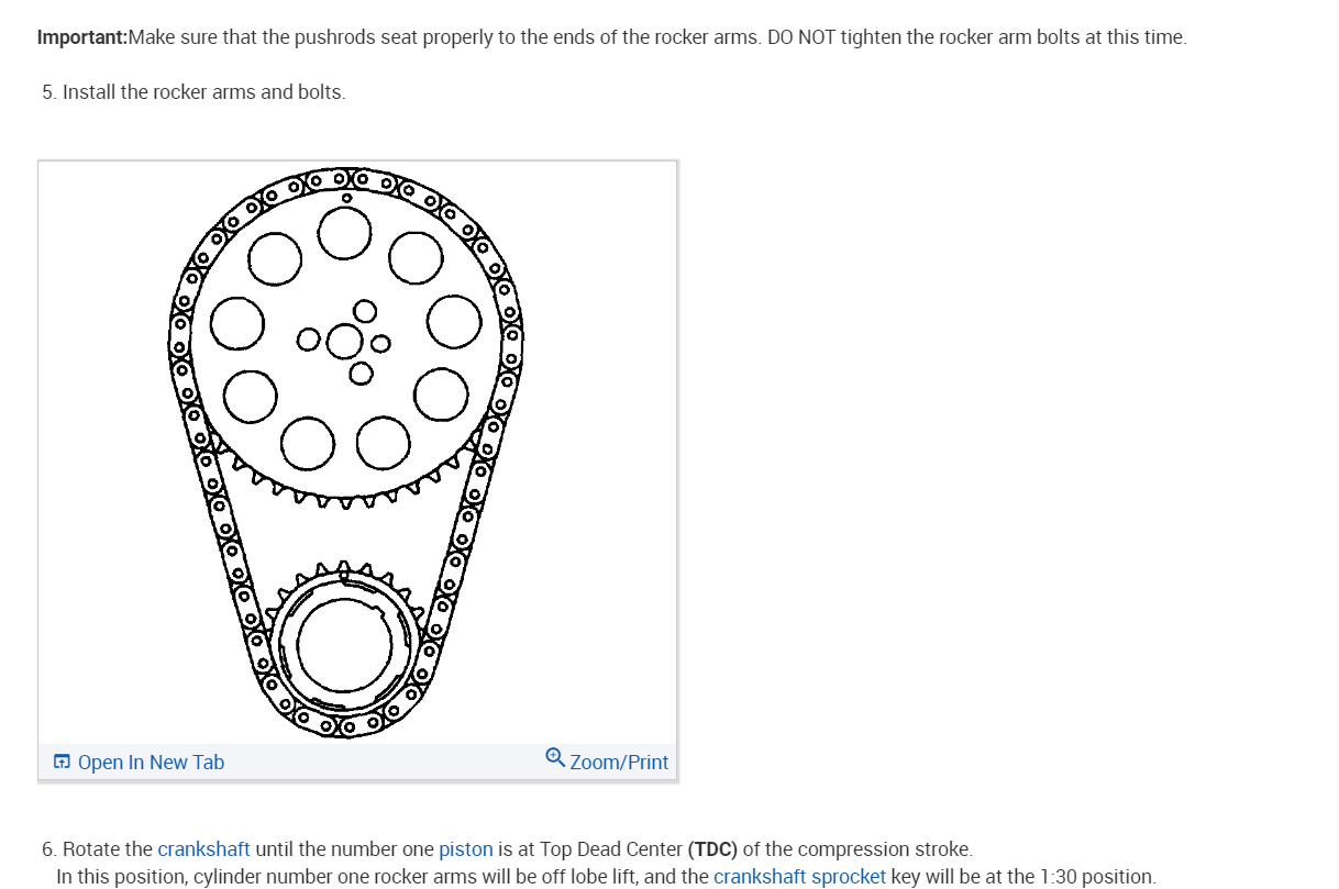

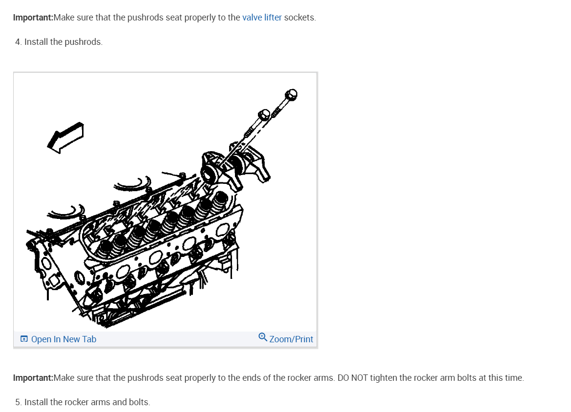

The rocker arms are the same for intake and exhaust, there is no preload as well, tighten to spec and go, just make sure the push rods are down before tightening. Here is a video showing the job done and the torque spec as well and the instructions on how to tighten the rockers down in the images below.
https://youtu.be/JDN8MaekT2Y
Check out the images (below). Please let us know if you need anything else to get the problem fixed.
