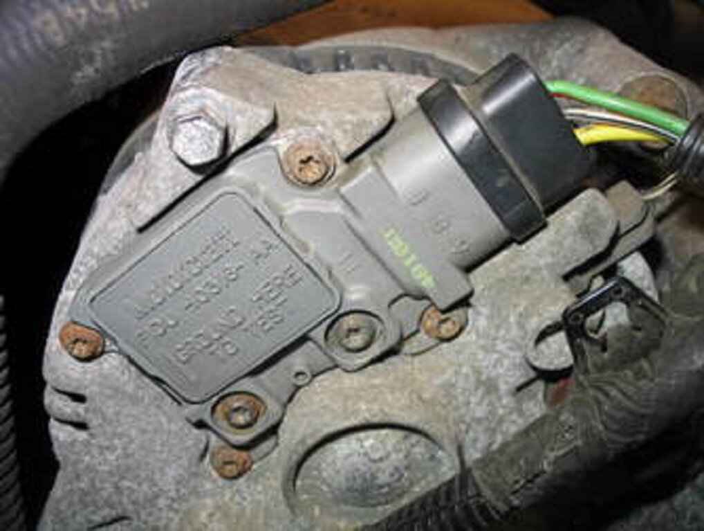

Install a new alternator and bought new battery, but battery is not charging.

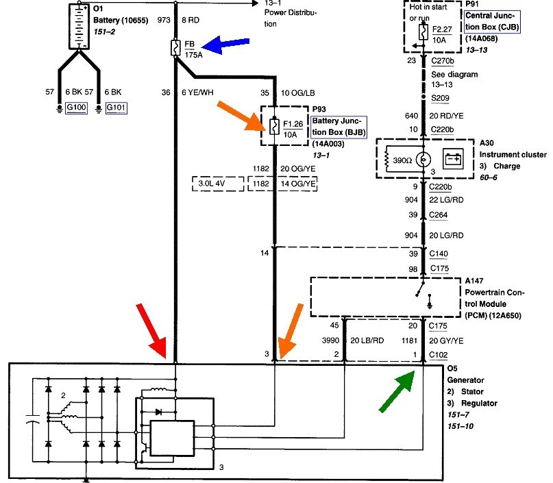

The first diagram is for the entire charging system with the test points and fuses pointed out. The second, third, and fourth photos are from an older model I used as a "bugged" car for students to diagnose. Your wire colors will be different, but the tests should be the same.
One notable exception is the engineers at Ford figured out they had made the system much too easy to diagnose, so starting around 2000, they added a stamped steel cover over the test points. We can still do most of the voltage tests.
Step one is to observe if the "Battery" warning light turns on when the ignition switch is turned to "run". If it does not, there is likely a break in the green / red wire or the connector terminal at the back of the generator. One voltage test will verify this circuit is working properly. This is the turn-on circuit for the voltage regulator to wake it up and get it started. The Engine Computer has been added to this circuit for 2002 and 2003 models, then that wire changes to a green / yellow wire.

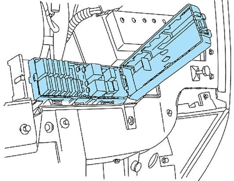

If the charging voltage is below 13.75 volts, we'll need to look at the wires at the generator. Start with the fat wire bolted onto the output stud. You may need to pull back a red rubber cover. That terminal must have the same voltage you find right at the battery all the time. If you find 0 volts with engine off, and / or higher than battery voltage with engine running, the 175-amp fuse is blown. That can be caused by a shorted generator or by touching that terminal and something metal on the engine at the same time, with a metal tool. Fuses that large are usually bolted into the fuse box because plug-in terminals can't handle that much current.

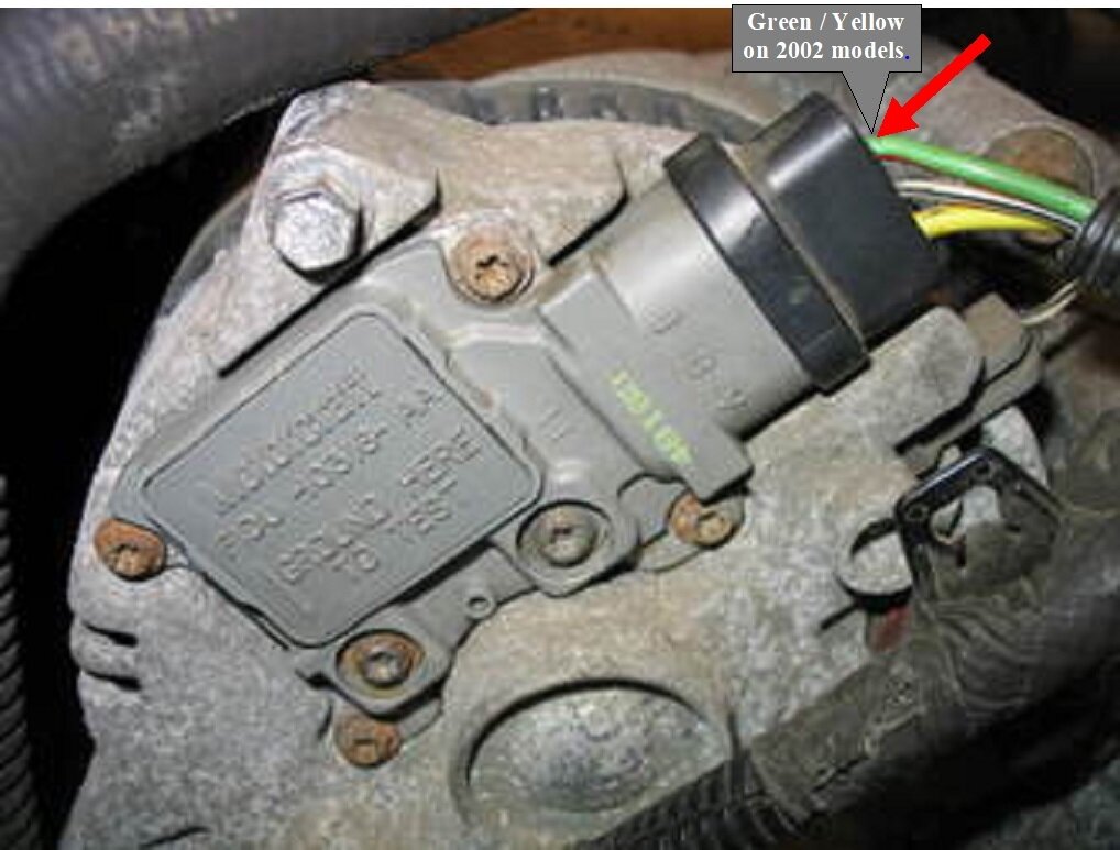

These next two voltages must be taken with the connector plugged in to be valid. With the ignition switch in "run", back-probe through the rubber weather seal next to the green / yellow wire, (red arrow in the third photo). Expect to find close to 2.0 volts. That would indicate that wire does not have a break in it, it is not shorted to ground, and that connector terminal is making a good contact with its mating terminal in the voltage regulator. 0 or 12 volts indicates a defect in that circuit.

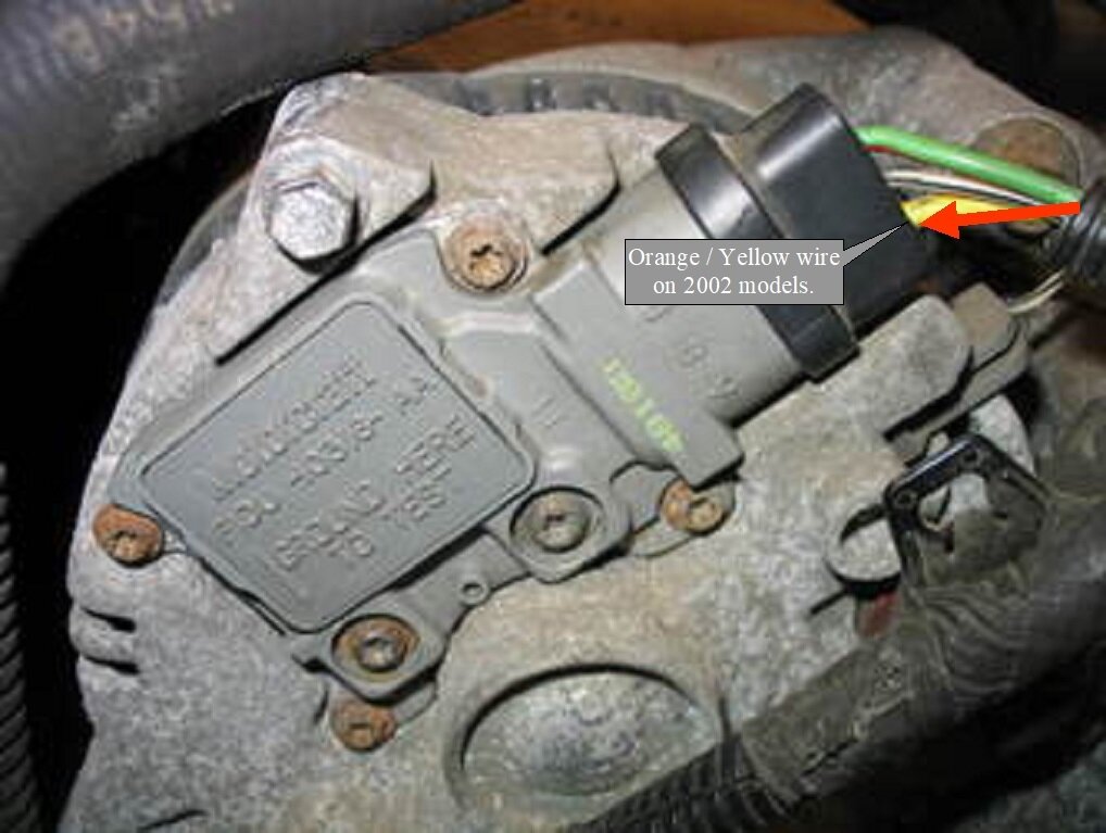

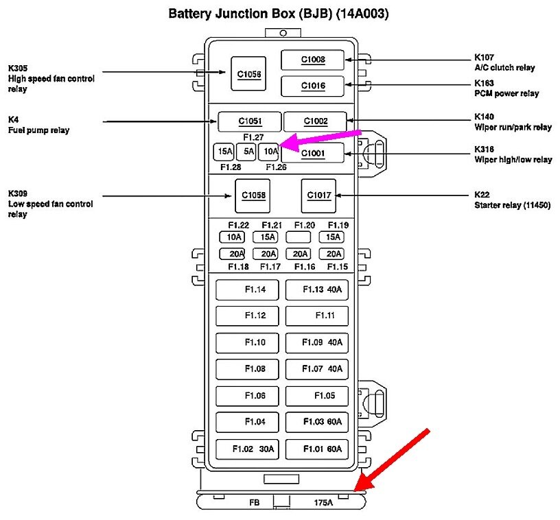

If that green / yellow wire has the correct 2.0 volts, move to the orange / yellow wire, (red arrow in the fourth photo). This one must have full battery voltage all the time, regardless of ignition switch position. If you find 0 volts, fuse # 1.26, (pink arrow in the sixth photo), is blown. Failure of this fuse has been very common of Ford products. If it's blown, just replace it with no need to look for a cause.
On older models there was another simple test to determine if a dead charging system was caused by the generator itself or by the voltage regulator bolted to the back of it. Defective voltage regulators were very easy and inexpensive to replace. Now, with this newer computer-controlled design, that test is not provided, and the regulator is not a replaceable item. Instead, if these voltage tests are all okay, the generator must be replaced as an assembly. Since you did that already, the next step is to suspect the Engine Computer. Before that is replaced, there are diagnostic charts with tests to verify the computer is the cause of the problem. The question then is why was the generator replaced originally, or, did the replacement make a change in the symptoms?
