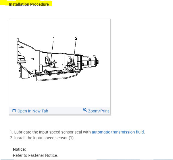

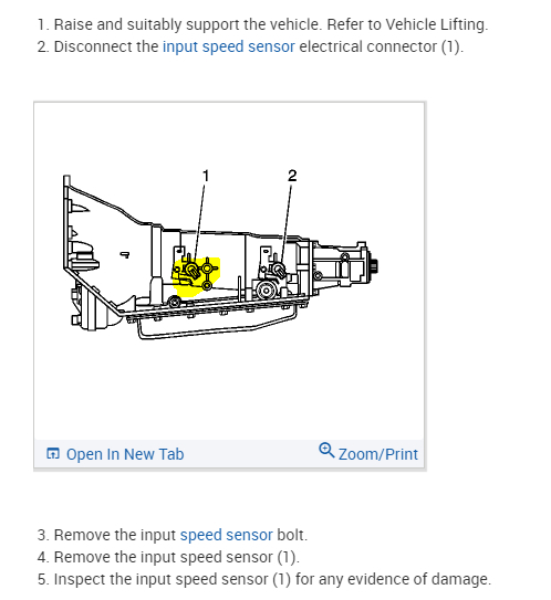

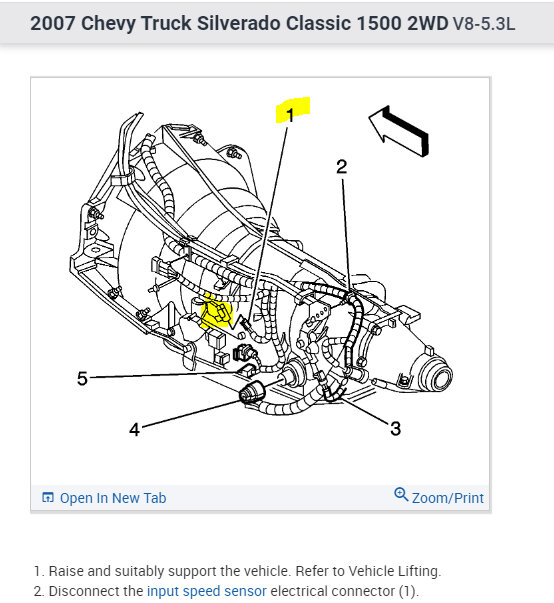

My truck is giving a P0700 and P0717 code. Based on my understanding, the p0700 is the generic transmission code and the p0717 is in regard to the speed sensor. I've replaced what I believe is the speed sensor near the output shaft but cannot locate any other sensors. Can I get the location of where the input turbine shaft speed sensor would be located? Preferably with pictures. My truck is not the classic body but the newer body for 2007.
Jun 17, 2023 at 9:44 AM
  • 110,244 POSTS

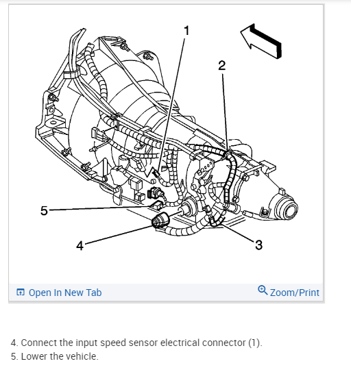

All optional transmissions other than the Allison are located on the driver's side of the transmission. If you look below, I attached the directions for the removal and installation of the input speed sensor.
Let me know if this helps.
joe
See pics below. If you do have an Allison transmission, let me know.
