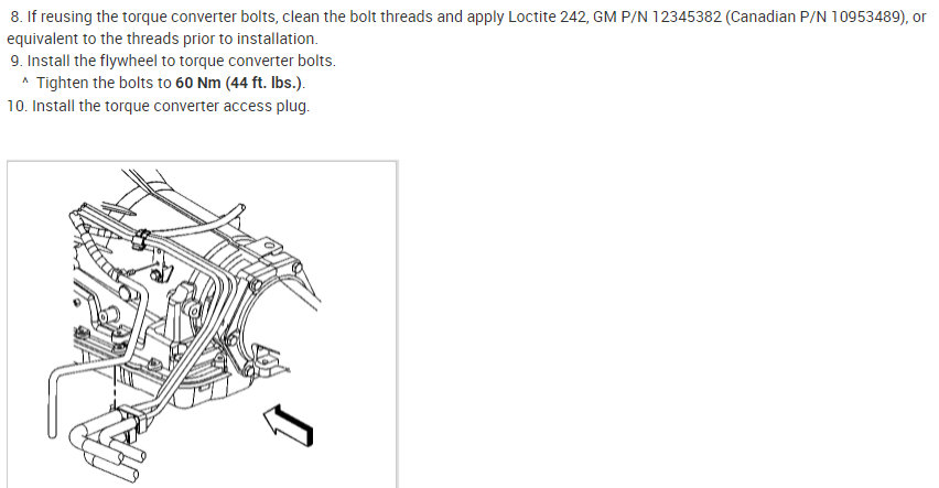

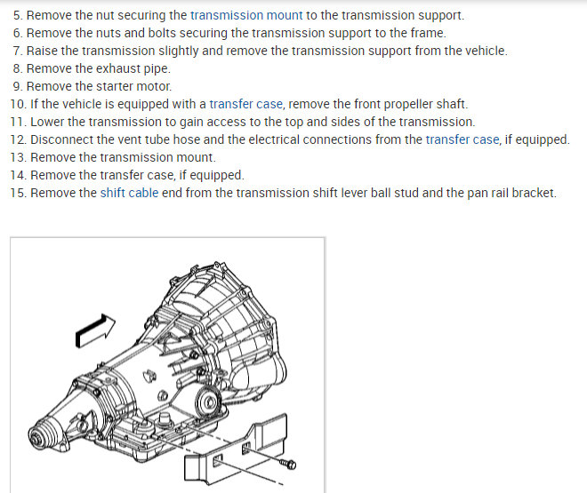

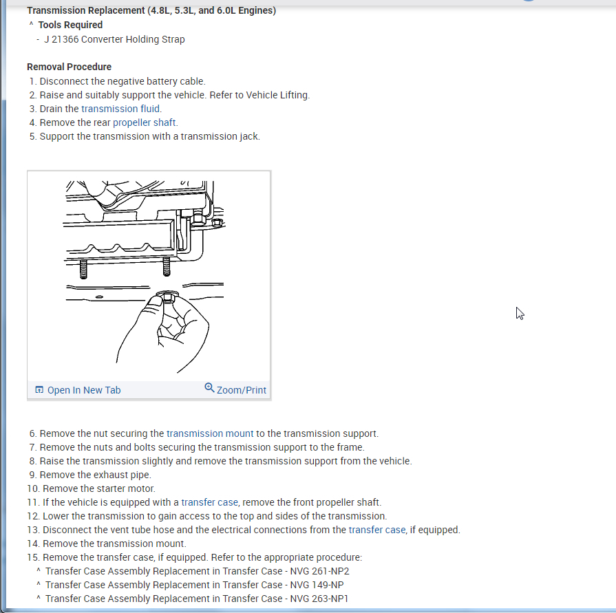

Check engine light comes on and then it will not shift automatically. I have changed the 2 shift solenoids. It is stuck in overdrive when in drive. It cant be manually shifted. Has stayed this way for quite some time, then it reverted back to normal. Now, the problem is back again they say I need to replace the transmission can you help me please? Any idea what I need to do?

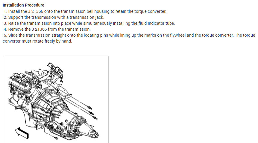

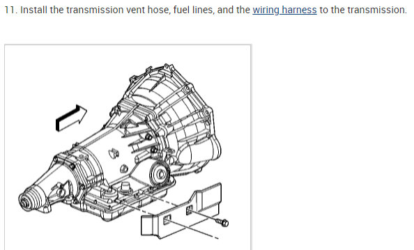

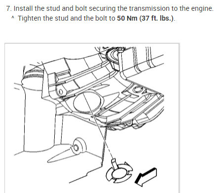

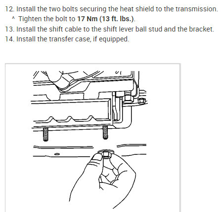

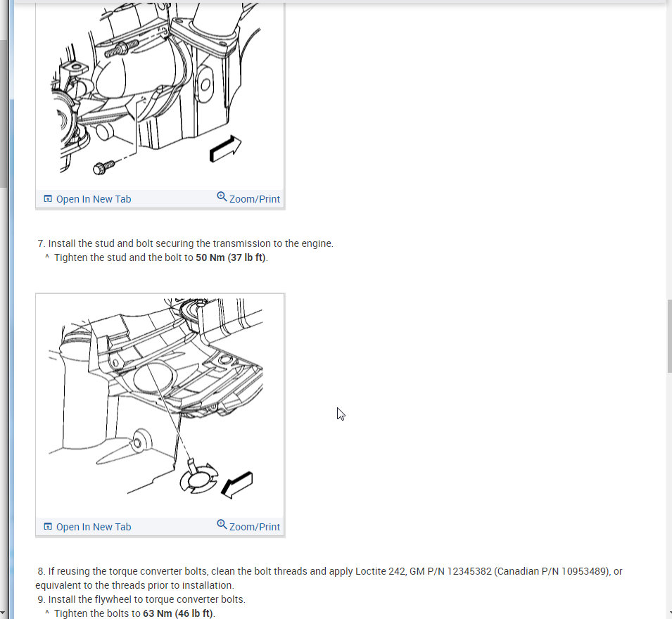

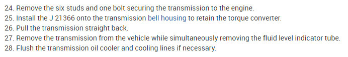

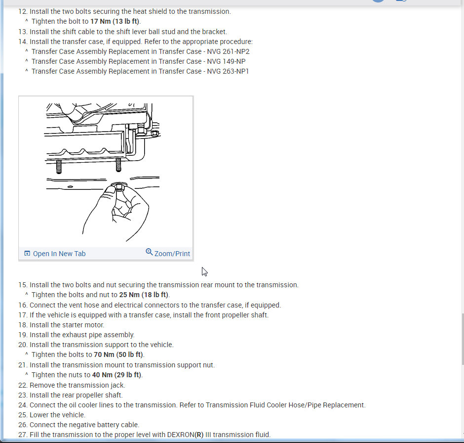

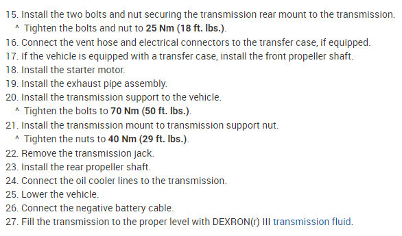

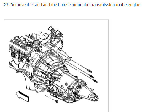

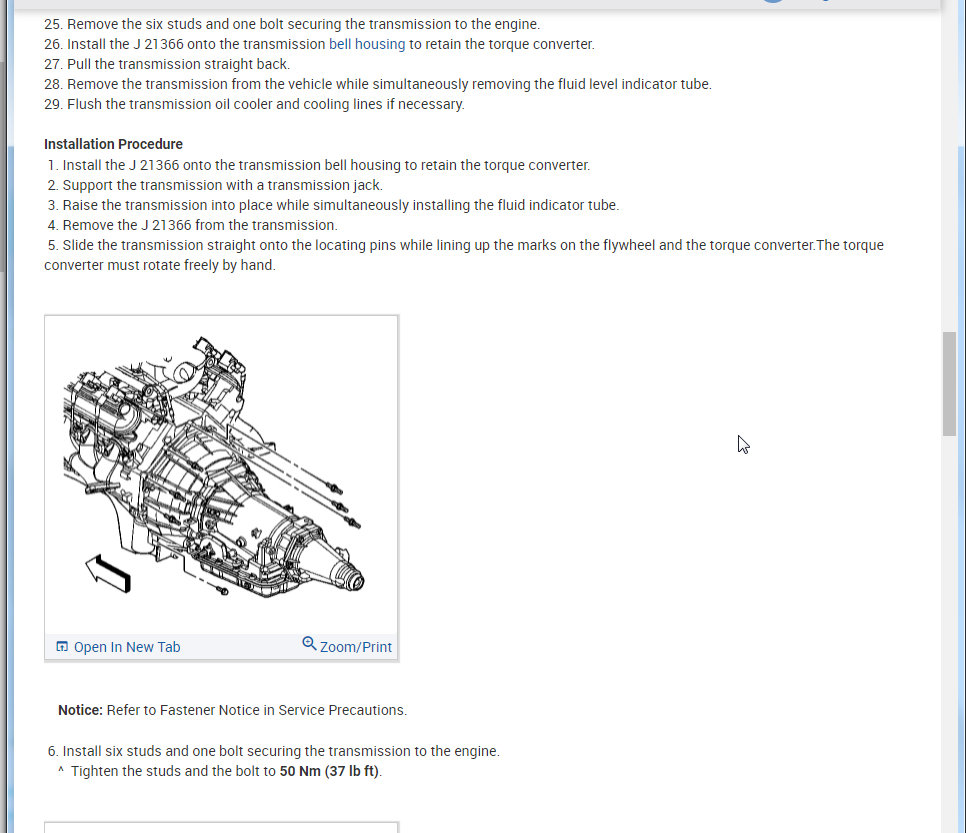

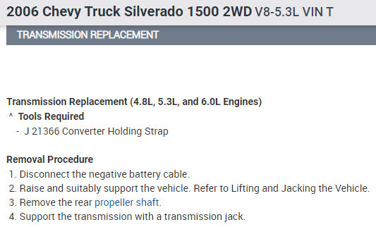

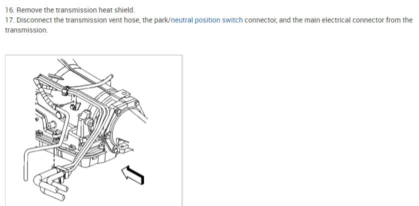

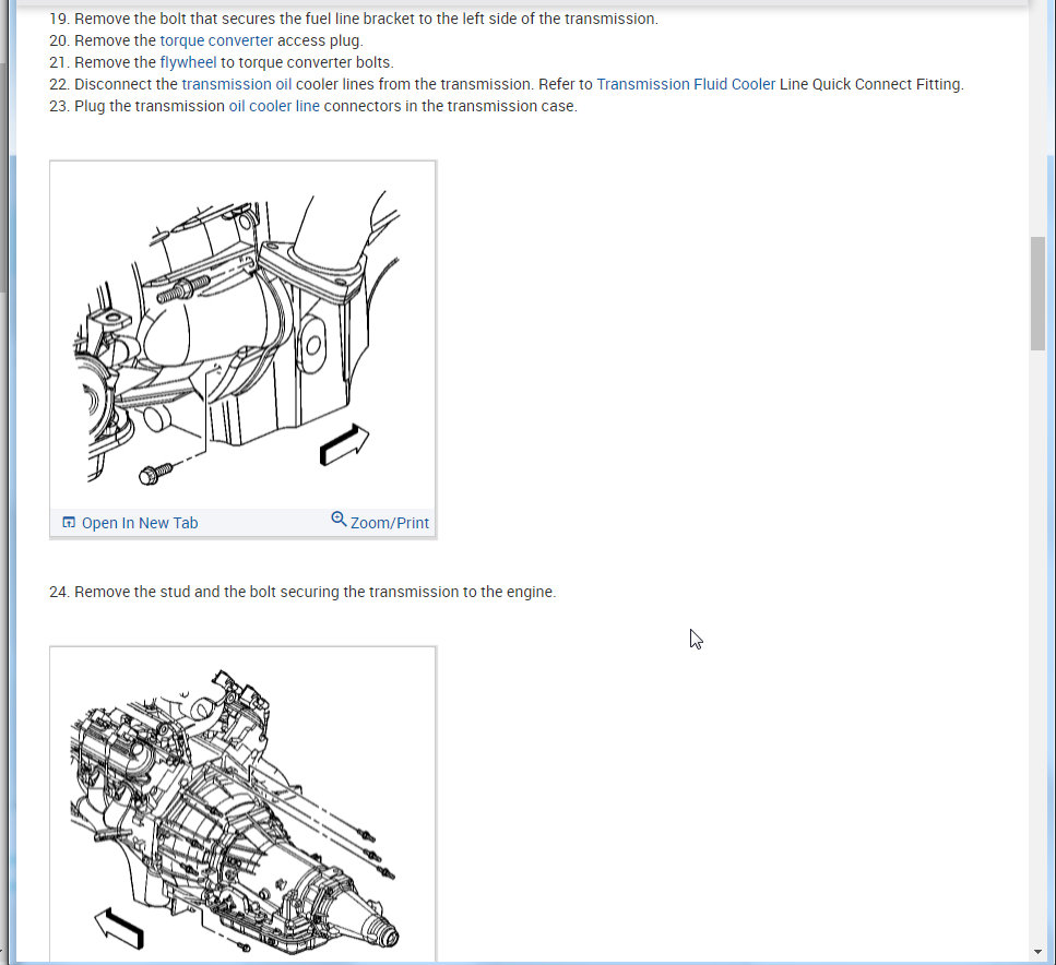

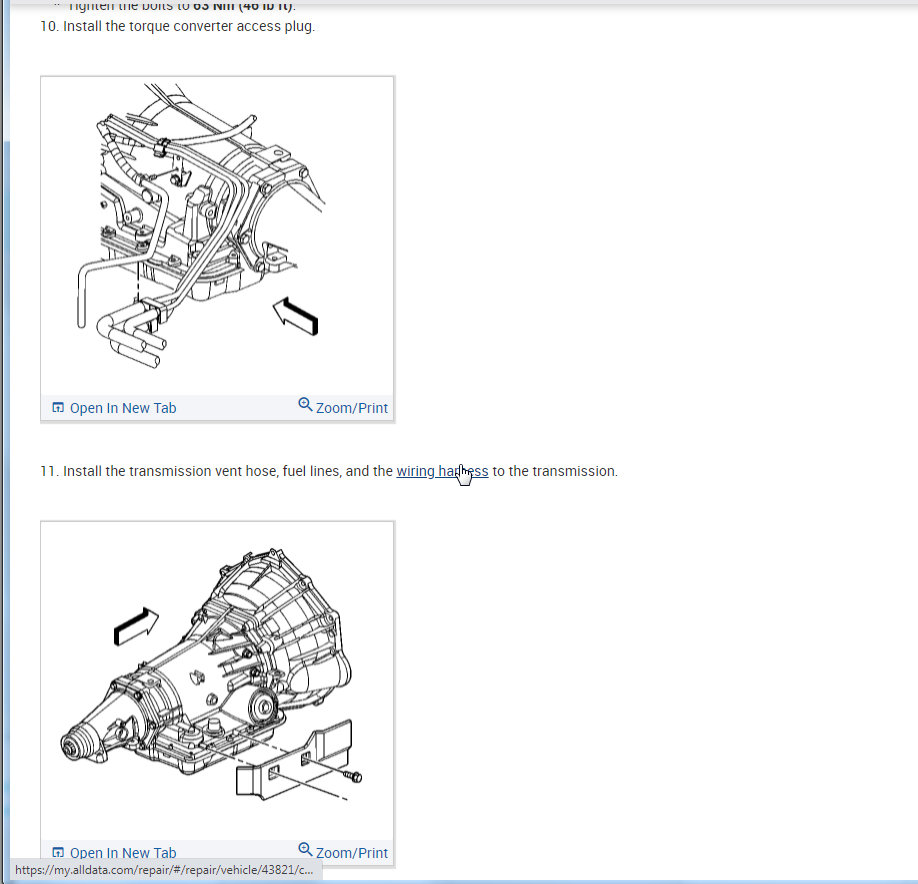

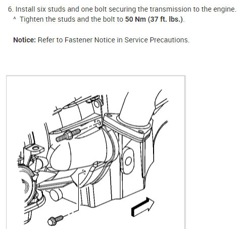

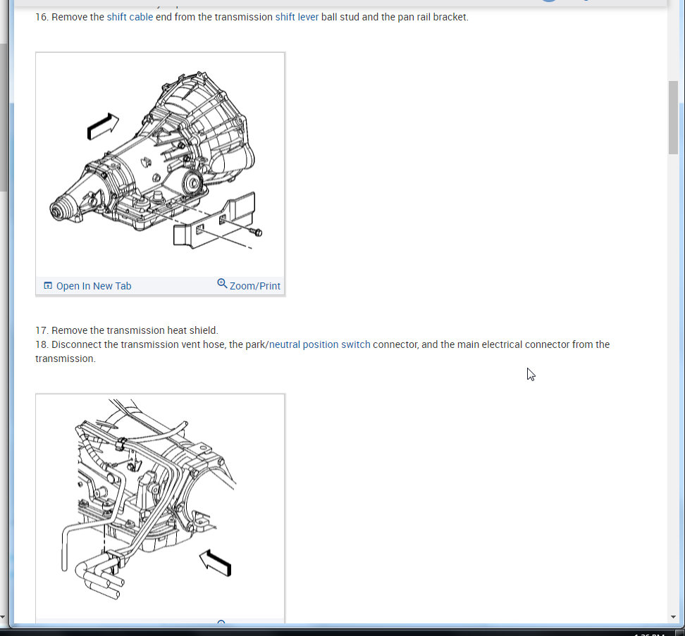

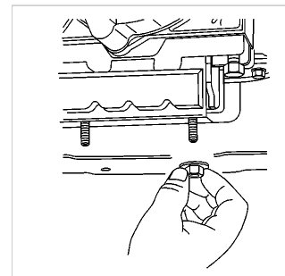

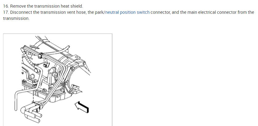

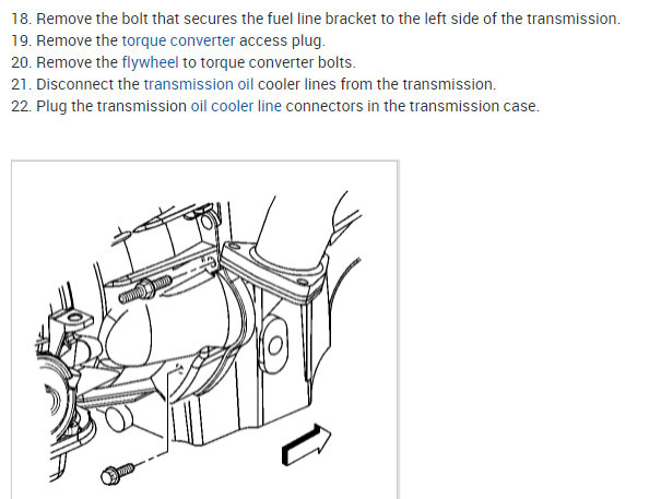

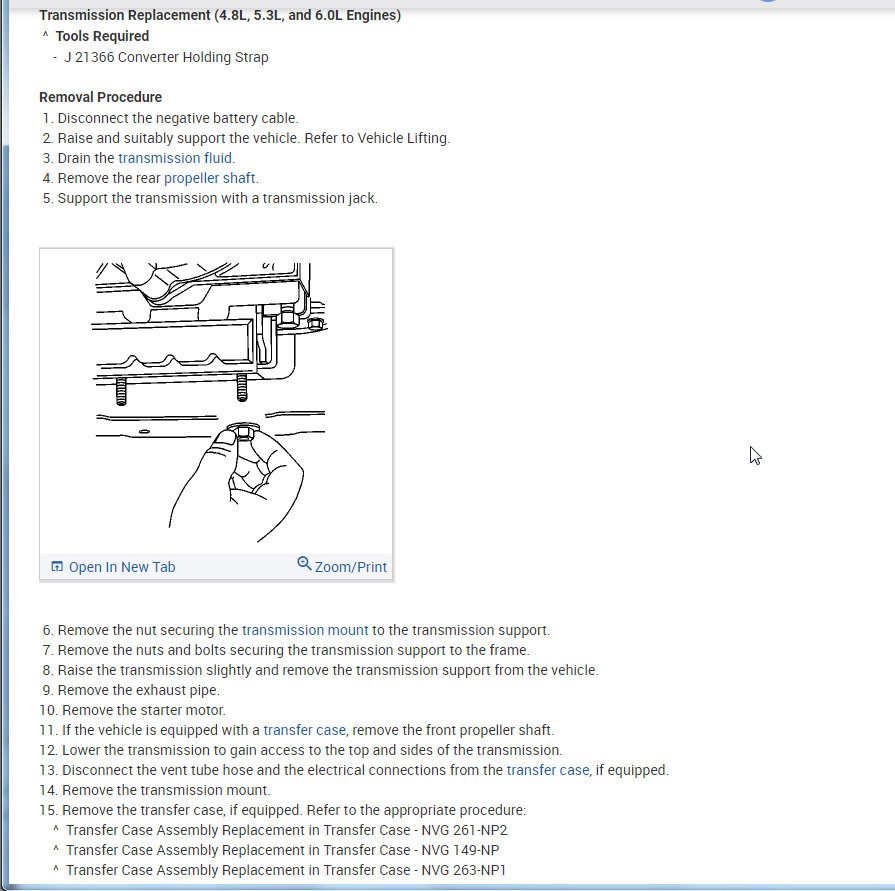

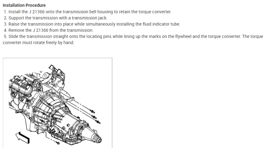

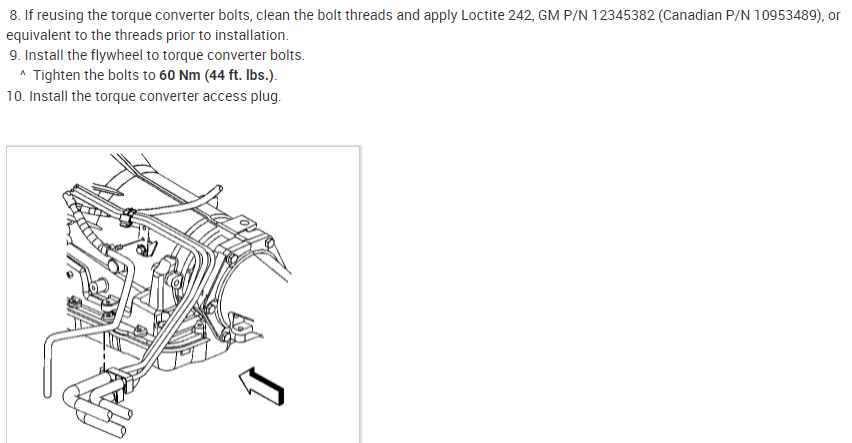

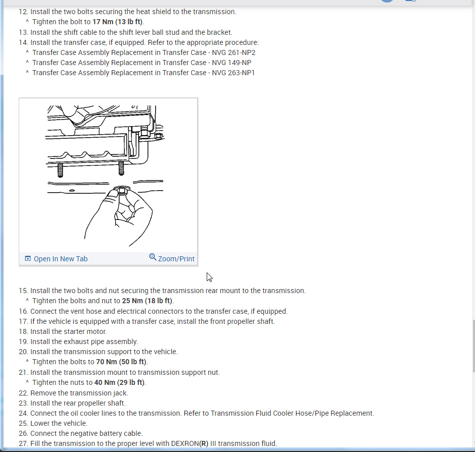

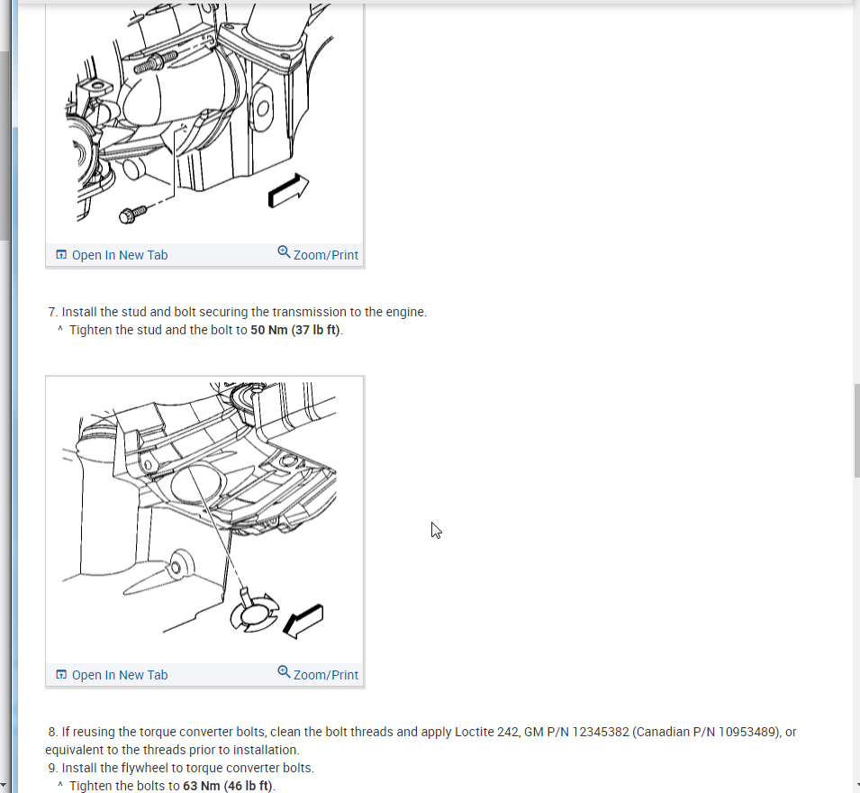

Here is the information you requested. Usually what we ask you to do is provide us with the stored transmission codes to help properly diagnose any transmission issues. If you perform a CAN scan on your truck it checks all vehicle systems to read any stored codes in the computer like transmission codes you mentioned. Here is a tutorial showing how to perform a CAN scan on your truck:
If you choose to replace the transmission here is a tutorial for you to view showing how to remove and replace a manual transmission which is similar to an automatic transmission:
https://www.2carpros.com/articles/transmission-replacement-removal-manual
I've attached picture steps below on how to remove and replace the automatic transmission on your truck. Hope this helps and thanks for using 2CarPros.
