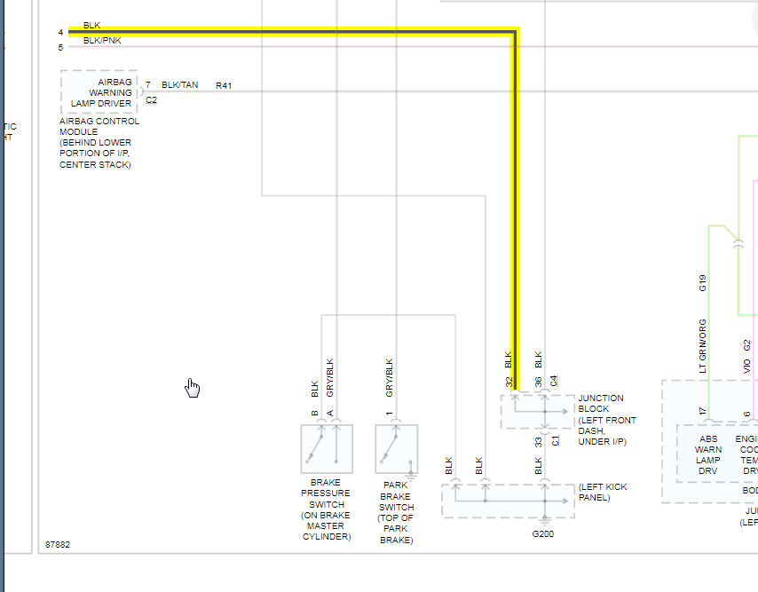

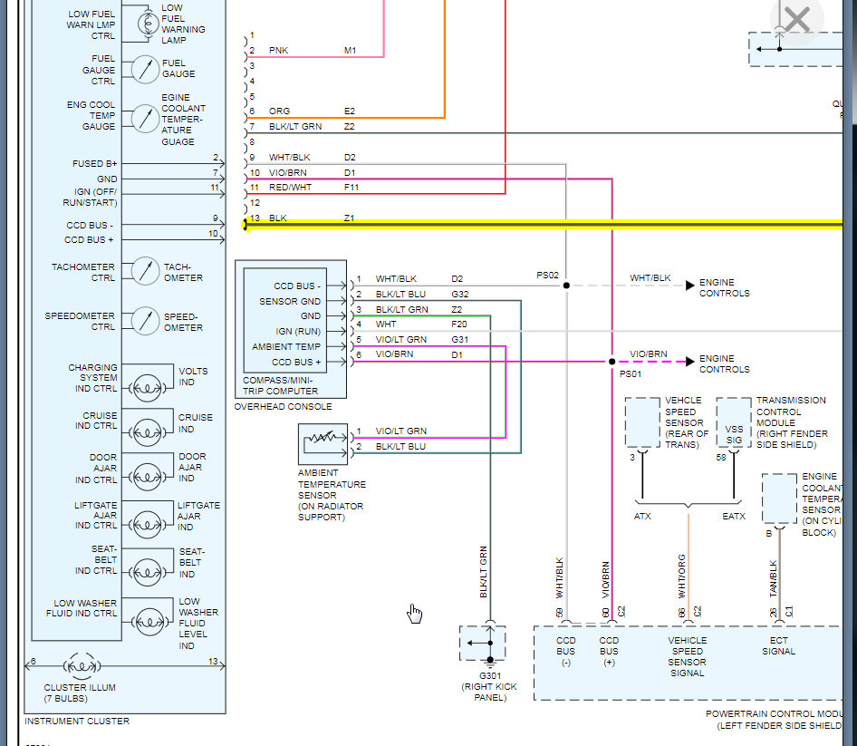

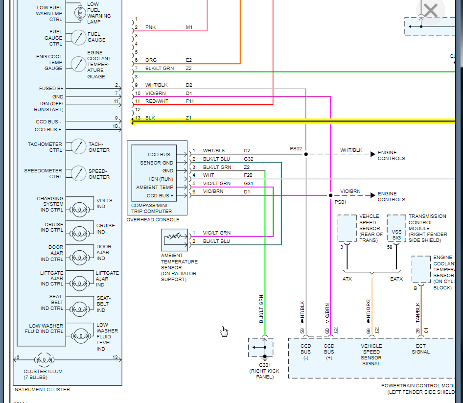

The instrument cluster inoperable, No PRNDL, Fuel, odometer, temperature. Retrieve P0106. Check Power and Ground at the cluster okay. Red/white 12V key On. I have questions how to check CC BUS (-) and (+). What should be the reading if the engine running? Please can you guide me what to check next. Thank you!
Sep 24, 2020 at 3:02 PM
This is the CCD bus or Chrysler Collision Detection Data Bus. The voltage when the bus is idle (no communications being sent should be 2.49 on the + and 2.51 on the -. When there is data being sent they will change but should always add up to 5 volts. If you want more info, visit this website:
https://mopar1973man.com/cummins/articles.html/24-valve-2nd-generation_50/51_engine/electrical/ccd-chrysler-collision-detection-data-bus-r329/
This is very detailed and thorough about how this CCD bus works.
Let us know if you have questions but if you have power and ground and all the gauges are not working then the cluster is the issue.
Let me know what you find and we can go from there. Thanks

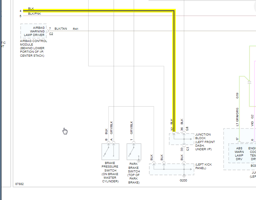

Thank you! I did check CCD BUS (-) 2.48- 2.50 volts and CCD BUS (+) 2.49- 2.50 volts with engine running. Is this a good reading to you? I have question on pin #13 on the instrument cluster connector? The EWD that I’m using doesn’t show what circuit.
Sep 26, 2020 at 3:54 PM
That is perfect voltage. Good job. I attached what we have for pin 13 of the cluster. Should be a black wire which is appears to be a ground wire.

Thank you for the info. Check pin 13 measure good ground. So next step is that I went and pick up a instrument cluster from the wrecking yard. Similar instrument cluster. Plug connector and check operation, the gauges still not working. Does the used gauge need to be reset? I notice that fuel ant temperature gauge moves a little when ignition cylinder turn to "on" position. Any Idea what to check next?
