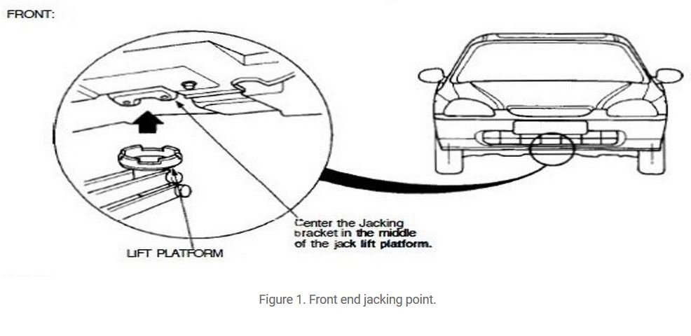

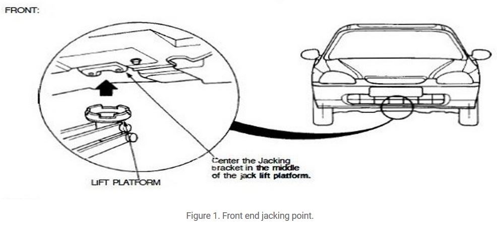

First you need to jack up the from end. Place the jack on the jacking platform located on the vehicle center-line roughly even with the wheels between the wheels. Use jack stands under the car in solid places in case the jack fails.

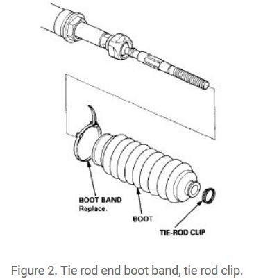

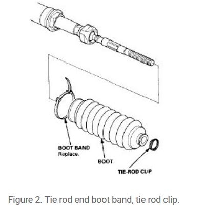

Remove the boot on the inner tie rod (use the pliers to get the small clip off the small end, and the wire cutters to cut the big band (you will need a new band to complete the installation).

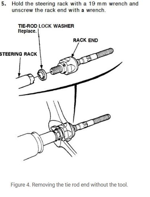

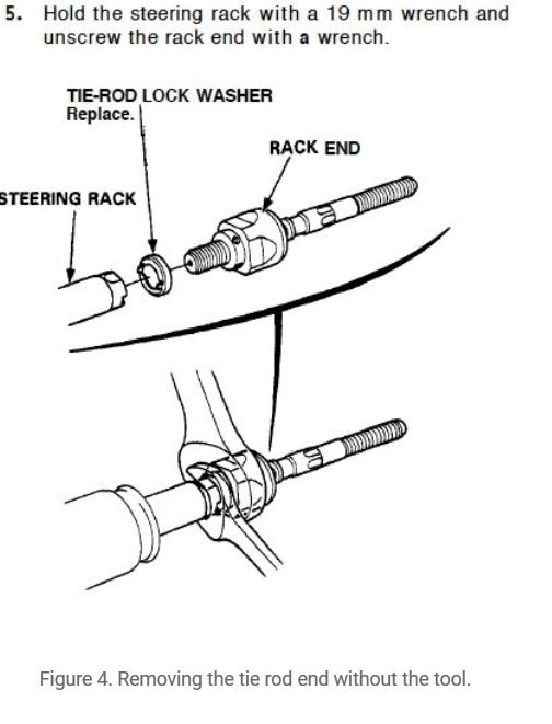

Remove the inner tie rod by using a crescent wrench to hold the rod on the steering rack, and a 19mm open end wrench to loosen the inner tie rod. You could also rent a tool to do this.
Install the new inner tie rod, and torque to 40 ft-lbs Then you can assemble the the boot, boot band, and clip.
