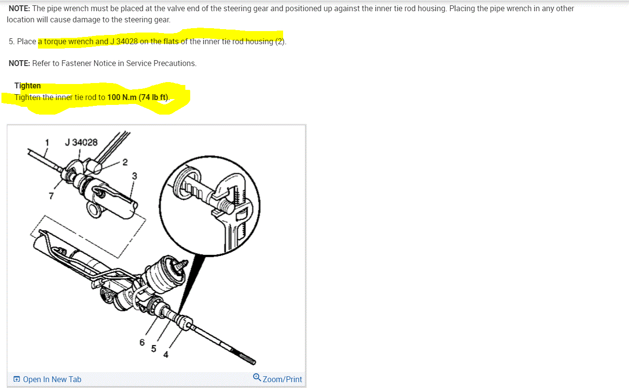

What are the Inner tie rod torque specs?

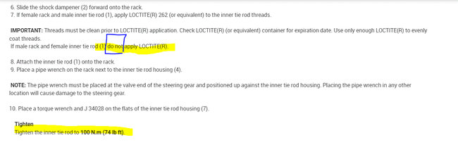

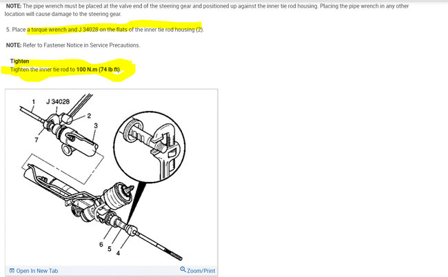

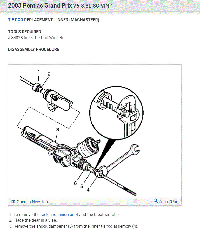

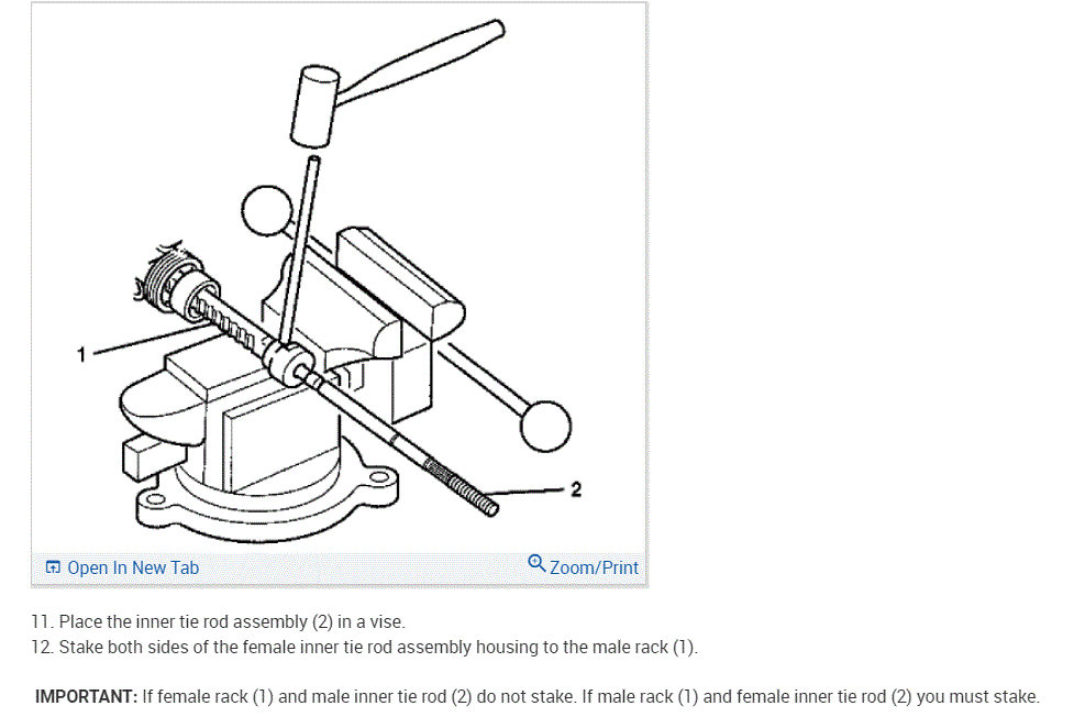

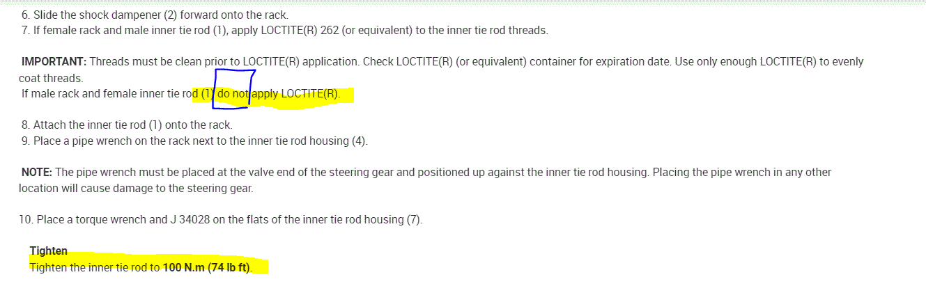

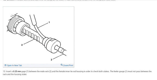

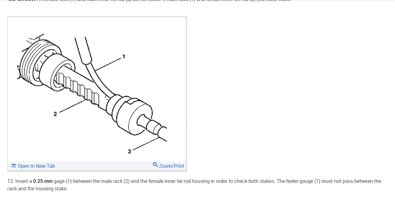

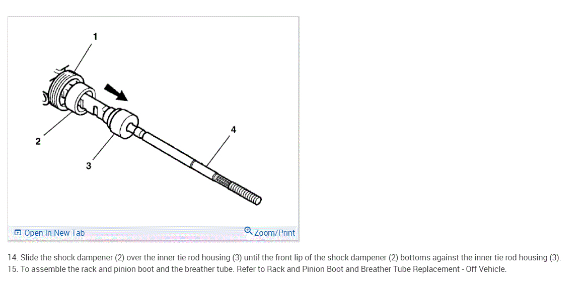

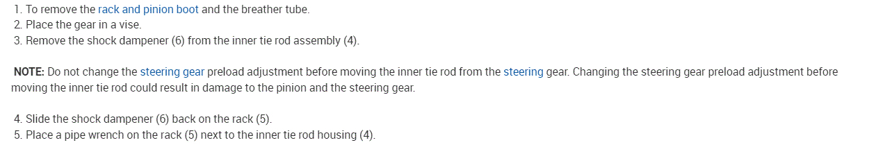

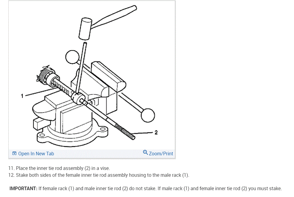

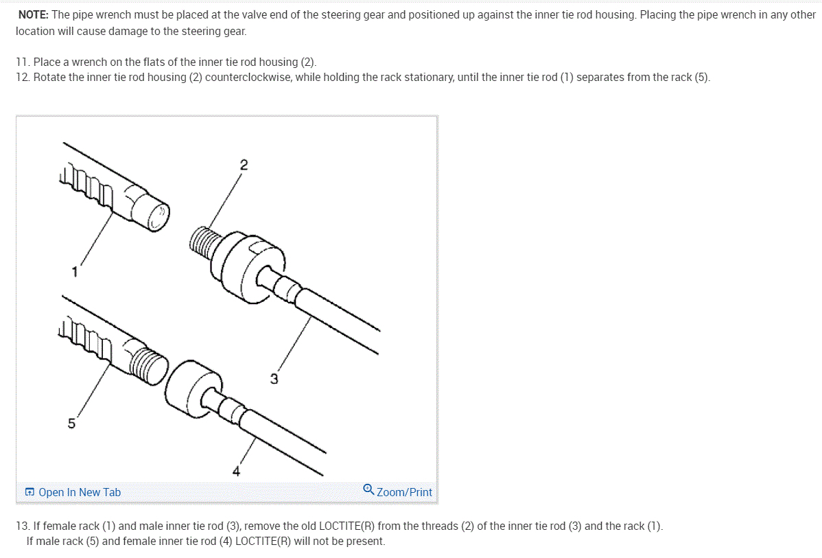

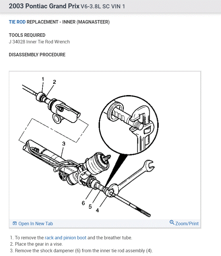

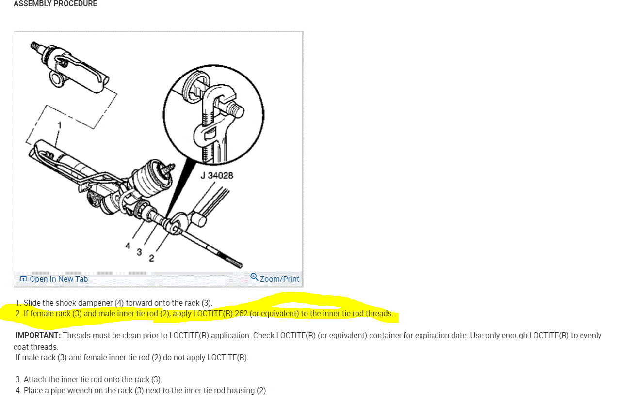

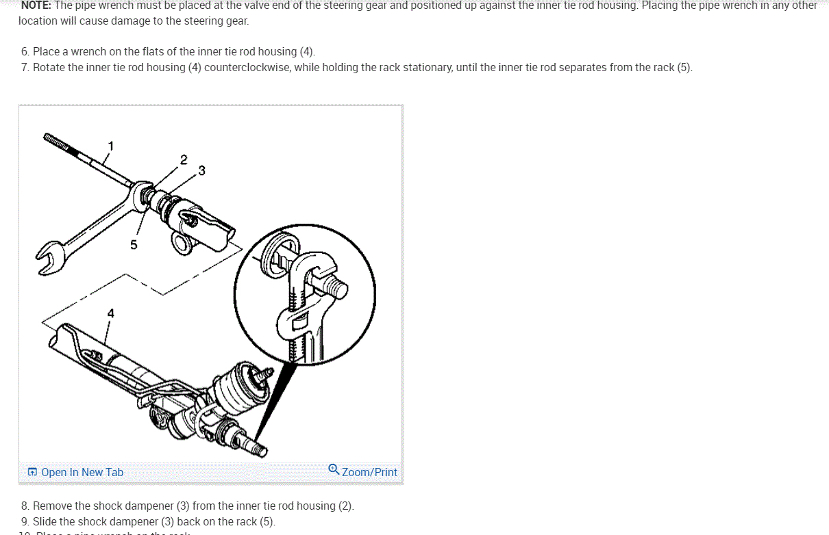

If you look below, I provided the directions for the removal and replacement of the inner tie rod specific to this vehicle. If you look, I highlighted the torque specs. Additionally, make sure to follow the directions related to the use of Loctite.
Let me know if this helps.
