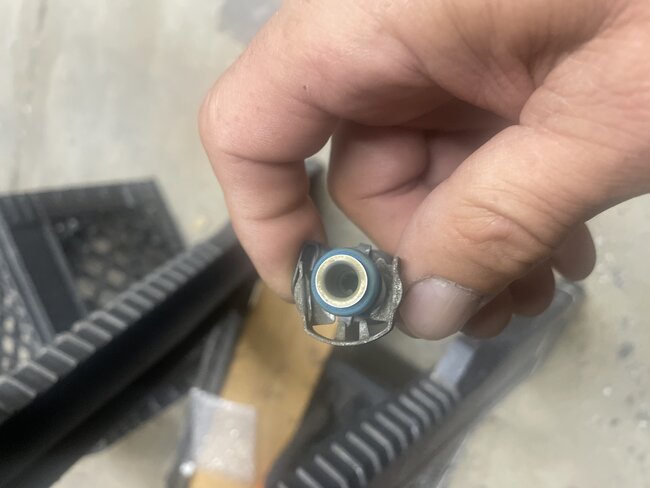

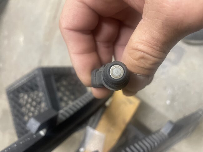

Oil after changing out the oil, pressure sensor, the engine light went off for about four days, and then it came back on, and told me that both of my field banks are running rich. And so, I changed out the air filter because it was very black and very old. Hoping that this will solve that problem. But my question is, would it be the new injectors that I installed? Because they are four hall injectors, rather than the original two whole injectors, which I still have. They seem to be very clean.
Sunday, August 6th, 2023 AT 7:46 AM
  • 109,885 POSTS
If the fuel pressure is within specification, then I would suggest reinstalling the original ones to see if the problem goes away. There is a good chance that is the cause.

I put the original injectors in, and so far the light has not come on. But it took a couple of days for it to do that before, so I’m going to wait for another day and see what happens. Meanwhile, I’m going to clean out the mass airflow sensor Because I bought some mass airflow sensor cleaner. I figured it would be a good idea and it might help a little more.
