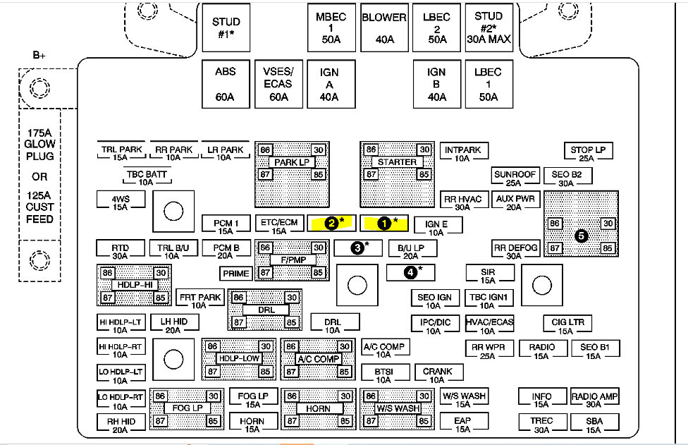

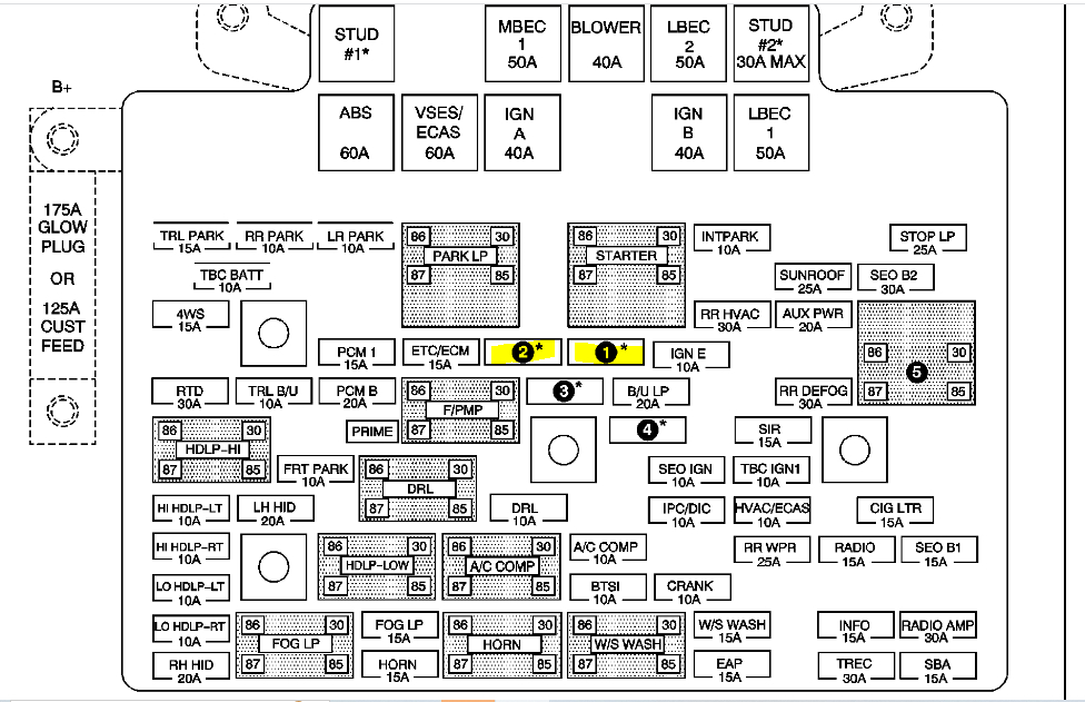

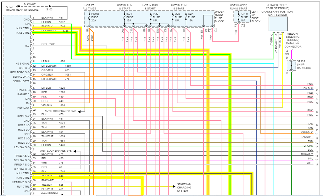

If you have no power to the injectors on one side of the engine, have you checked the fuses? Each side or engine bank has a separate fuse for the fuel injectors.

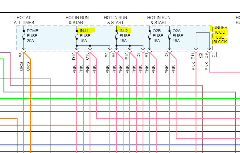

Take a look below. Note there are injector 1 and injector 2 fuses. I need you to check both fuses and confirm there is power to and from the fuses.
Also, pic 2 shows the under-hood fuse box. I highlighted the fuses to check.
Let me know what you find.

Fuse number two was blown, I put a new fuse on it and restarted the truck, it still has no power to the injectors. I haven’t put a test light on it yet. But the fuse did not blow.

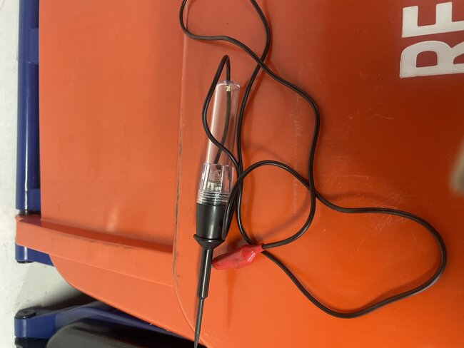

Let me know. Also, the test light you have is perfect. It will do the job if we need to go that route.

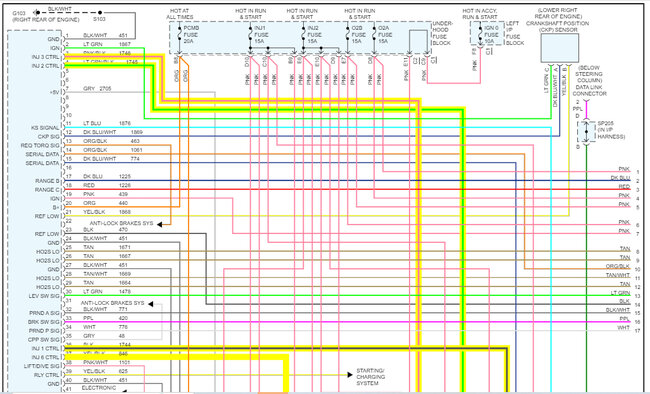

Can you please send me a wiring diagram for the PCM to the right-side injectors? I think it’s #1 injector bank, #2 fuse. Then can you tell me how to test it with a multimeter? Thank you so much for your help with this.
Jul 2, 2023 at 3:17 AM
  • 110,248 POSTS

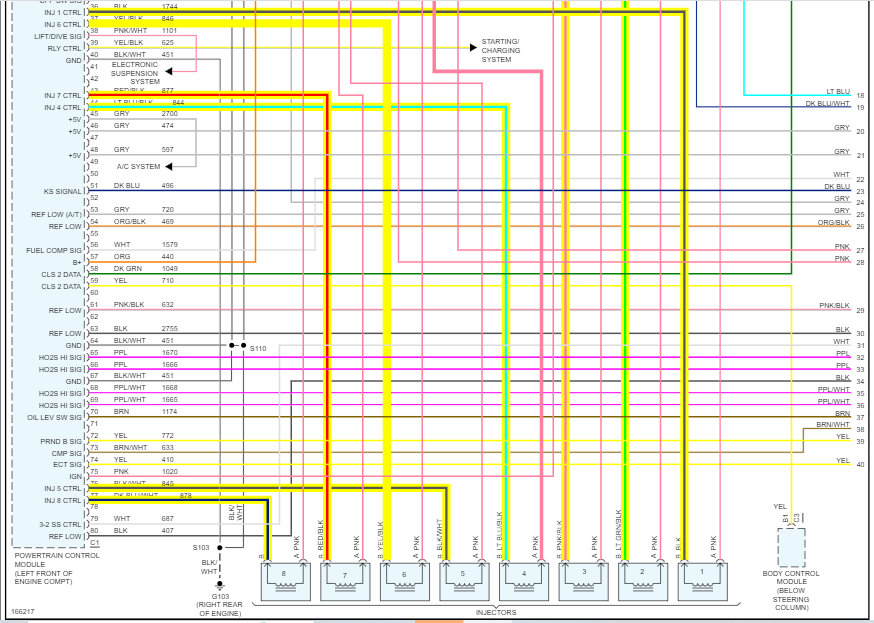

I would be happy to. If you look below, I attached the schematic and highlighted all the signal ground wires from the injectors to the PCM.
Note that each injector has a pink wire. That is the power supply. It should have 12v with the key in the run position or start position.
Here is a link that you may find helpful when testing wiring:
If you are testing for a signal ground, it is easier with a test lamp. Connect the test lamp alligator clip to the battery-positive terminal. Probe the ground wire with the test lamp. Have a helper crank the engine. If the ground is working, the test lamp will strobe on and off.
Let me know if that helps.
