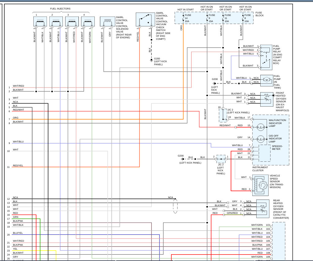

Injector mismatch on each cylinder, need the colors of the wire 1-4 cylinders.

In the diagrams down below I have included the engine management wiring diagrams for your vehicle. The fuel injectors are on the top of the fifth diagram. I hope that this helps and please get back to us with how everything turns out.
