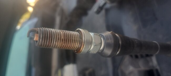

Was the #1-cylinder spark plug black or wet? If so, you have a stuck fuel injector. I would do a compression test on that cylinder as well. Here is how to test the fuel injector:

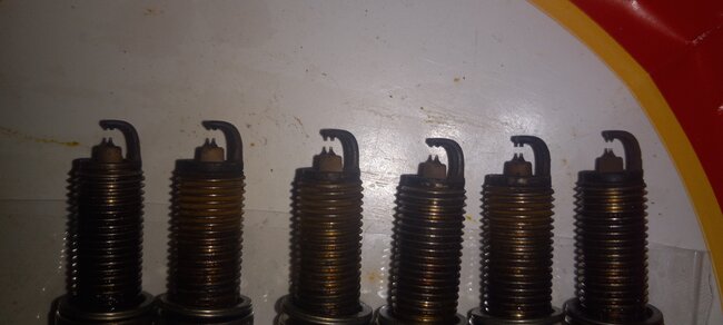

I am not sure which plug is which cylinder as my wife hired a mobile mechanic for the plugs and coil and it didn't help. The problem started immediately after we stopped and filled up her tank on a Sunday evening. I have hooked the 'bad/old coil up and the 'worst' looking plug up to bank 2 and the coil makes spark and the plug sparks still. So those weren't the issue. The PCV hose collapsed and the nipple part has oil on it as well. I'll post the plugs as she was handed by the mobile tech.
Oct 17, 2024 at 5:01 PM
  • 55,845 POSTS
The spark plugs look okay, I think we should do a compression test on cylinder #1.

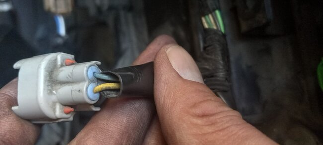

I can upload that as soon as I get it put back together. I ohm tested the 1,2,3 cylinder injectors and they read 1-14.5
2-14.8
3-15.2
Spark plug from cylinder 1 was wet and now I'm trying to figure out wiring
and how to ohm test the old and new coils before I put it back together. White- power
Black - ground
Green- signal??

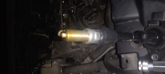

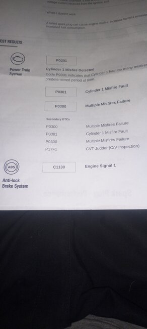

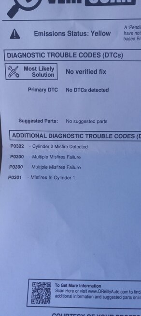

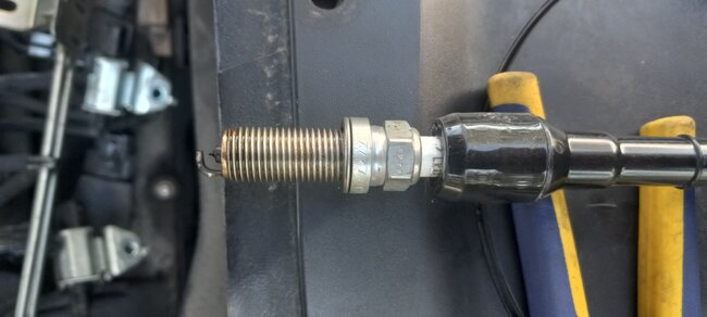

Here's the plug NGK Iridium LKAR-7BIX-115 that the mobile mechanic put in and today's scan after swapping coils with #2.
Oct 21, 2024 at 8:31 AM

That looks like the engine is okay, but you say if the swap the coils around it follows the bad coil? I would get a replacement coil for that one and see what happens. Also, I would rescan the car for codes, this guide can help:

Yes, it followed the coil as well as the cylinder 1 misfire is still present so there were two misfires until I took out the brand-new coil and put the original coil from one in. Then started the car and it definitely cleaned up the idle a bit, but it still runs like crap. Idle is up and down, lack of power until about 2,000 RPMs and then what sounds like a tick/tap when driving and only above 2k+ and only wants to drive when using manual shifting. When using automatic the engine shakes and slams like as if it only had 2 motor mounts with no accel or decel mounts. Also, this is the plug out of cylinder 2 and a 1/4 of fuel 60 miles with a can of sea foam in the talk.

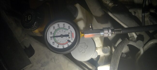

I'm literally doing that right now. And on cylinder:
1 - 150 psi no oil
150 psi w/oil in the cylinder
2 - 155 psi no oil
3 - 165 psi no oil
5 - 185 psi no oil
Battery at 12.50v
Injector harness read
Cyl.1
White- 12.25v
Black- 12.25v
Green- .06 cranking max
Cyl.3
Green signal- .12 cranking
Oct 26, 2024 at 1:36 PM
  • 55,845 POSTS
Nice work, the compression looks okay. I don't see cylinder 6 though. Is the injector on #1 getting signal? It sounds like the #1 fuel injector is bad; I would replace it but first we can run this test:

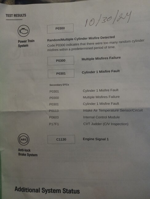

So I finally got the new boot put on and well nothing absolutely nothing has changed. I tried spraying carb cleaner around vacuum lines and what places I could reach with no change in idle. I have noticed when driving at a slow speed when just barley using the weight of my foot to accelerate the throttle still misses but then seems to 'clean up' and all of a sudden goes for a little but as soon as it shifts it starts again and the engine light flashes until I let off and stop (idle). Almost like a carburetor would do if timing was not quite right would. CPS comes to mind, but wouldn't that be a code as well? And where even is that on this motor? Timing side or back of the block? Is there a way to test it with a multimeter?
Nov 1, 2024 at 3:07 PM
  • 55,845 POSTS
Even though you cleaned the MAF sensor I would replace it. When the MAF is too dirty and you try to clean it sometimes it does not work.

If memory serves me right that may have been one of the original codes along with the p0300, 301. Is there a test for the wiring with actual acceptable range on this car?

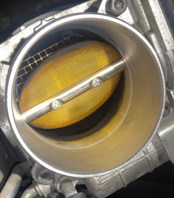

Limp mode sounds actually perfectly accurate. Now for TB cleaning can I unhook the MAF to take the intake apart while battery is still connected without starting the engine or any sensor for that matter? As far as opening the butterfly would I be able to put the ignition to the on position? (Push button on twice no brake pedal) and put the car in drive and would the TB actuator open for me to clean it?

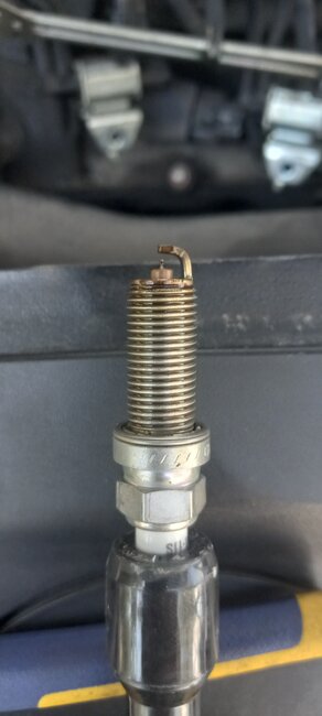

Oh yes, the wrong spark plugs, or the gap is not set correctly it will cause this problem, I would start there and check the mechanic's work. Here is a guide to help you service the throttle body:
Recommended Spark Plugs
Type: NGK DILKAR6A-11 or equivalent Iridium spark plugs are commonly recommended for the 3.5L V6 engine in the QX60.
Spark Plug Gap
Gap: 0.044 inches (1.1 mm)
Please go over this guide and get back to us.
Nov 12, 2024 at 3:44 AM

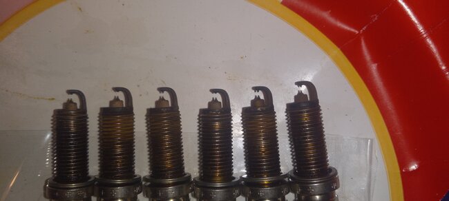

OCTANE1Z
  • 40 POSTS
Okay, so the MAF can be unplugged in order to remove intake tube and box, but the throttle body harness cannot?

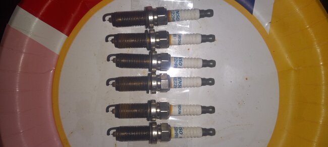

The plugs removed were
Denso p/n- FXE22HR11
what the guy put in were
NGK p/n- LKAR7BIX-11S
I know iridium tipped are pre gapped and I don't have my feeler gauges to even remotely check but are the replacements even in the correct heat range is a question? I'm buying a scanner tool hopefully tomorrow to gather more data. Fuel trims ect.
Nov 12, 2024 at 5:16 AM

I was able to get the tb to open using the car with ignition on and in gear and throttle pinned down with a jack handle and snap a picture. Is that all the wider it opens? It also looks pretty bad in there.
