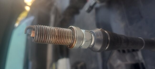

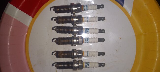

Was the #1-cylinder spark plug black or wet? If so, you have a stuck fuel injector. I would do a compression test on that cylinder as well. Here is how to test the fuel injector:

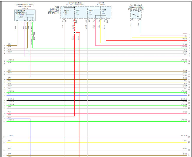

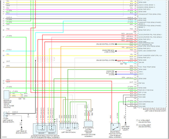

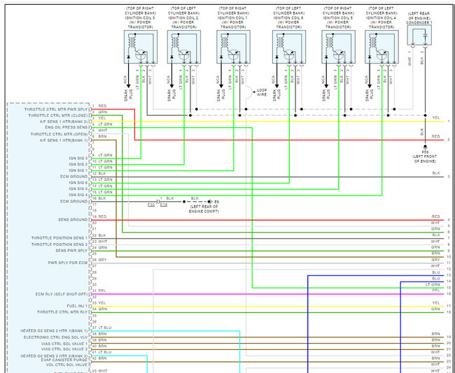

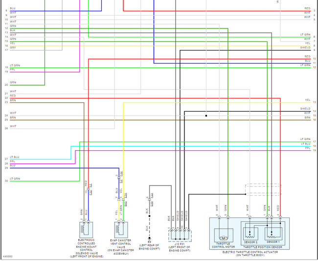

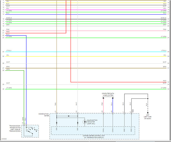

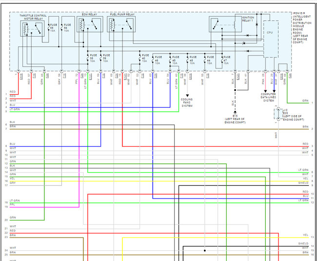

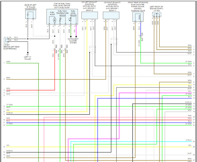

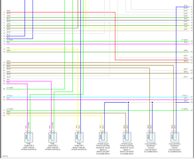

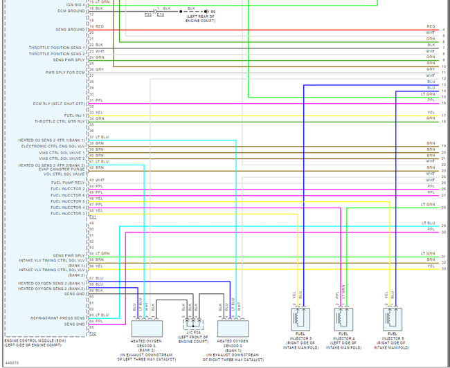

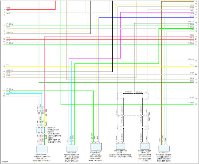

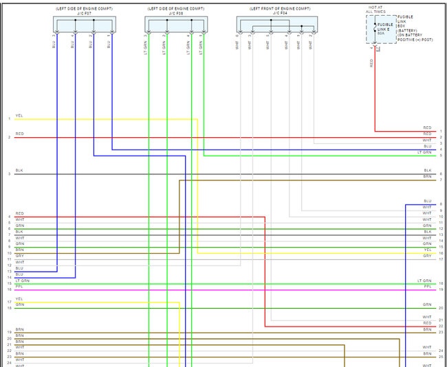

Here are the engine wiring diagrams which show the fuel injectors and ignition coils, let me know what you find. Also, please go over this guide:
https://www.2carpros.com/articles/automotive-engine-misfire-code-p0300-causes-and-solutions

I am not sure which plug is which cylinder as my wife hired a mobile mechanic for the plugs and coil and it didn't help. The problem started immediately after we stopped and filled up her tank on a Sunday evening. I have hooked the 'bad/old coil up and the 'worst' looking plug up to bank 2 and the coil makes spark and the plug sparks still. So those weren't the issue. The PCV hose collapsed and the nipple part has oil on it as well. I'll post the plugs as she was handed by the mobile tech.
Oct 17, 2024 at 5:01 PM
  • 55,421 POSTS
The spark plugs look okay, I think we should do a compression test on cylinder #1.

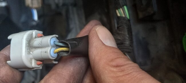

I can upload that as soon as I get it put back together. I ohm tested the 1,2,3 cylinder injectors and they read 1-14.5
2-14.8
3-15.2

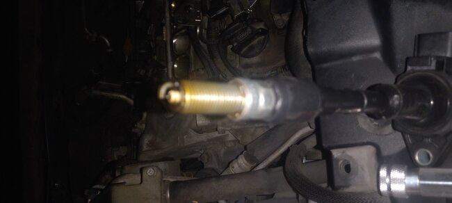

Spark plug from cylinder 1 was wet and now I'm trying to figure out wiring
and how to ohm test the old and new coils before I put it back together. White- power
Black - ground
Green- signal??

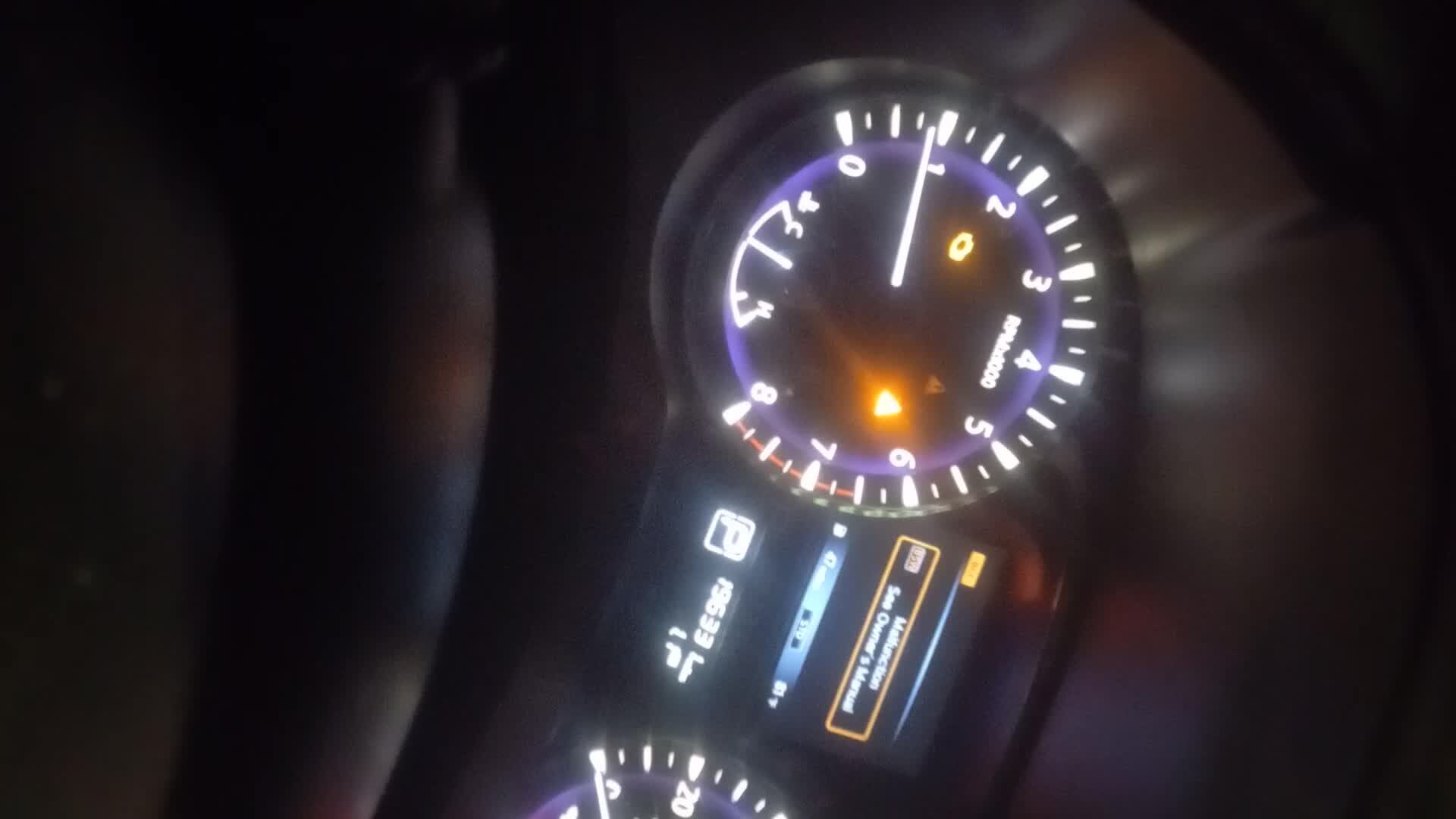

OCTANE1Z
  • 40 POSTS

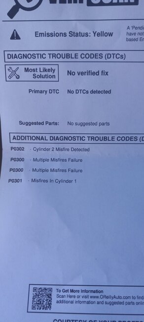

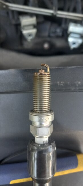

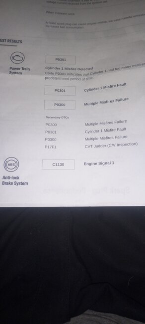

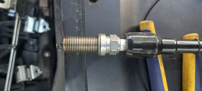

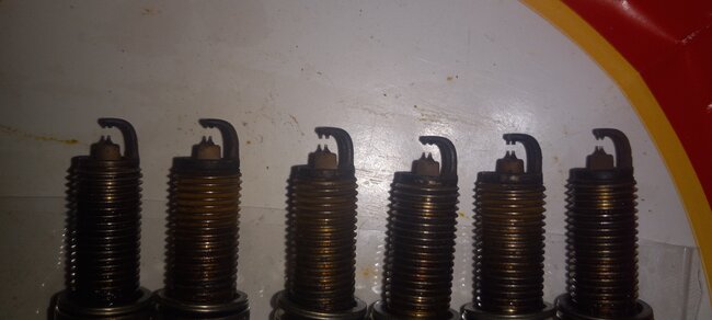

Here's the plug NGK Iridium LKAR-7BIX-115 that the mobile mechanic put in and today's scan after swapping coils with #2.

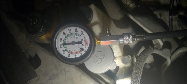

I'm literally doing that right now. And on cylinder:
1 - 150 psi no oil
150 psi w/oil in the cylinder
2 - 155 psi no oil
3 - 165 psi no oil
5 - 185 psi no oil
Battery at 12.50v
Injector harness read
Cyl.1
White- 12.25v
Black- 12.25v
Green- .06 cranking max
Cyl.3
Green signal- .12 cranking
Oct 26, 2024 at 1:36 PM
  • 55,421 POSTS

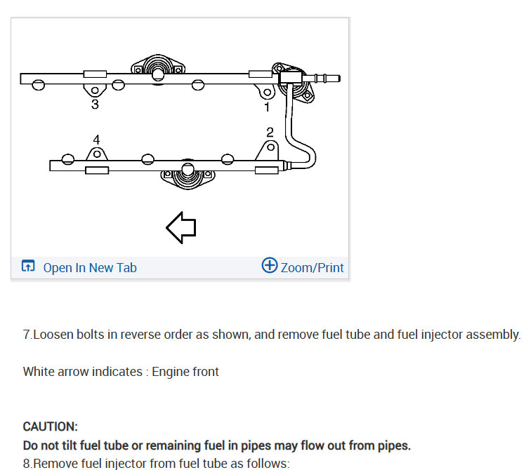

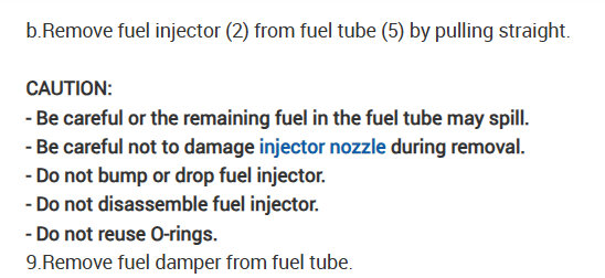

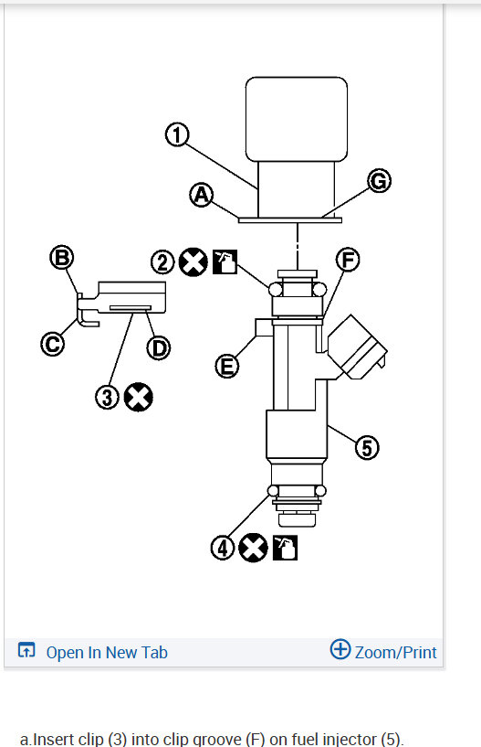

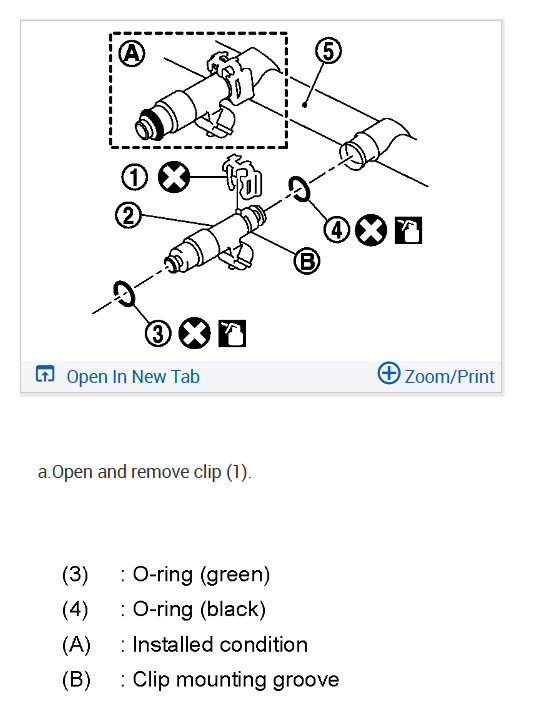

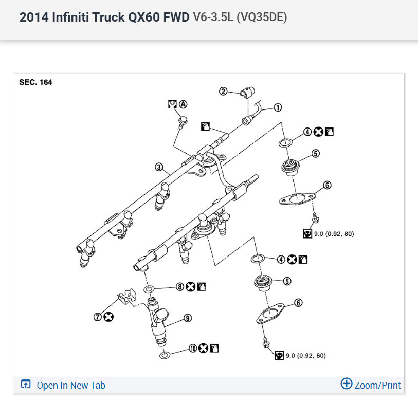

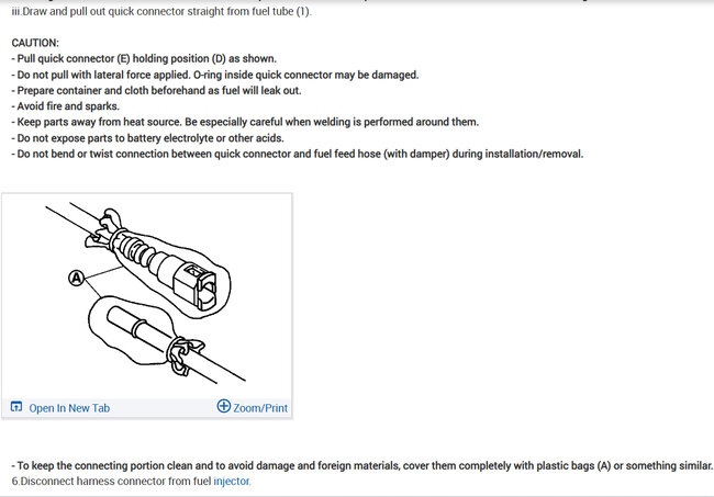

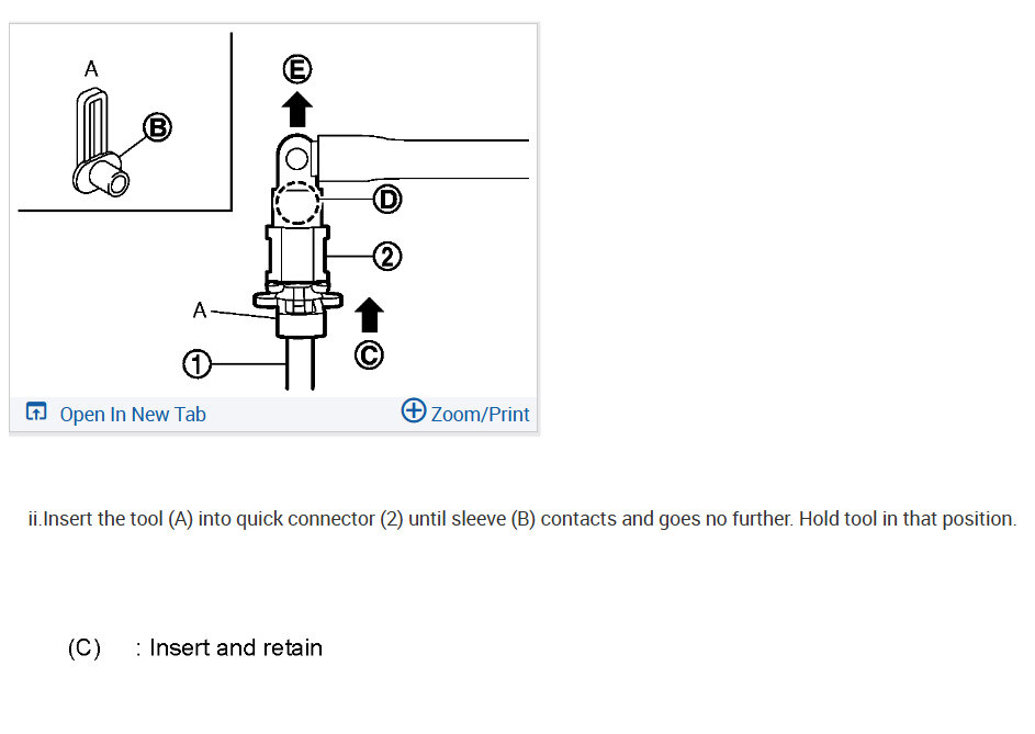

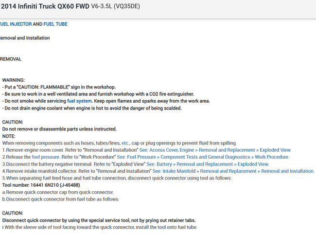

Nice work, the compression looks okay. I don't see cylinder 6 though. Is the injector on #1 getting signal? It sounds like the #1 fuel injector is bad; I would replace it but first we can run this test:
https://www.2carpros.com/articles/how-to-test-a-fuel-injector
Here is how to replace the fuel injector. Check out the images (below). Please let us know what happens.

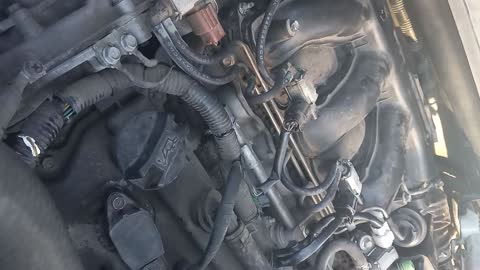

I still need to test #4 and #6 compression. That was today's plans, but the day got away from me. I have used a stethoscope, and the injector clicks while running and I ohm tested the first 3 cylinders a they read.
I meant to say 'coil harness' read the next.
1 - 14.5
2 - 14.8
3 - 15.2
Weathers dependent, I will comp test the last 2 cylinder tomorrow and get that Info to you.
What are your thoughts on maybe the spark is weak? Does that happen a lot ? I also have a new intake boot on order because hers was rotted/torn.
Oct 27, 2024 at 2:57 PM
  • 55,421 POSTS
These reading look okay, if the intake boot is torn it will not allow the MAF to give a reading to the PCM which will then shut down the injectors fyi so that might be the problem.

You should be okay, don't move the butterfly just clean around it, you can unbolt it and leave the wiring connected, please go over this guide to show you also, the compression seems okay so that is good.

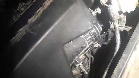

Exactly how I ran the comp test aside from warm. In order to get to bank one cylinders the plenum has to be removed. Fingers crossed the boot shows up tomorrow and I will clean the throttle body gently tomorrow. Here's today's code printout. Fault means it is not working at all, correct? Happy Halloween!!

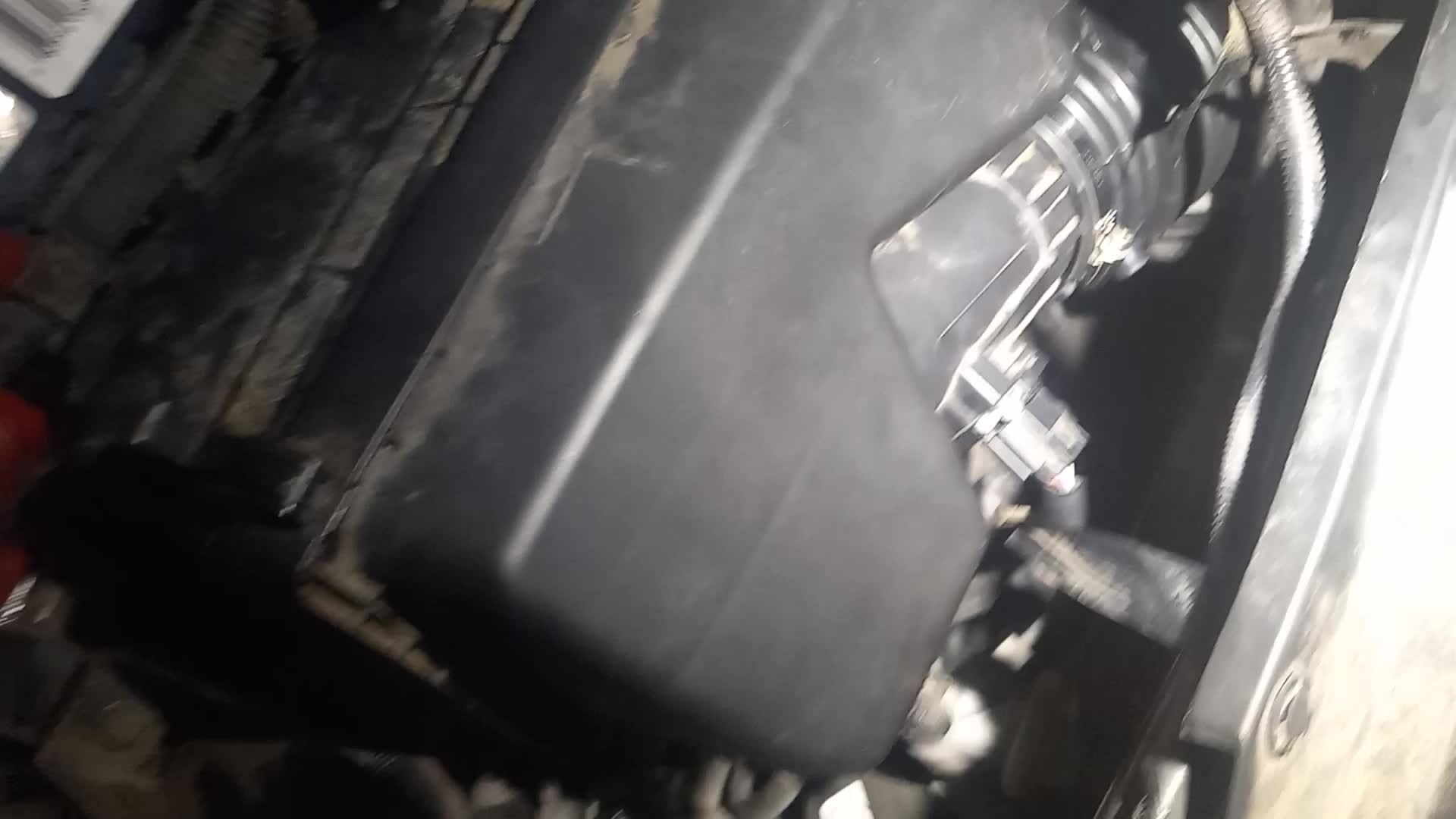

Nov 1, 2024 at 3:55 AM

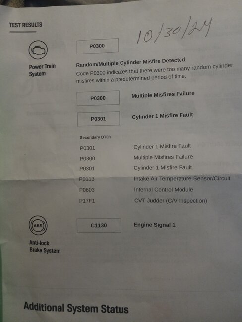

OCTANE1Z
  • 40 POSTS
So I finally got the new boot put on and well nothing absolutely nothing has changed. I tried spraying carb cleaner around vacuum lines and what places I could reach with no change in idle. I have noticed when driving at a slow speed when just barley using the weight of my foot to accelerate the throttle still misses but then seems to 'clean up' and all of a sudden goes for a little but as soon as it shifts it starts again and the engine light flashes until I let off and stop (idle). Almost like a carburetor would do if timing was not quite right would. CPS comes to mind, but wouldn't that be a code as well? And where even is that on this motor? Timing side or back of the block? Is there a way to test it with a multimeter?

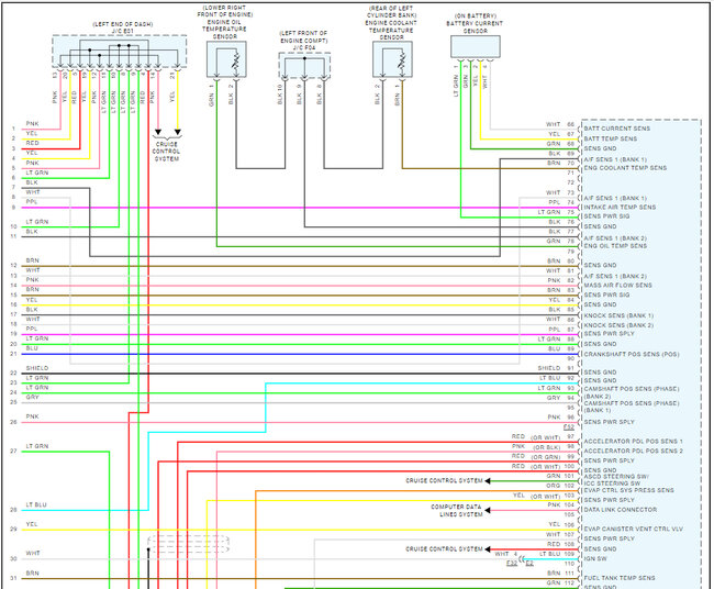

If memory serves me right that may have been one of the original codes along with the p0300, 301. Is there a test for the wiring with actual acceptable range on this car?

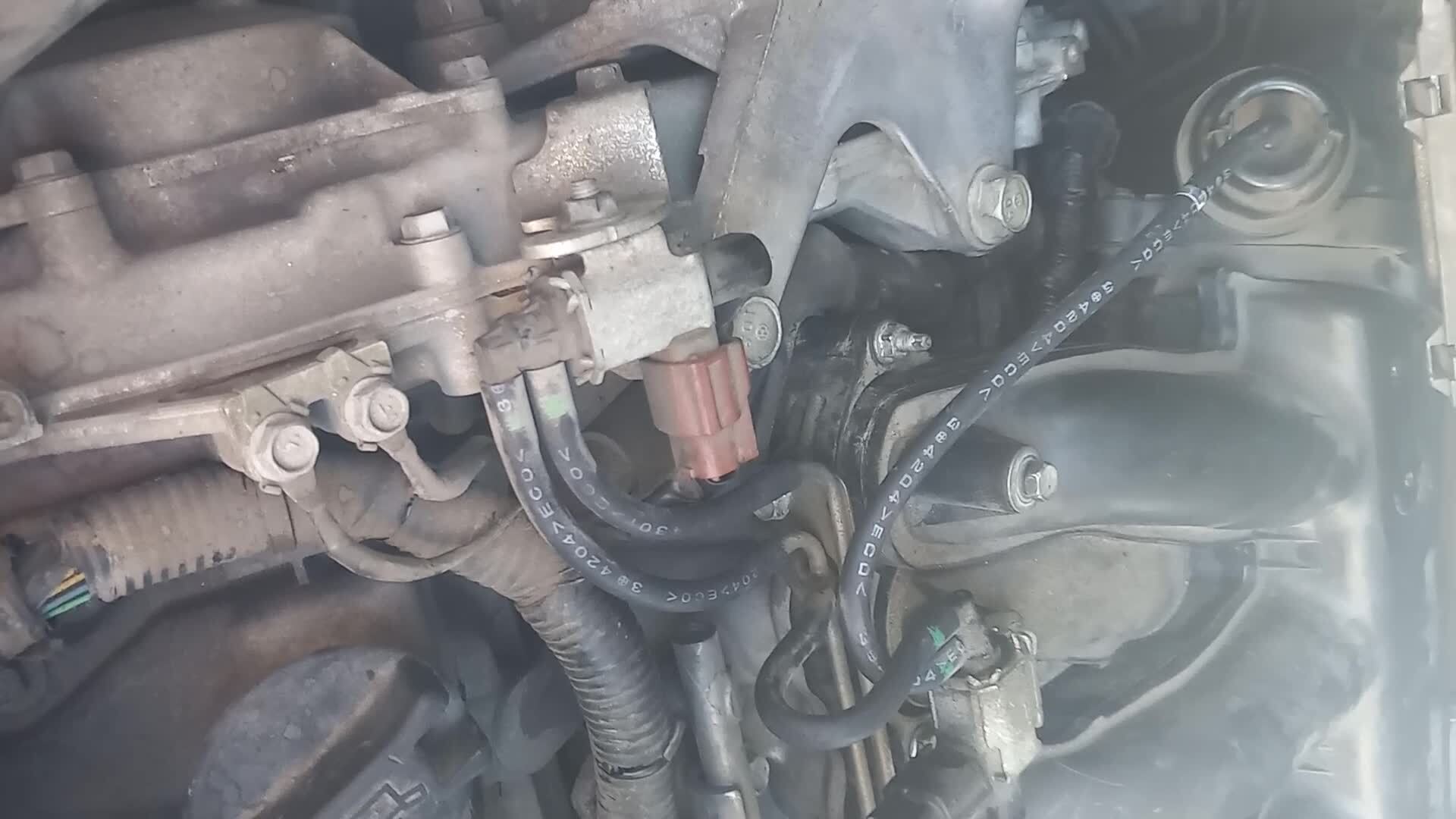

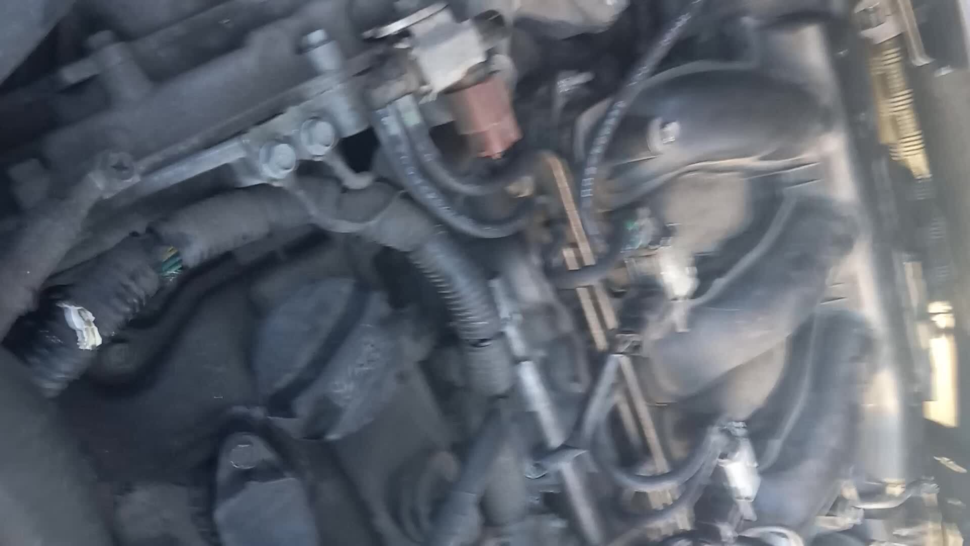

OCTANE1Z
  • 40 POSTS
So I went over the engine bays vacuum lines and found 3 small lines that were dry-rotting and breaking down and starting crumble in my hand and replaced. I also used most of a can spraying all gaskets that I could get to without any successful change in idle.

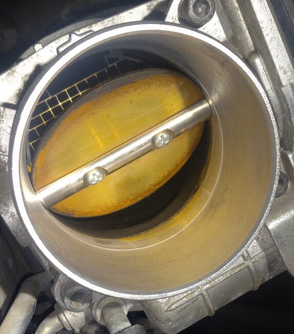

OCTANE1Z
  • 40 POSTS
Limp mode sounds actually perfectly accurate. Now for TB cleaning can I unhook the MAF to take the intake apart while battery is still connected without starting the engine or any sensor for that matter? As far as opening the butterfly would I be able to put the ignition to the on position? (Push button on twice no brake pedal) and put the car in drive and would the TB actuator open for me to clean it?

Oh yes, the wrong spark plugs, or the gap is not set correctly it will cause this problem, I would start there and check the mechanic's work. Here is a guide to help you service the throttle body:
Recommended Spark Plugs
Type: NGK DILKAR6A-11 or equivalent Iridium spark plugs are commonly recommended for the 3.5L V6 engine in the QX60.
Spark Plug Gap
Gap: 0.044 inches (1.1 mm)
Please go over this guide and get back to us.
Nov 12, 2024 at 3:44 AM
OCTANE1Z
  • 40 POSTS
Okay, so the MAF can be unplugged in order to remove intake tube and box, but the throttle body harness cannot?

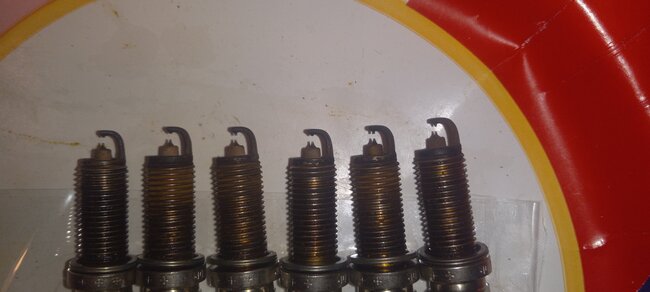

The plugs removed were
Denso p/n- FXE22HR11
what the guy put in were
NGK p/n- LKAR7BIX-11S
I know iridium tipped are pre gapped and I don't have my feeler gauges to even remotely check but are the replacements even in the correct heat range is a question? I'm buying a scanner tool hopefully tomorrow to gather more data. Fuel trims ect.
Nov 12, 2024 at 5:16 AM
OCTANE1Z
  • 40 POSTS

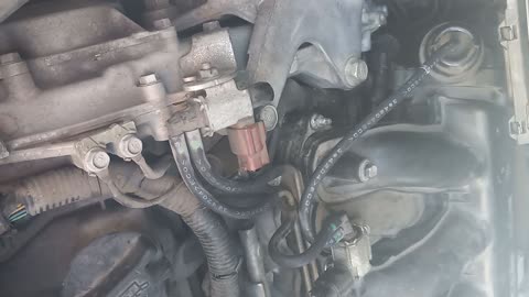

I was able to get the tb to open using the car with ignition on and in gear and throttle pinned down with a jack handle and snap a picture. Is that all the wider it opens? It also looks pretty bad in there.
