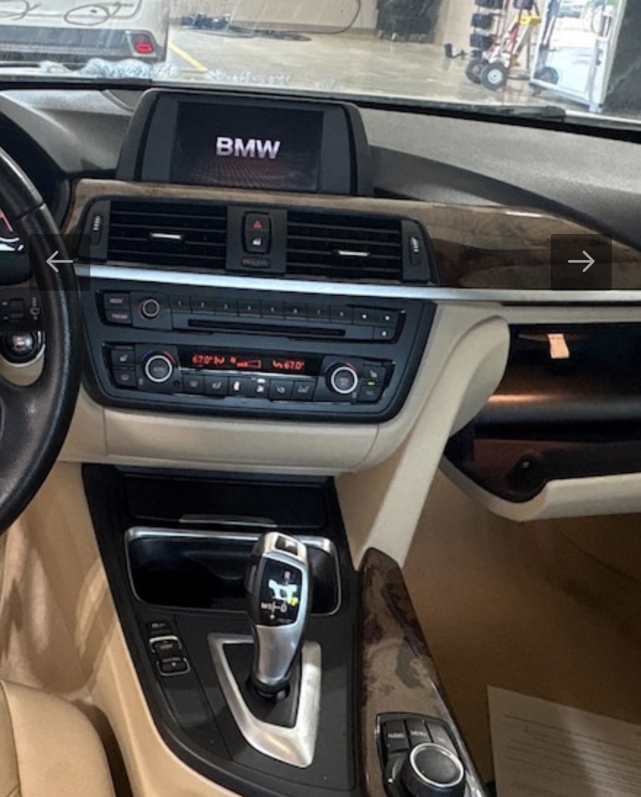

Infotainment screen stuck on bmw logo?
2013 BMW 328
210,000 MILES • TURBO • AUTOMATIC
BHAMDOC1
  • 364 POSTS

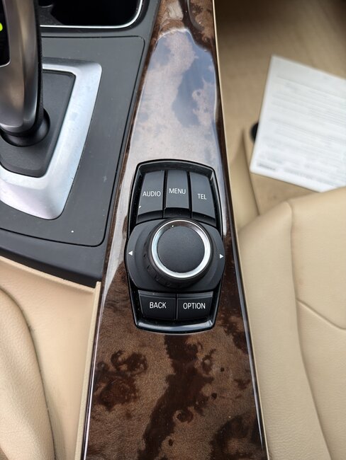

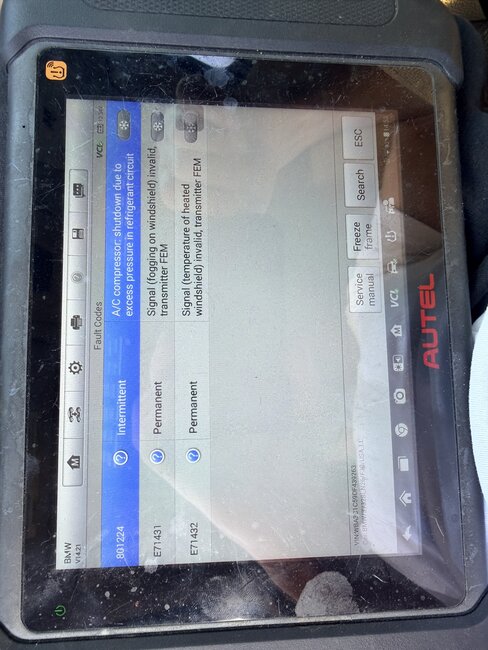

Disconnected the battery and back same result. Held the power and eject button notjing changed. Am not sure if it's an issue with the idrive wheel or the radio unit. These only codes that may be related i found

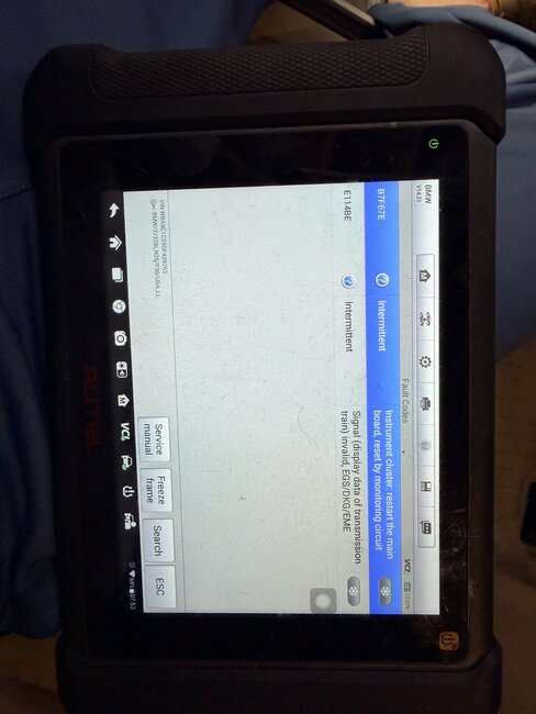

Hello. whats the engine size and model (ie, Convertible, Coupe, Sedan? They have different diagrams for the network depending on this. Ill look up the codes some more, but the Flexray is the newer very high speed Canbus. Did you happen to pick up an oscilloscope yet?
Jul 4, 2026 at 12:12 PM
BHAMDOC1
  • 364 POSTS
328i sedan 2.0l. No oscilloscopy no
Jul 4, 2026 at 12:20 PM
AL514
  • 5,668 POSTS
ok let me do a little research on these codes, at first glance this looks like a communication issue, even though we arent getting any U codes. But give me a few minutes to see what the code setting criteria is for these codes.
Jul 4, 2026 at 12:31 PM
AL514
  • 5,668 POSTS
that last one reads E114BE correct? its a bit blury

E114EB

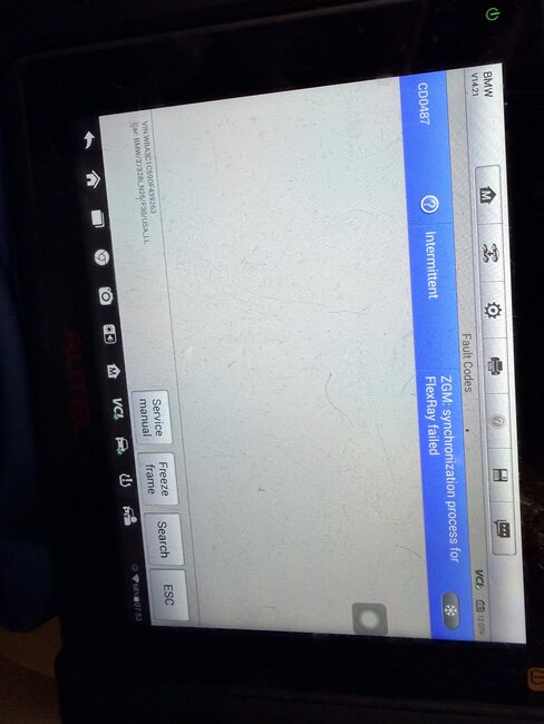

Ok so the ZGM is the Central Gateway, Im sure you are aware of the newer vehicles and the Gateway module that can limit communications with other modules unless you have a registered scan tool in many cases. The ZGM does communicate with many other modules on the FlexRay network. They are still a 2 wire twisted pair like Canbus, just much faster speeds.
The last code (E114BE) is also showing a signal issue with the EME(Electrical Machine Electronics), and the other modules I am still trying to ID (EGS and DKG), but overall this looks like a network/module issue. Being that they are all setting Intermittent, and no hard faults yet. Ill post what I have so far, but in the wiring diagrams I am currently looking at, it shows the Electrical Machine Electronics module under the Left Front of the vehicle, so start looking for water intrusion into connectors or corroded grounds.
Look for any wet spots under carpets as well. I will keep looking into these codes.
Here is some info on the network, along with the FlexRay topology showing the modules on the network.
On a 2013 water intrusion and corrosion are the first things I would be looking for. Especially if this has one of those DME covers in the engine compartment that never get put back on correctly.

so by the picture you posted of the shifter options, this is the xDrive model? AWD? There are quite a few differences between the two

NO THIS IS A 2WD. I WILL CHECK FOR ANY CODES

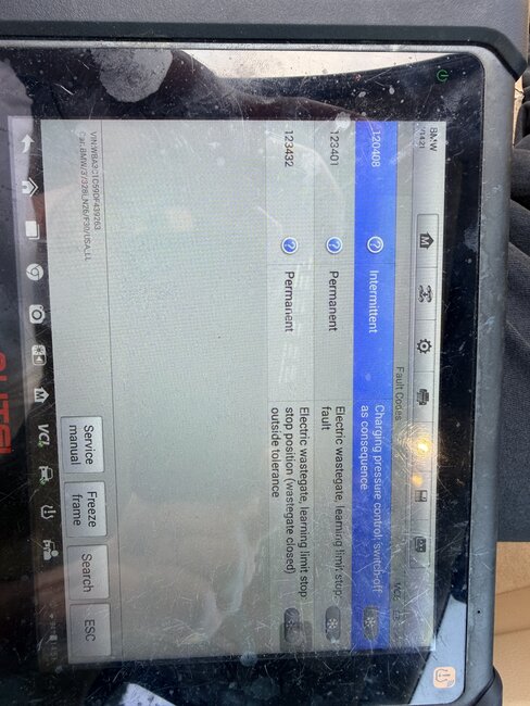

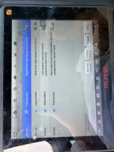

Did an all scan and got these
I deleted all and without starting the car got these codes under dme
123401
123432 both for turbo. Then this maybe an electrical fault not mechanical

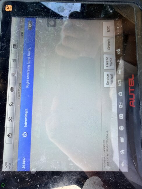

Under CAS:
804193 for a lamp
804483 for rain sensor
Jul 4, 2026 at 3:56 PM

so with some searching and trying to understand how this system works, it looks like the Cluster and the Gateway are responsible for the display you are seeing reading BMW, due to what seems to be either part of the cluster or part of the Gateway are crashing at start up, because you need the cluster to send the data you would normally read on the display.
But now with a whole bunch of new codes that werent there before. Erase them, do an idle relearn and/or crank learn procedure and see how it goes. Obviously someone cleared alot of codes before you got to it. Sad. This many codes, that are so random is probably going to be so kind of low voltage/ground issue that is effecting a certain leg of one or maybe more networks.Im jumping ahead tho,
This car has a lot of modules, so clear the codes, check the charging system with some electrical loads and make sure its reading good. Voltage drop the positive and negative side of from the battery to alternator B+ and case,
(below) This is just an idea of how many modules are in this car, but we have some direction. We know the cluster and gateway need to agree to display any data. Lets clear the codes and if you are comfortable we can check some pins on the back of the display and cluster if its easy enough. Start with the live scan data first, go into the cluster and gateway modules. Look for any live data thats out of place.

these are your latest codes, excuse the mess
Jul 4, 2026 at 8:12 PM
AL514
  • 5,668 POSTS
I will take a look real quick at the rain sensor and see if it has shared circuits. I just dont trust aftermarket wiring diagrams when it comes to these makes. Anything else at all on the Cluster that doesnt work, or looks out of place, ie a full/empty fuel tank, temp gauge, anything you might notice.

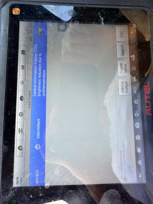

I hoping those last codes didnt come back, and that was some odd low voltage issue. I see interior lamps, info display due to over temperature, etc. the Perm codes look to be the turbo but still electrical too.
