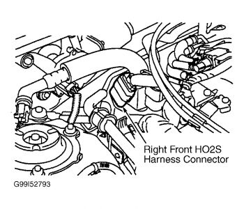

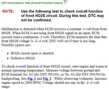

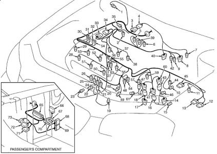

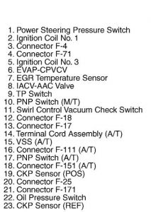

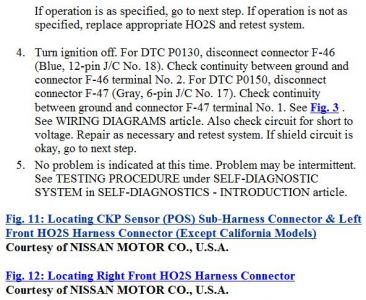

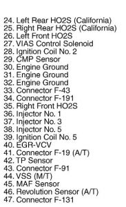

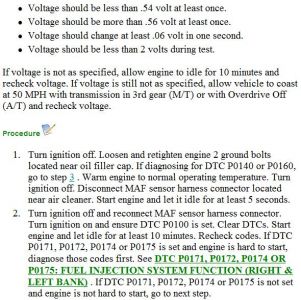

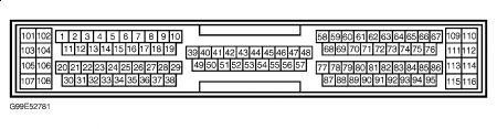

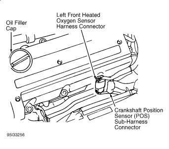

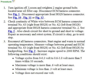

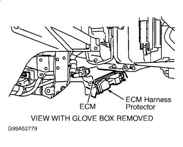

P0130 Front Right Heated O2 Sensor (Circuit)
https://images.2carpros.com/forum/automotive_pictures/55316_00i301301_1.jpg
https://images.2carpros.com/forum/automotive_pictures/55316_00i30p0130fig1_1.jpg
https://images.2carpros.com/forum/automotive_pictures/55316_00i30p0130fig2_1.jpg
https://images.2carpros.com/forum/automotive_pictures/55316_00i301302_1.jpg
https://images.2carpros.com/forum/automotive_pictures/55316_00i30p0130fig11_1.jpg
https://images.2carpros.com/forum/automotive_pictures/55316_00i30p0130fig12_1.jpg
https://images.2carpros.com/forum/automotive_pictures/55316_00i301303_1.jpg
I will post the diagnostic for P0140 momentarily.

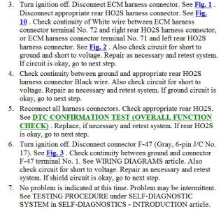

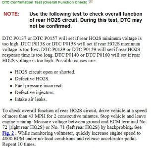

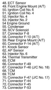

P0140 Rear Heated O2 Sensor Voltage Too High
https://images.2carpros.com/forum/automotive_pictures/55316_00i301401_1.jpg
https://images.2carpros.com/forum/automotive_pictures/55316_00i30p0130fig2_2.jpg
https://images.2carpros.com/forum/automotive_pictures/55316_00i301402_1.jpg
https://images.2carpros.com/forum/automotive_pictures/55316_00i301403_1.jpg
https://images.2carpros.com/forum/automotive_pictures/55316_00i30p0130fig3_1_1.jpg
https://images.2carpros.com/forum/automotive_pictures/55316_00i30p0130fig3_2_1.jpg
https://images.2carpros.com/forum/automotive_pictures/55316_00i30p0130fig3_3_1.jpg
https://images.2carpros.com/forum/automotive_pictures/55316_00i30p0130fig3_4_1.jpg
To answer your questions: Cranking the starter about a dozen times (say 30 to 60 seconds at a time, continuously) may have caused permanent damage to the starter. I am not sure why they decided to replace the throttle position sensor. Please post what other sensors being replaced. Also post what other codes they received to warrant the sensor replacements. Based on the codes that you told me, your cats were not the problem. Both have something to do with the O2 sensor heater circuitry (P0130 is for Bank 1 Sensor 1 and P0140 is for Bank 1 Sensor 2 - the one that they just replaced). If you can't perform the diagnostic yourself, you need to print and give them the instructions. Hopefully they will follow the instructions to solve the issues.
