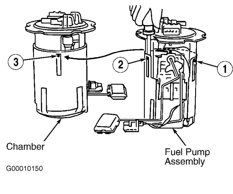

can here fuel pump,but no fuel coming to engine,,do i have to drop fuel tank to get to pump?

I can't find any info on it but I would look under the back seat and in the truck for a removable cover.

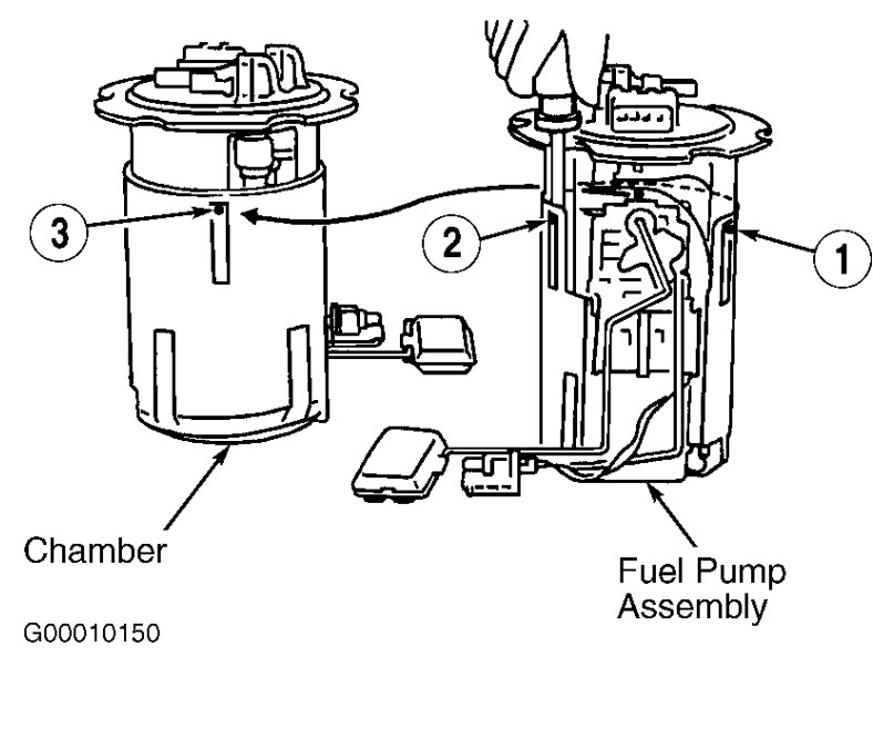

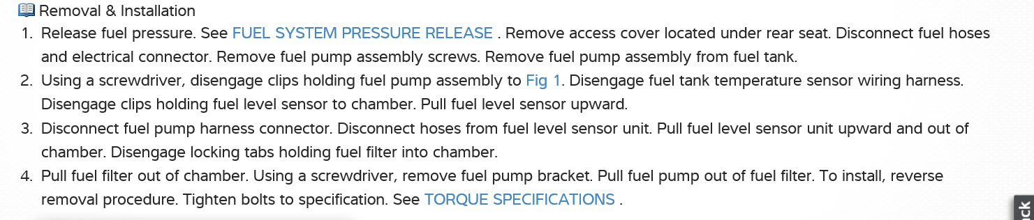

No there is an access cover under rear seat. see pic for instructions.

Thanks HMAC300, Alldata didn't have anything.

thanks, went ahead and pulled rear seat,,yes thier is a access plate,,,not fuel pump its good,,,fuse good but no is no voltage at plug to fuel pump
